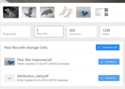

Step 2: Download the STL File
Click on the “thing files” tab located below the creation example pictures. Download the file that ends with .stl and download into a known folder.

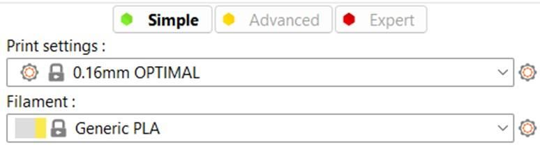

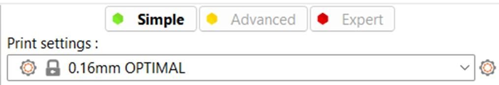

Step 4: Set Print Setting to 0.16 Optimal
Set the "print settings" located on the right side of Prusa window to 0.16mm Optimal. This setting will tell the printer how much filament is going to get pushed out.
Step 5: Set Filament Setting to the Filament You Have
Set "filament" setting to the type of filament you have purchased. I will be using the most generic filament which is PLA.

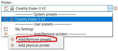

Step 6: Set "printer" Setting to Creality Ender-3 V2
Next set the printer to “Creality Ender-3 v2”. Start by clicking “Add/remove printers”, followed by “Add/Remove Presets” (figure 6.1).

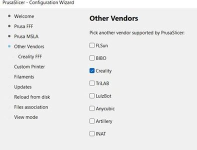

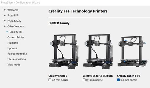

Click the other vendors tab and check “Creality” and click the Next > button on the bottom (figure 6.2).
Click on our printer “Creality Ender-3 V2” and click Finish on the bottom (figure 6.3).

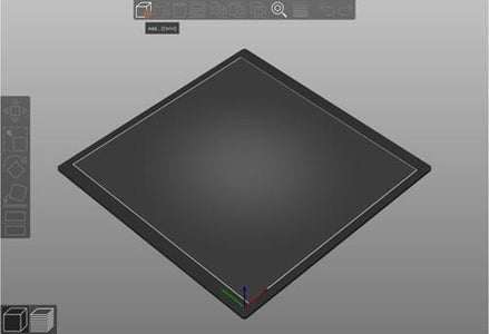

Step 7: Adding Our Stl File to Prusa Slicer Plater
Click the “add” button located on the bar above the work place.
Step 8: Find and Open STL File

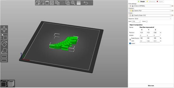

After clicking the add button, file explorer will pop up on screen. Find and open the STL file we downloaded from Thingverse. The model will be shown on the bedplate.
Step 9: Adjusting the Size of the Creation Using Scale Function
Using the "scale" button located to the left side of the screen, we can make the Creation smaller or bigger. Disclaimer the larger the model, the more time and filament it will take.
Step 10: Add Supports If Necessary
Set “Supports” setting located on the right side of the screen to "none". For the T-rex model print we will not be using supports. Disclaimer If your creation has overhanging sections, set supports to "everywhere". Supports are lightly printed scaffolding around a print model to help hold up overhanging/floating parts.
Step 11: Set Infill Setting to 20%
Set the infill setting to 20%. This is located below the supports setting. Disclaimer The higher the infill percentage, the more time and filament used. Infill is the percentage of the density or how hollow the print will be.
Step 12: Slice the Creation STL File Into G-code
Click “Slice now” button located in the bottom right corner of the screen. After the software slices the STL file, the window will provide printing information such as printing time, layers and parts.

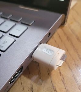

Step 13: Plug in Your Micro-sD Card Reader Into Your Computer
Plug in your micro-SD card reader into your computers USB port.

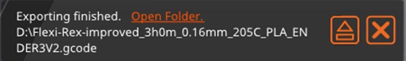

Step 14: Export G-code Into Micro-SD Card

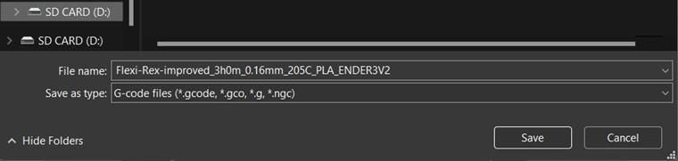

Click the "Export G-code" button located on the bottom right corner of the screen. This will make file explorer window pop up.
Step 15: Save and Download G-code Onto the Micro-SD Card
Find the location of your SD card on file explorer and click save.
Step 16: Eject Your Micro-sD Card
Press the “eject drive” button that will appear on the bottom of the Prusa Slicer window after the export finishes. Or you can eject the USB using file explorer. Warning removing the USB from computer without ejecting can corrupt or damage the SD card.

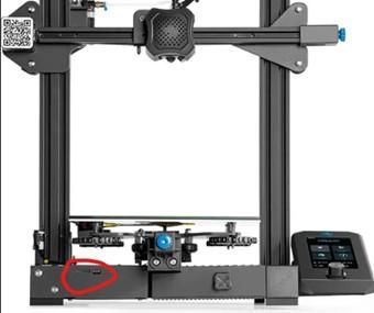

Step 18: Insert Micro-SD Card Into Ender-3 V2 SD Slot.
This micro-sd slot is located in the front left side of the printer. Disclaimer if the sd card does not slide in, make sure to flip the card and try the other side.
