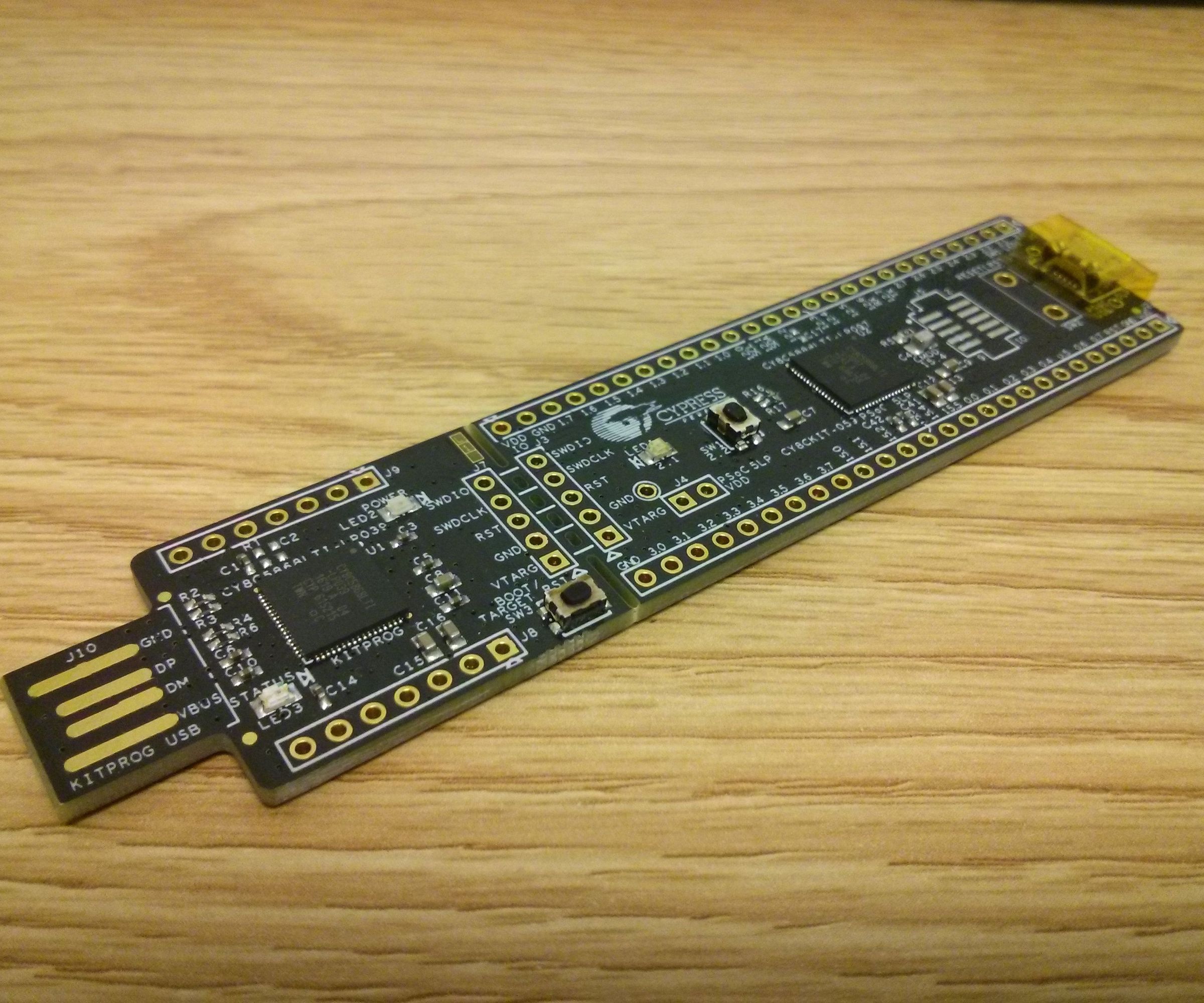

You will need a computer to run PSoC Creator 4.0 which can be downloaded from Cypress' website after creating an account here;
The package you will need to download is the CY8CKIT-049-42xx CD ISO (CD Creator) and this will install everything you need for this kit;
Cypress PS0C 4 Documentation and Downloads
The hardware for the kit is available through Digikey here;
Cypress PSoC 4 Evaluation Board
And it is also advisable to get a couple of these headers to solder to the board as these do no come with pre-soldered headers. This kind is a bit more pricey then others but gives you both male and female connectors for wires and its nice having a board setup like this for testing;
You will also need a common cathode RGB LED, two 1k ohm resistors, a 680 ohm resistor, a breadboard, and some hook up wire or DuPont cables (if you are unsure if you need male or female, you can often find them in packs that have male to male, male to female, and female to female all together), but I can't list sources for these as I frequently buy these materials from eBay, and listings come and go frequently, but there are many available and easily found searching eBay.
Beyond that, as long as your computer has a USB port, and you have a soldering iron and solder, you have all the materials required.
