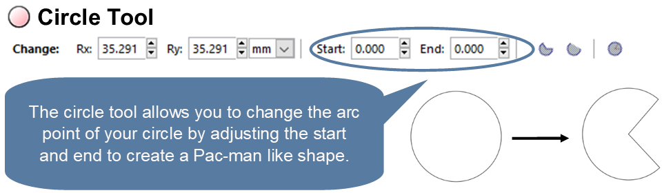

Now that you have practiced with the Rectangle tool let’s move to the Circle tool. Select the pink circle tool in the toolbar. Left click and drag on the canvas to make a circle. Press Control at the same time to get a perfect circle, then let go of the mouse button to complete it. Notice at the top of the page the tool options have changed. Each tool we select will give us different tool options. Select the circle you’ve made - you will know the shape is selected because it has dash lines around it, sometimes called marching ants. In the tool options, the Start and End controls will alter the angle of the circle's arc point. Try setting the Start control to 30 and the End control to negative 30. When you make another circle, it keeps the same arc length from your settings. To change this back to a complete shape go to the start and end control and enter 0.

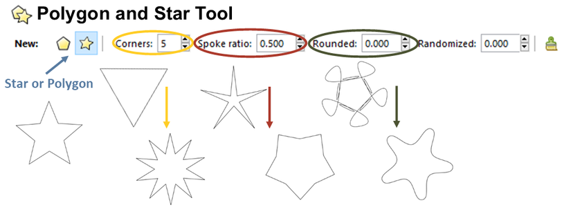

Next we have the Polygon and Star tool, which is beneath the Circle tool and has a yellow star and pentagon. Notice the tool options have changed again. To the far left of the tool options, you can choose to create a star or polygon. Leave it on the stars option for now and left click and drag on the canvas to make a star. This creates a common star with five points. But what if we wanted to add more points to our star? Luckily, Inkscape allows us to do this easily.
With your star selected (remember the dashed lines around it), go up to the tool options and where it says Corners, increase the corners to 10. You can also change the spoke ratio to have the star more concentrated to the center or the outside of the shape. Decrease the spoke ratio to around .300 (The square handle outside the star does this as well, similar to the square tool). If you want to make your corners rounded, use the Rounded tool option. Increase the value to around .100. You can really see how much these tool options can change your shape.
To further change your star, click the inside square handle and pull across to create your desired shape. The shape changes considerably by doing this. This is a fun tool to use and I encourage you to experiment with the tool options to create other stars and try them out with the polygon tool option.

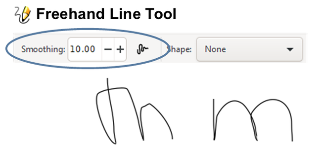

The last tool we will cover in this Instructable is the Freehand Line tool - which looks like a yellow pencil icon in the toolbar. Left click and drag your mouse, and make a letter M without releasing it. The green transparent line is what you are creating. Once you release the mouse, the line will show. You are probably noticing the line is not very smooth. To make the line smoother, look in the tool options and increase Smoothing to 10.00 and make another M. See how the curves are more rounded? This tool is great for freehand drawing and making paths.

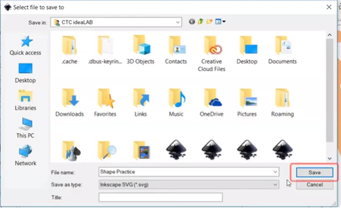

While creating your designs, it is good to save your work periodically. To save your project, go to File ➜ Save As another window will emerge - name your project here and choose where on your computer it will save to. Save your work as an svg file (there are other options if you need them under save as type). Svg stands for Scalable Vector Graphics and it is used to save two-dimensional graphics. Click Save in the bottom right corner to complete the process.
