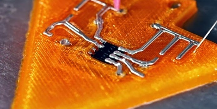

Step 7: Non-traditional PCBs
There's also some different and pretty cool types of PCBs.
Flexible: These boards can bend and twist. While not used very much, they can be useful when a device needs to be small and light, such as in wearables.
3d-printed (Voxel8): At least one company now is making a 3d printer that can integrate conductive traces with printed plastic layers. This way, electronics can be integrated with mechanical parts; all in three dimensions.
These technologies are not too popular at the moment, but could possibly be used more and more if price comes down. Make sure to keep an eye out for future flexible and 3d printed products!
