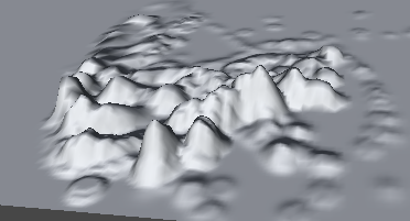

In the Menu Bar go to GameObject > Create Other > Terrain
Select the terrain object by clicking on it in the Scene or in the object list in the Hierarchy window.
Click the Raise/Lower Terrain button in the inspector panel.
Left click and drag anywhere on the terrain in the Scene to raise the elevation.
Hold down shift to lower.
Experiment with different brush shapes and sizes.

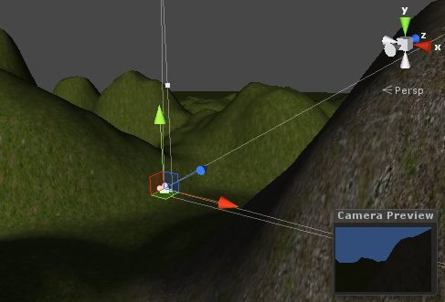

Move your Main Camera
Find your camera by double clicking the Main Camera object in the list of objects on the left side of the screen under Hierarchy.
Enable the movement tool by clicking on the 4-directional arrow in the upper left.
You can move objects by dragging the arrows of the tool.
Move your Main Camera object so that the Camera Preview shows something interesting.

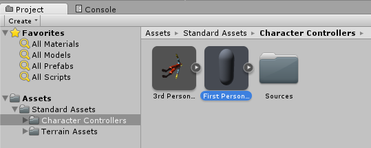

Step 5: Player
Locate the First Person Player Controller asset in the Project window.
Assets > Standard Assets > Character Controllers > First Person Controller
Rename it to Player by changing the name in the Inspector Window.
Note: if you do not press enter/return after renaming it, the name will not change.
Make sure the Player isn't intersecting terrain, otherwise you'll fall through.
Delete Main Camera by right clicking on it's name in the Hierarchy and pressing Delete.
Press play. You should be able to walk around now :)

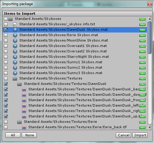

Assets > Import Package > Skyboxes
Check only the files relating to DawnDusk
Edit > Render Settings > Skybox Material
Drag and drop the prefabs of the models into your scene.

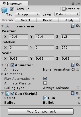

Drag in DartGun Prefab from Compressed Gas Pistol > Prefab > DartGun to the scene.
A prefab is like a Class but in 'object' form. It's the copy with good defaults that you can use for all your different levels.
Put DartGun in Player > Main Camera
Position/Rotate DartGun (Player > Main Camera > DartGun) according to the values below:
Position/Rotate inner DartGun (Player > Main Camera > DartGun > DartGun) according to the values below:

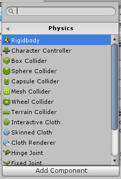

Create Sphere by going to GameObject > Create Other > Sphere
Rename the object to Bullet
Add a new RigidBody to the Bullet object.
Click Add Component > Physics > RigidBody
Uncheck Use Gravity
Set Collision Detection to Continuous
Set the scale of the sphere's transform to 0.2, 0.2, 0.2

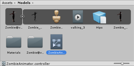

You will need to download the following Zombie:
http://www.mixamo.com/editor/new/86
Press yes to viewing the animation.
Click Download
Click Sign Up
Create Account
Click Download again
Click Checkout
Select FBX for Unity for Download Format
Click Download
Create Models Folder in the Projects window > Assets

Put a Character Controller on the Zombie Object
In the inspector set the Center Y to 1
Add a Capsule Collider component
Add Component > Physics > Capsule Collider
** Make sure to copy the exact values over.

Step 10: Animation
Locate the Zombie@walking_3 asset in the Models folder.
The same way you made a script, this time, make an Animator Controller
Now in the Project Window, locate the Zombie@walking_3 asset again.
Open up the asset by clicking the arrow next to it.
Connect the Any State to the walking_3 state by right clicking on Any State > Make Transition and then click on walking_3.
First, let's make sure that the walking 3 loops correctly by editing the Transition arrow (click on the Transition arrow).
Set the speed to around 3.4.
Now in your scene, go to the Zombie and drag the animator controller on to the animator object.
Uncheck Apply Root Motion and set the culling mode to Always Animate.
Test it out in the scene!
Name it Zombie Animator.Now double click on the Zombie Animator.Project Window > Right Click > Create > Animator Controller
Now drag and drop the walking_3 animation into the Animator Window.
Make sure the walking animation doesn't over lap and the arrows on the timeline are next to each other.
Next, let's make sure the animation isn't super duper slow by editing the walking_3 animation inside the Animator window.
Finally, go to Prefab > Apply and apply the settings to the prefab. Make sure that the Zombie prefab now also has an animator controller!
