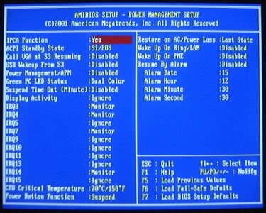

Step 1: Editing the Bios to Get It to Reboot on Power Fail.
I am not sure if my problem is with the power supply failing or with my video card or what it is. But I do know that the computer reboots every so often. So to make sure it reboots after a power fail (IE:the power supply browns out) I want to edit the bios.
Because of the fact that there are so many different bios makers out there, it would be too hard to list all the different ways to do this in all the different bios screens so I am just going to give you the basics and let you figure out the specifics on your own.
Basically to get into your bios you will need to press a button on boot. Usually it will say something like "hit Del to enter setup" or "F2". Different manufacturers give you different ways but it is usually either "F2" or "Del" key.
Either way watch for it and hit the key it tells you to hit. Now you will come to a screen that is usually either grey or blue, but again it depends on your bios make. You will be looking for a power settings option. It will either be on a window all its own like in the AMIBIOS screen shot (borrowed from toms hardware guide) or in some it may be in an advanced bios features window. Anyway you are looking for a "restore on ac/power loss" setting. It may be named something else but it will be close to that. Just look for it. It will usually have three options (last state, on after power loss, off after power loss). You want to set it to on after power loss. Make sure you save your settings and exit the bios.
Now when your power fails or you unplug your machine it will reboot as soon as it gets power back.

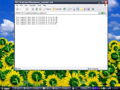

B.) As soon as it reboots we want to write to a file the exact date and time it rebooted.
C.) We want to be able to amend that file. If it reboots more than once we would never know.
D.) We want it to have error correction so it wont screw up and we make sure we get all of our reboots without missing any because of bad coding.

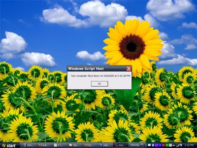

E.) We want it to pop up a message saying it rebooted.
F.) We want it to open the file we wrote to so we can see a list of all reboots when we click ok on the message pop up.

Now technically all we have to do is type the following code and we are done
'set the file for appending
Set objTextFile = objFiSyOb.OpenTextFile (strDir & strFile, ForAppending, True)
'write the new line to the file
objTextFile.WriteLine("Your computer Shut down on " & date & " at " & time)
'close the file
objTextFile.Close
'make a pop up
Wscript.Echo ("Your computer Shut down on " & date & " at " & time)
'open the file in IE
Set objShell = CreateObject("WScript.Shell")
objShell.run ("Explorer" &" " & strDir & "\shutdown_catcher.txt" )

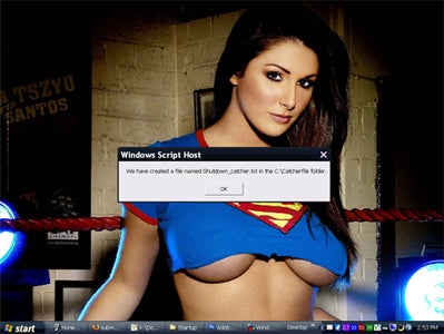

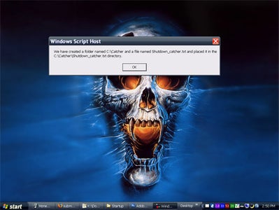

To make a pop up we just type
Wscript.Echo ("whatever we want to say in the message ")
to add a variables value into it we put it outside or in between double quotes using the ampersand (&)sign as a delimiter so the script knows it is a variable and not a text.
like this:
Wscript.Echo ("Blah blah blah " & strDir & " blah blah blah "& strFilename & " blah blah blah." )
The output would be a pop up that said
Blah blah blah C:\Catcher blah blah blah shutdown_catcher.txt blah blah blah.

'if the folder C;\exist
If objFiSyOb.FolderExists(strDir) Then
'get folder
Set objSysFold = objFiSyOb.GetFolder(strDir)
'otherwise
Else
'create the folder c;\catcher
Set objSysFold = objFiSyOb.CreateFolder(strDir)
'and check to see if the file and folder exists
If objFiSyOb.FileExists(strDir & strFile) Then
'if it does get folder c:\catcher
'otherwise
Else
'create text document shutdown_catcher.txt
Set objFile = objFiSyOb.CreateTextFile(strDir & strFile)
'then pop up a message to say you created them both
Wscript.Echo ("We have created a folder named " & strDir & " and a file named "& strFilename & " and placed it in the " & strDir & strFile & " directory." )
'end nested if statement
End If
'end original if statement
End If
'create a popup saying we created the text document
Wscript.Echo ("We have created a file named " & strFileName & " in the " & strDir & "file folder.")
End If
objTextFile.close
'now add in a popup to say you wrote to the file so the person knows it happened
'and they have to close it to open the file and view

When you execute the vbscript file it will now
A.) Check to see if the folder C:\Catcher exists and if not create it.
B:) Check to see if the file Shutdown_catcher.txt exists and if not create it.
C:) If it created either a folder or file or both it will pop up a message saying it did create them (Note: it should only do this on first run after that it should already be there unless deleted so you should only see that message once. It might be a good idea to run this script once under a controlled reboot so you can bypass these pop ups or you may not write anything to the file because it wont bypass the file created pop ups.)
D:) Write a line in the text document Shutdown_Catcher.txt saying that the computer shutdown on such and such a date at such and such a time.
E:) Pop up a message saying there was a reboot
F:) Open the file for viewing.
If you look in the next step you will see the code as written.
Now all I have to do is sit back and wait. Every time the computer reboots I will have a record of it. Then I can review the record and see if there is any consistency to it. Example might be that it reboots every half hour or it reboots any time there is a increment or 45 on the clock.

Set objFiSyOb = CreateObject("Scripting.FileSystemObject")
Else
Else
End If
End If
Else
End If
set objFile = nothing
set objSysFold = nothing
objTextFile.Close
If err.number = vbEmpty then
Else WScript.echo "VBScript Error: " & err.number
End If
WScript.Quit
