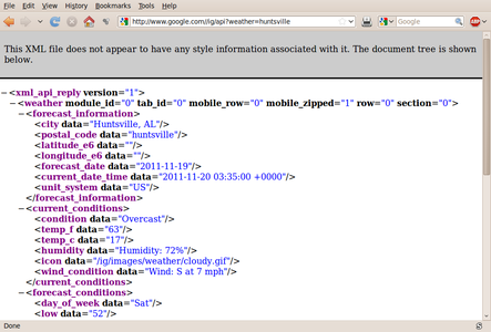

The xml (abridged) version (using http://www.google.com//ig/api?weather=huntsville) :
See picture.
So then it was a matter of just plugging in variables. Almost cut and paste. Anything in single quotes was extracted from the xml sort of. I also make it so that you did not have to redo the code of a different location. This also could be done in a gui environment, but for simplicities sake that part was not included.

Have been doing some page scraping, but i was not able to get the weather from their (Google) site. Then read they have it sort of hidden. Was able to get a page of the xml they use to show the data. Could not find an easy way to page scrape it. Aha. then found a short piece of code of how to use the Google api! We then modified that code for our needs.
See picture.
