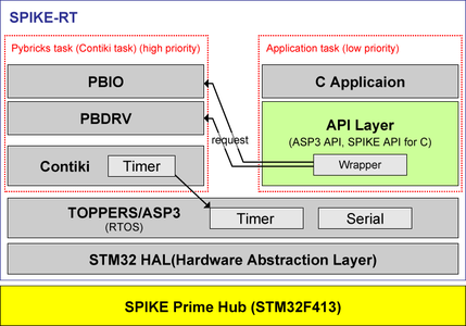

Unlike existing platforms that primarily use MicroPython, SPIKE-RT provides a real-time operating system (RTOS) environment based on TOPPERS/ASP3, allowing for real-time programming and efficient hardware control. This makes it a valuable option for developers who require high performance and precise control in their SPIKE Prime projects.
Step 2: What Is SPIKE-RT?
SPIKE-RT is a real-time operating system (RTOS) based software platform designed for LEGO SPIKE Prime, developed as the successor to EV3RT. It is built on TOPPERS/ASP3 RTOS, providing a C language programming environment under the MIT license. SPIKE-RT aims to enable real-time programming and enhance control applications' reliability and performance on LEGO SPIKE Prime.
Step 3: What Is TOPPERS/ASP3?
TOPPERS/ASP3 is an open-source RTOS targeting embedded systems that require high reliability, safety, and real-time performance. It extends the μITRON 4.0 specification and supports preemptive multitasking with priority-based scheduling. Its architecture is designed to maintain real-time properties while facilitating complex application development.

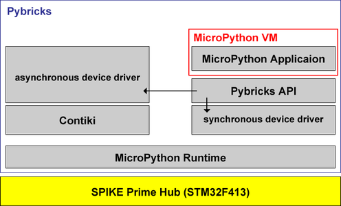

- LEGO Education SPIKE App: The official platform that provides a programming environment using MicroPython and Scratch. It appears to be based on a MicroPython runtime.
- Pybricks: An open-source platform for LEGO devices that supports programming using MicroPython.
Both are based on the MicroPython runtime. Compared to SPIKE-RT, the following issues can be considered:
- Limitations in Language Extensibility: Existing software assets written in C cannot be reused.
- Constraints in Real-Time Performance: Issues such as garbage collection can affect real-time behavior.
