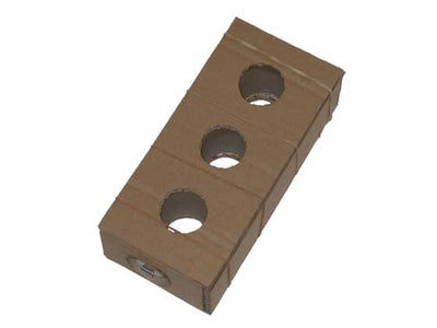

Introduction: Introducing the Fab-brick (a Sew Useful Contest Project)
A multipurpose, hand-sewn, upholstered brick form. Multiples can be configured and reconfigured to furnish the changing needs of day-to-day living. Like Lego but a domestic rather than a universal system.

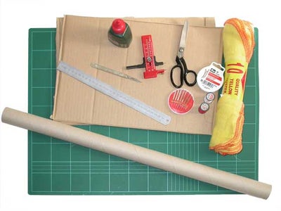

Step 1: Checklist
You will need:
Materials for one brick:
1.40mm (or thereabouts) diameter cardboard tube; a double-walled corrugated cardboard box with two side panels measuring at least 42cm x 29.7cm to make a robust, brick-shaped hollow cardboard form
2. wood glue
3. screw cap spout from a fruit juice carton
4. a pack of yellow dusters, or fabric of your choice
5. recycled textile to pad the hard cardboard form
6. thread
7. heat-fusible hemming web
8. Silver sand and/or sawdust to weight the brick
Tools:
1. scalpel or utility knife, scissors
2. steel edged ruler
3. circle cutter
4.cutting mat
5. pencil & disappearing fabric marker
6. various elastic bands to use as you see fit to hold the cardboard panels in position whilst the glue hardens

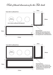

Though a HUGE fan of Claes Oldenburg's 'Soft Toilet' , I didn't want my fab-brick to turn out like the Muir Glacier (melted) so, I decided to build a thick-walled cardboard form that would be strong enough to be weighted and be able to withstand everyday wear-and-tear. I decided on building a reinforced, panelled construction in which the panels overlap and interlock, further strengthening the form.
Following the dimensioned drawing cut out the panels for the outer shell; then calculating the thickness / guage of the cardboard you are using, measure and cut the panels of the inner shell.

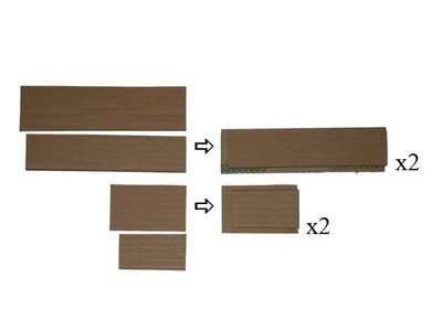

Step 3: Assembly of the Cardboard Form: Step 1
Assemble the side panels as per the photo: on the vertical axis align each inner panel and corresponding outer panel centrally; on the horizontal axis align a side edge of the panels together.

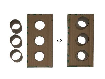

Step 5: Assembly of the Cardboard Form: Step3
Glue the three sections of cardboard tube in position as per photo.

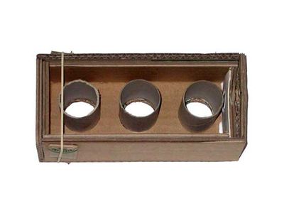

Step 6: Assembly of Cardboard Form: Step4
Glue the first two side panels to the base panel as per the photo. The panels interlock at the joint.
