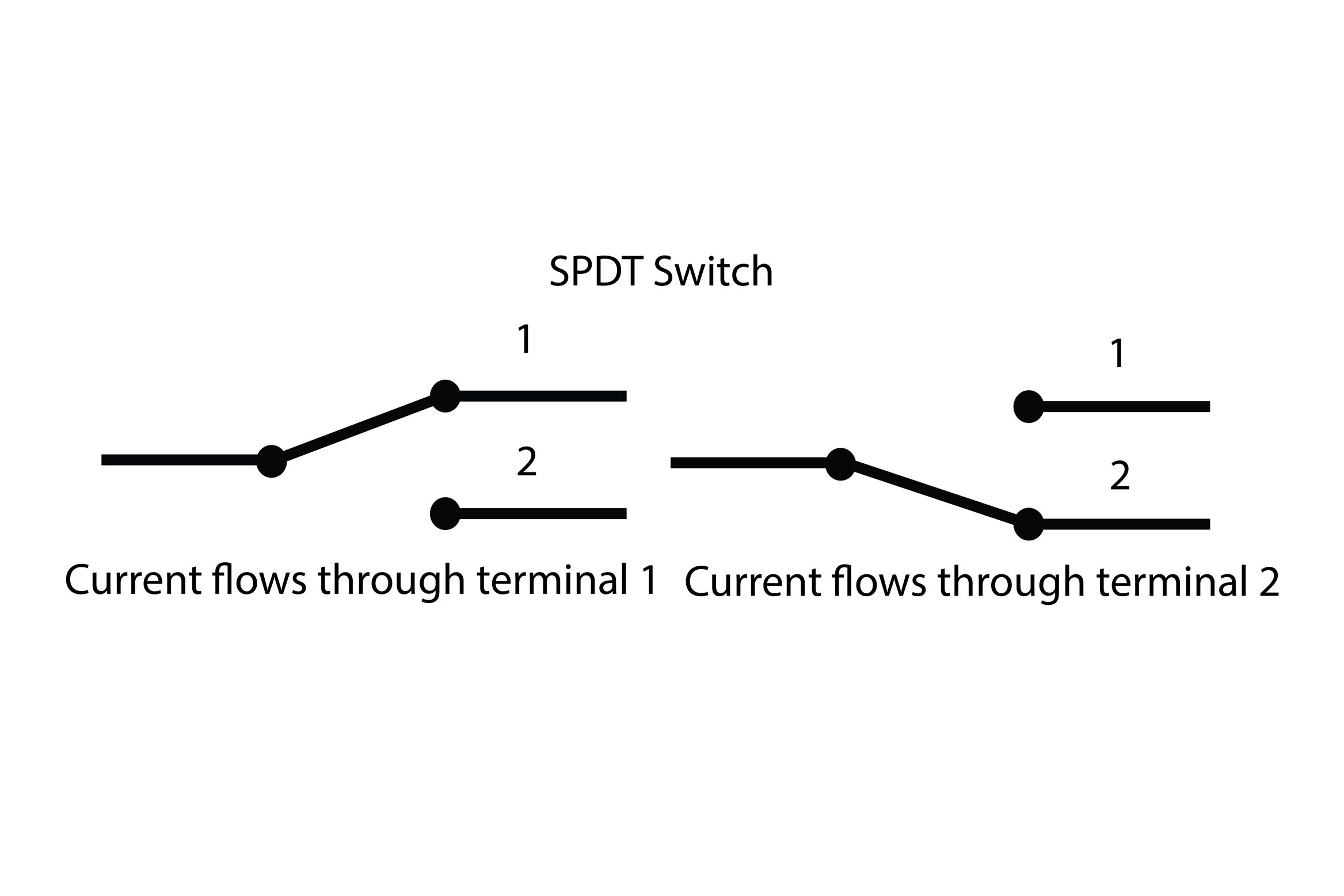

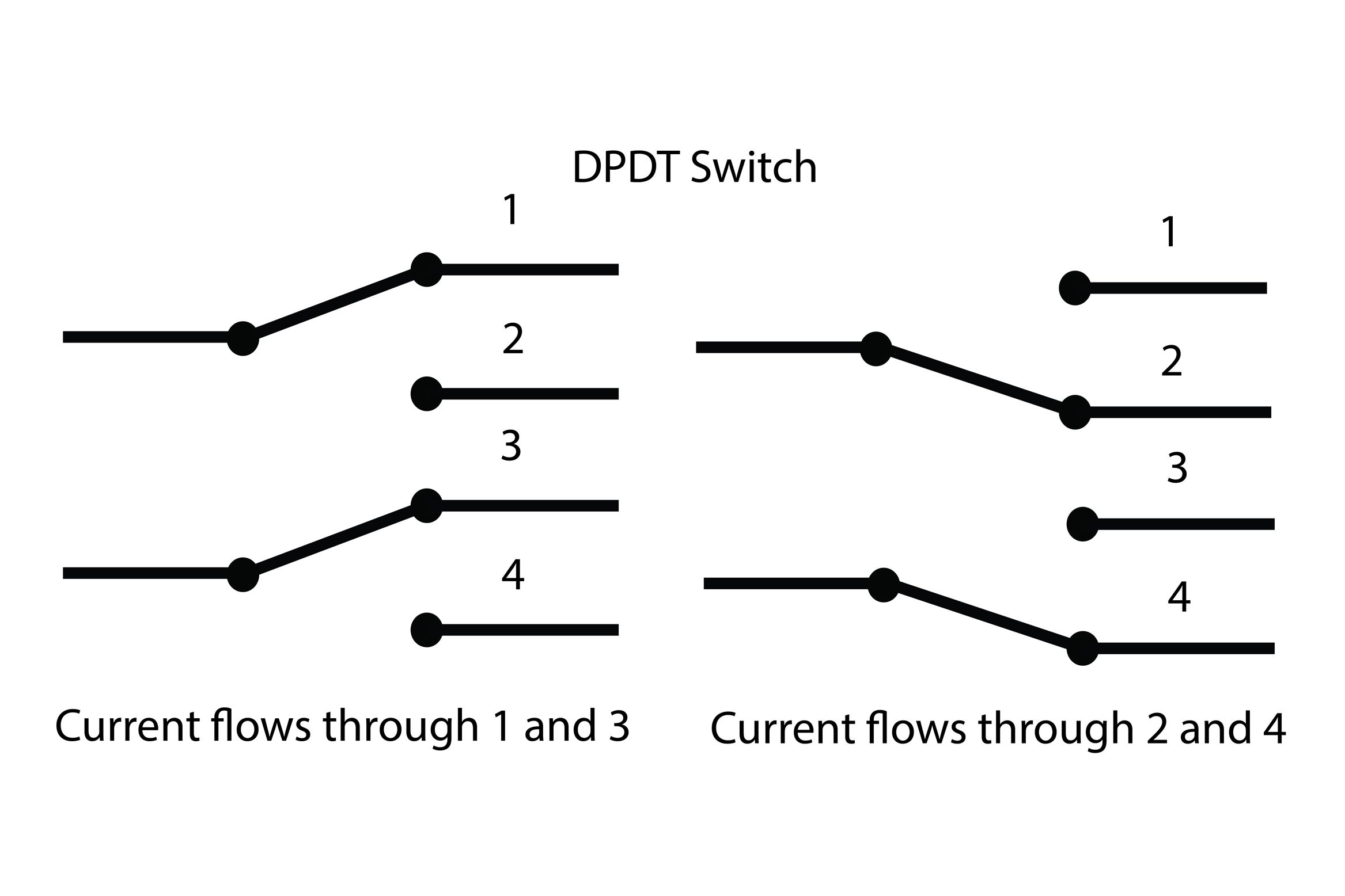

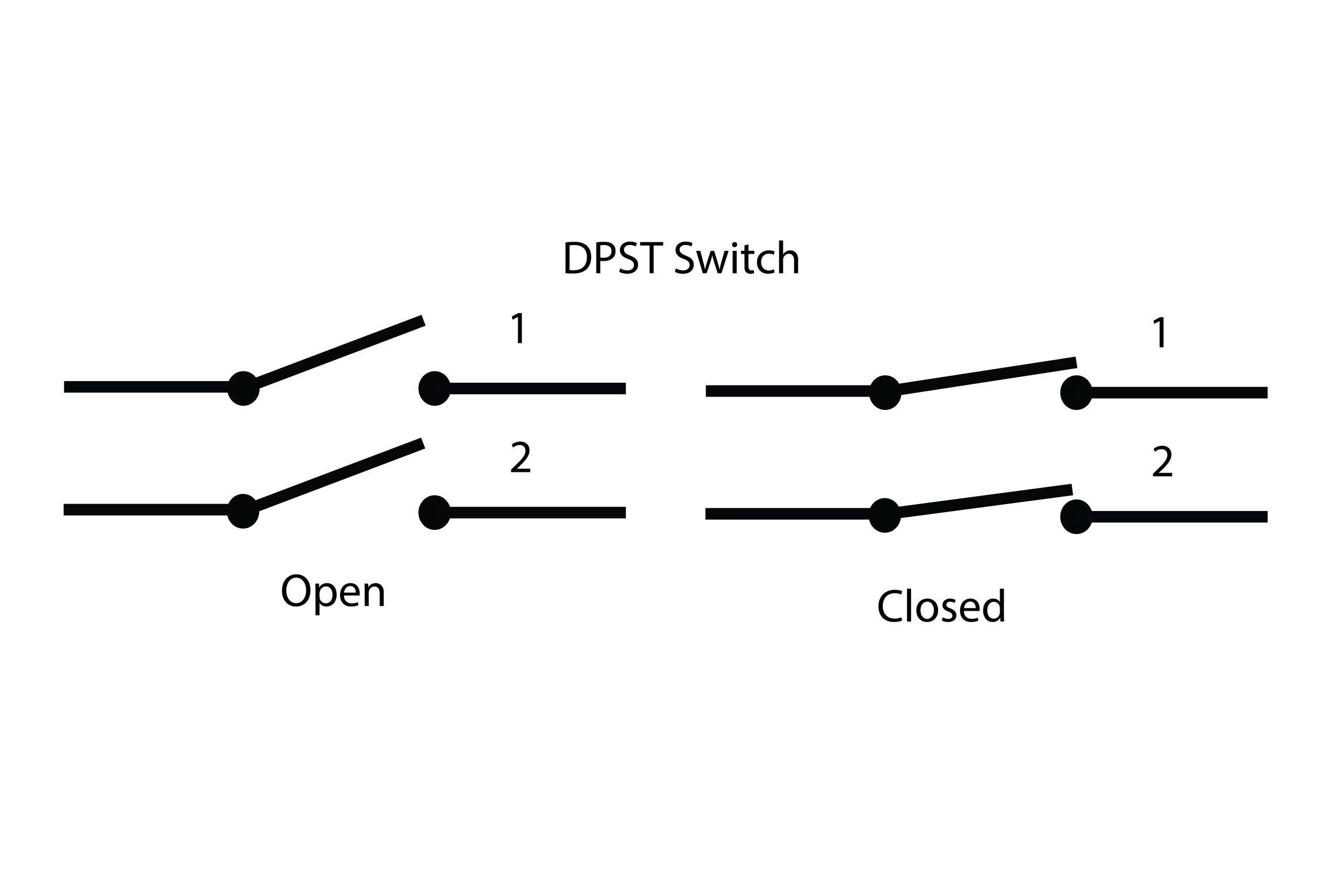

The pole refers to the number of separate circuits that the switch can control. A single-pole switch controls just one circuit. A double-pole switch controls two separate circuits.
The number of throws indicates how many different output connections each pole can connect its input to. Read the switch symbol left-to-right, putting the output on the right. A single-pole, single-throw switch has one input able to connect to one output. A single-pole, double-throw has one input able to connect to two outputs.
The diagrams above and below show the two different states that four different pole and throw configurations can have.
Single-pole, Double-throw
Double-pole, Single-throw
Double-pole, Double-throw

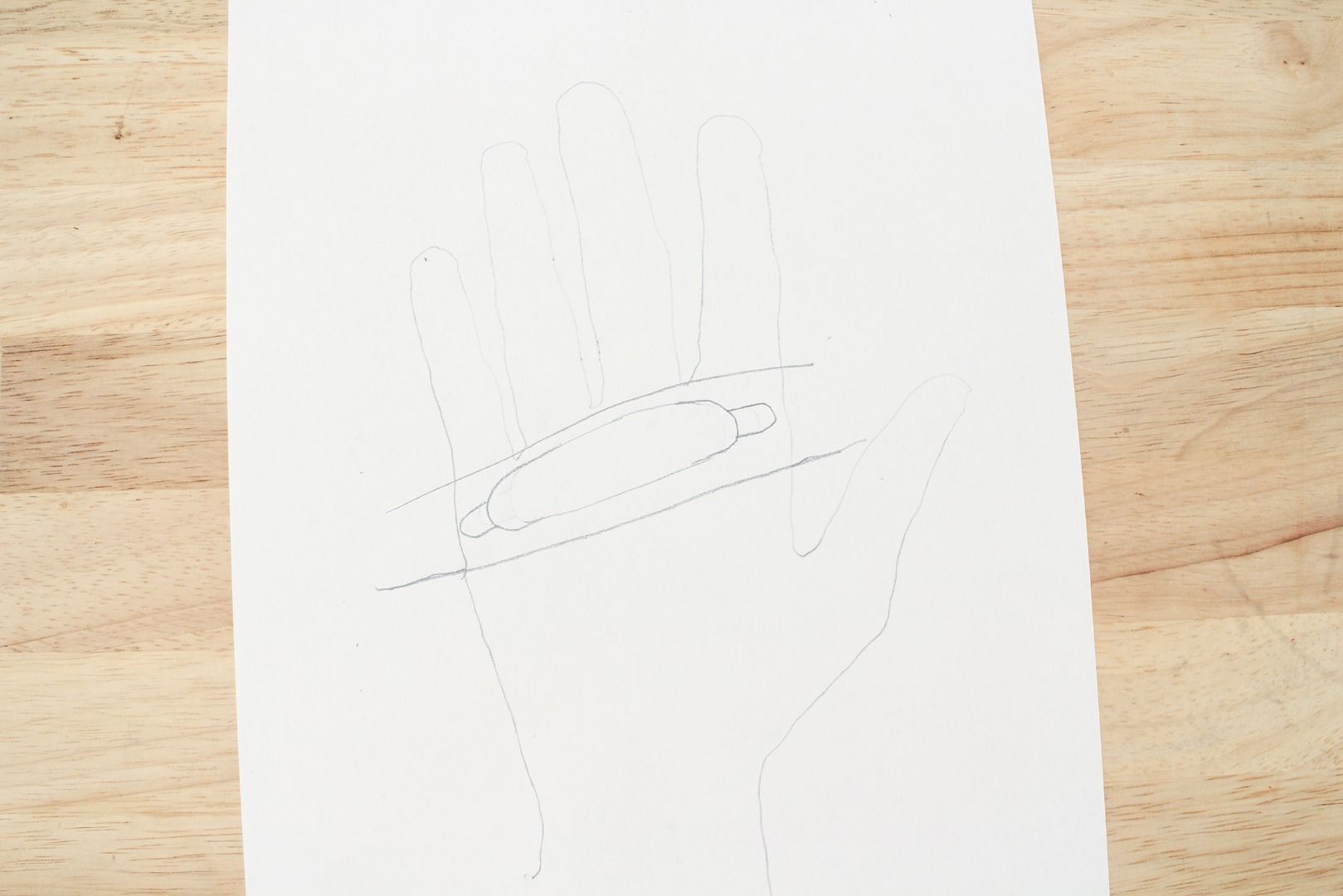

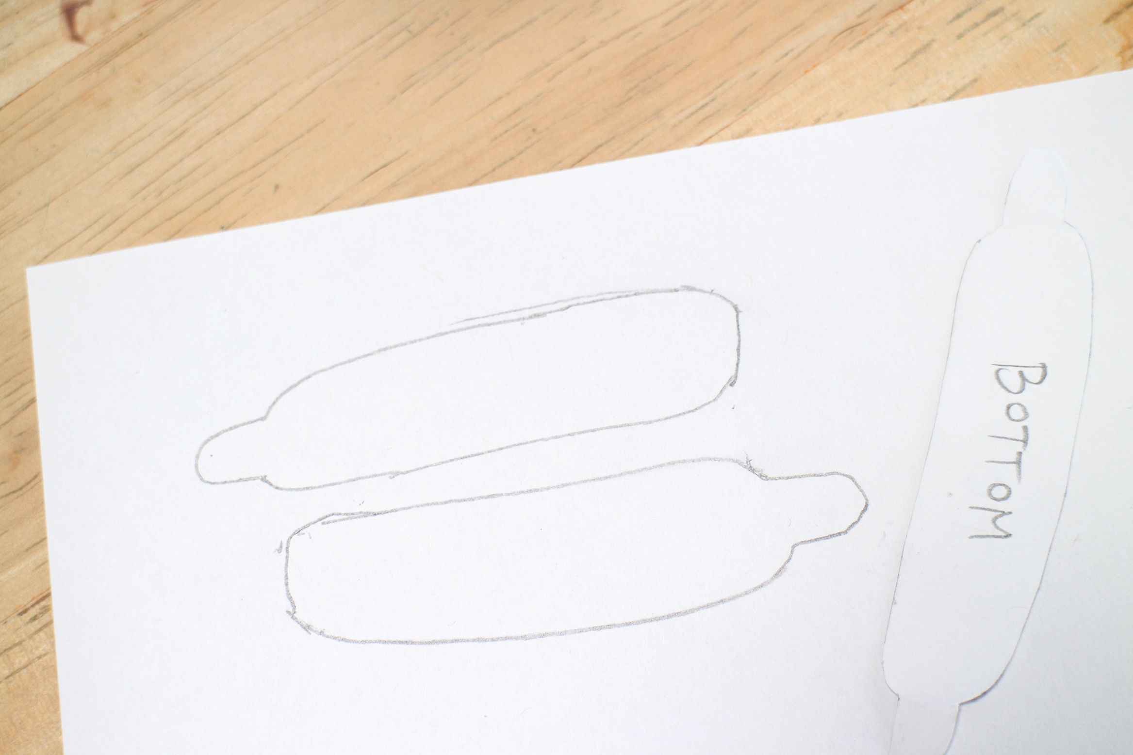

Step 9: Draw Switch Shape
I observed that all the high-fives I doled out made contact with the ball of my hand.

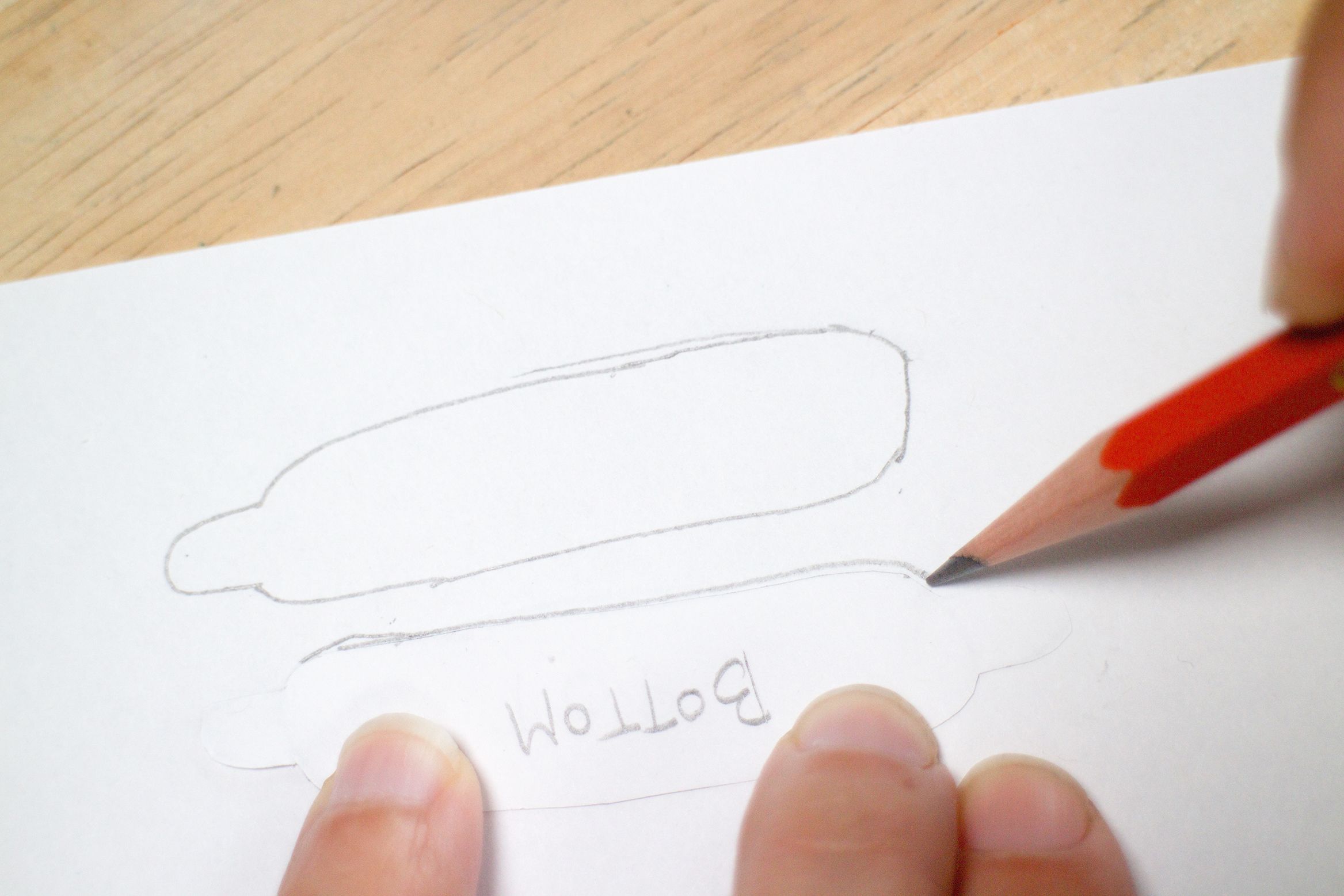

If you want to put the switch somewhere else, that's ok. Follow the steps below to create a pattern for your switch. Trace your hand and mark where you want the switch to live.
Draw a contact shape with rounded edges within the tracing. Draw in two leads. Put them in a place where they will not touch each other, a good place is on opposite sides of the switch.

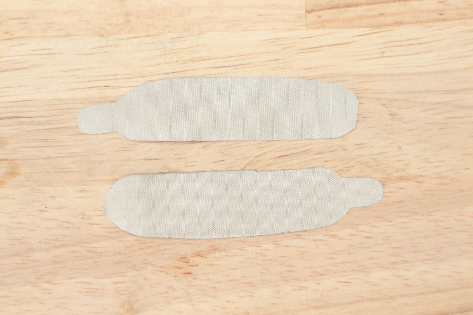

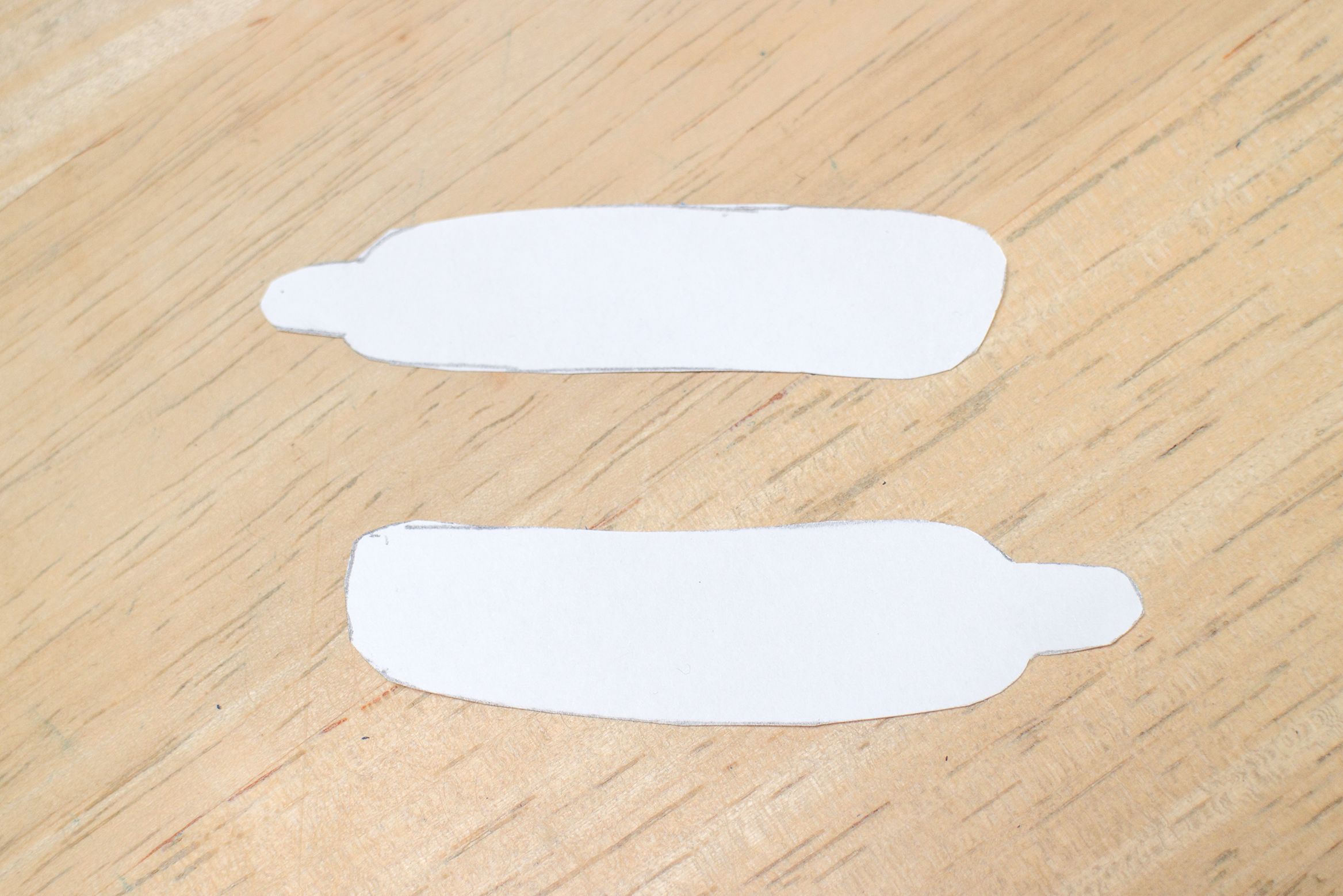

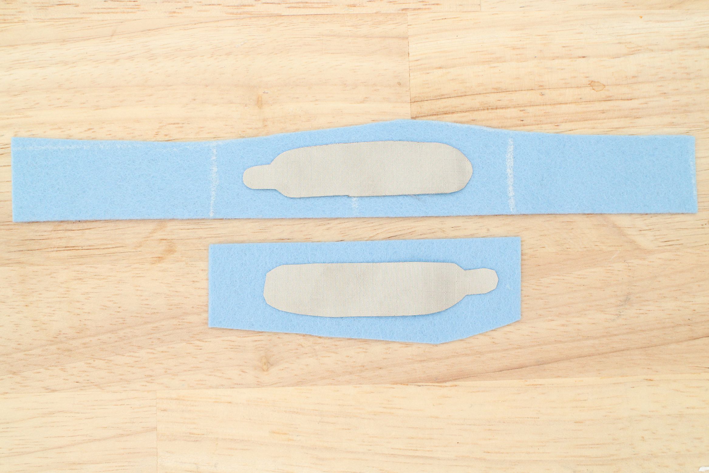

Step 10: Cut Contacts
Cut the contact with leads out from the tracing.
The iron-on conductive fabric you will use has one conductive side. This means that the pattern needs to be mirrored so the conductive sides of the switch touch each other. Grab a second piece of paper and use the pattern to trace the contact with the left lead. Then flip the pattern over and trace the contact with right lead.
Cut the two contacts out of conductive fabric face up.

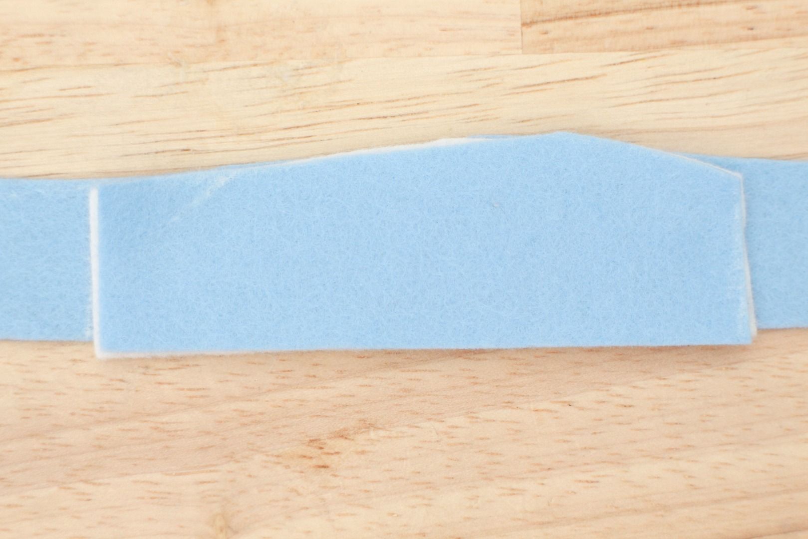

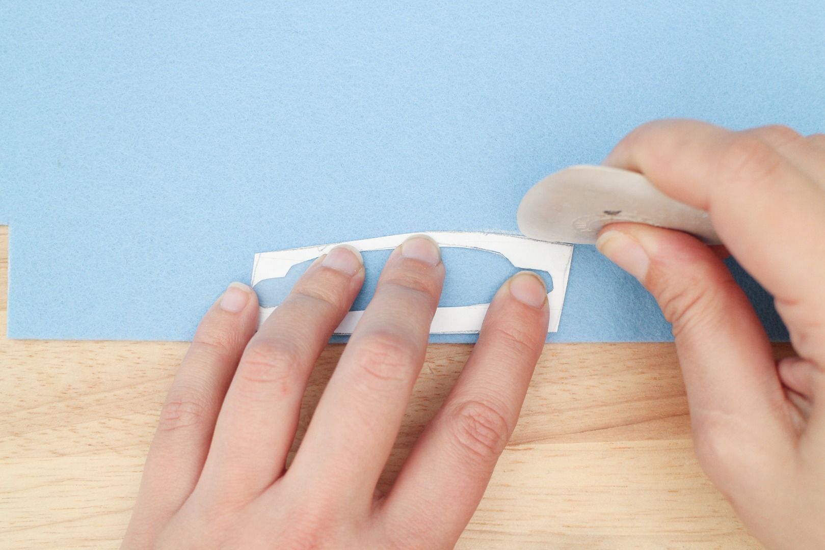

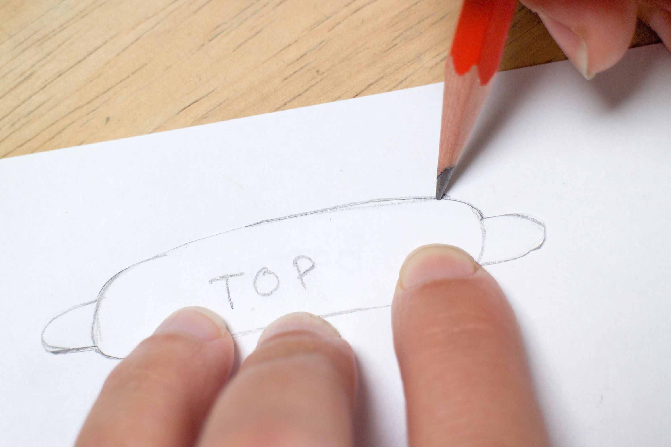

Step 11: Make Casing

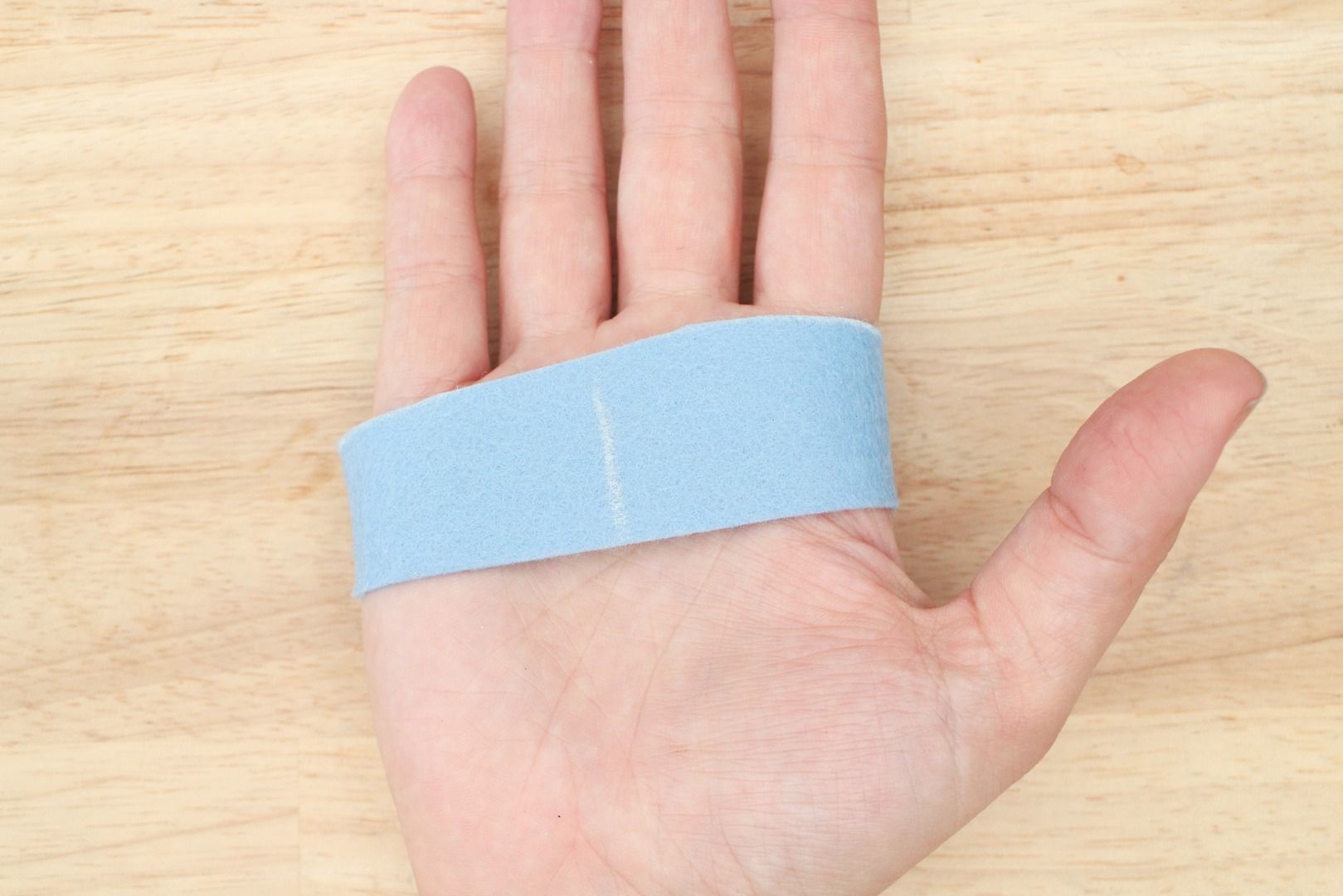

The casing is made up of a bottom and top piece of felt. The switch needs to be secured to your hand. This is accomplished by putting it on a strap. The bottom casing is a long strap, the top is shorter and only needs to be large enough to cover the contacts. Use the soft measuring tape to measure the circumference of your hand where the switch will be located.
My circumference is 7.75 inches + 1" to create an overlap = 8.75" total.
The width should be no less than 1.25" which is wide enough for the switch plus some room for sewing.
Use the measurements taken from your hand to trace a rectangle onto a piece of felt. The rectangle may not be made up of straight lines. The ball of my hand curves at the top. I transferred that curve to the top of my strap by using my hand tracing.
Cut generously if unsure since you can always cut away later what you do not need.
Cut the top casing, using the strap as the pattern to get the right shape and width.

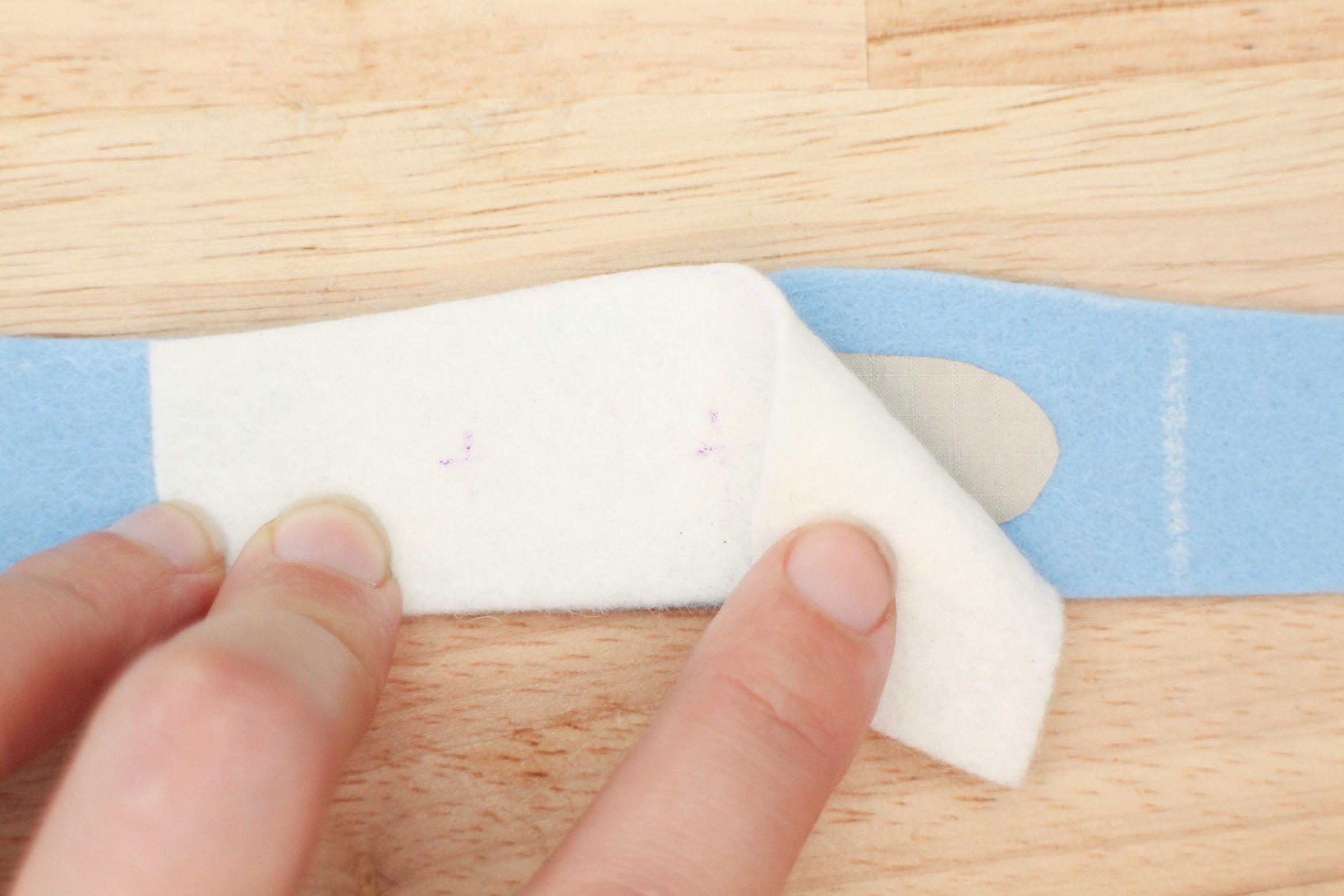

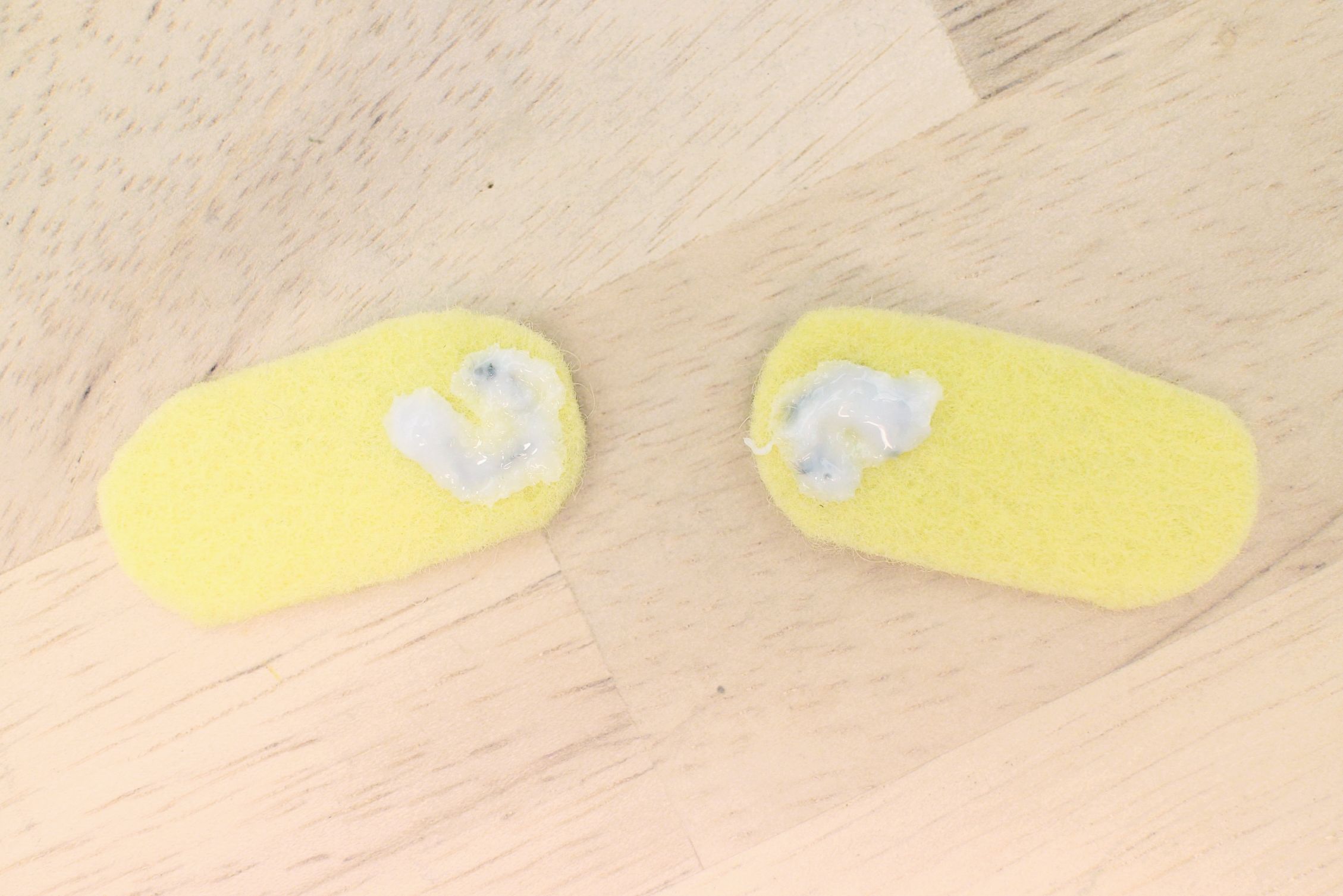

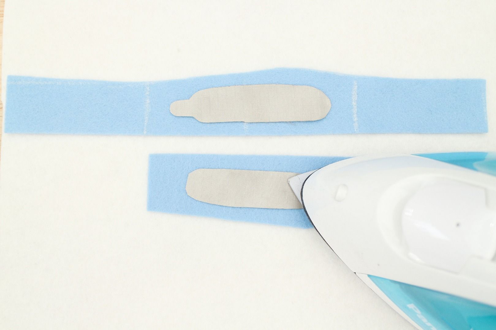

The conductive fabric you are using has a plastic coating on one side of it. When you apply heat to the metal side with the plastic side touching a piece of fabric the plastic melts. It's very simple and great to use for wearable electronics. Put your iron on the medium - high setting, this is usually the Wool setting. Place each contact on their respective pieces of felt plastic side down and use the iron to apply heat on top.

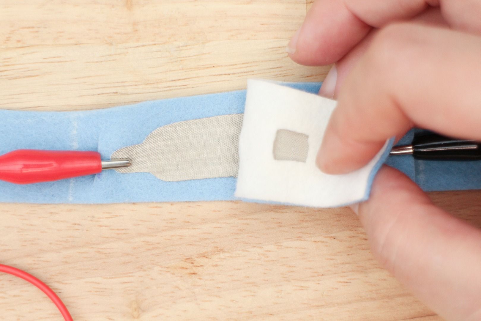

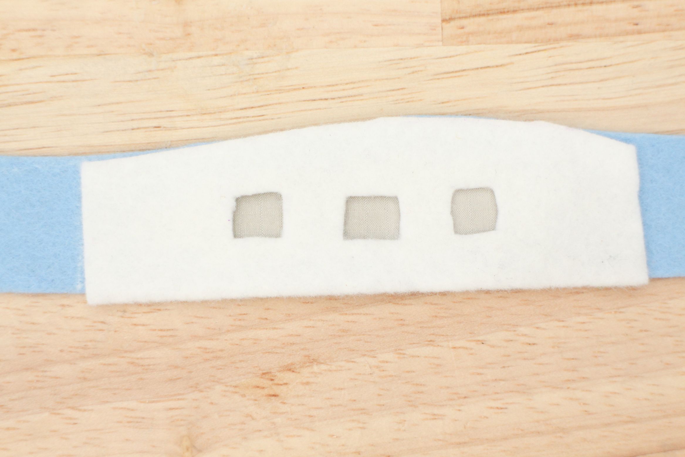

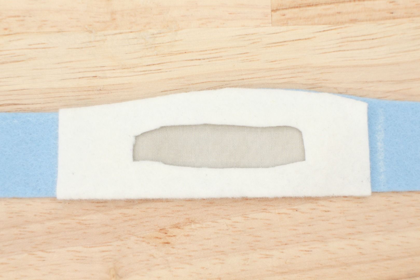

Step 12: Make Spacer

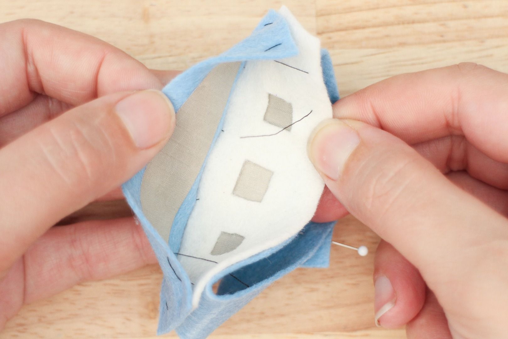

The last thing to make is the spacer. Use the top casing as the pattern for the spacer layer, making it the same shape and size. Place the spacer on top of the bottom casing.
Mark and cut out one or multiple openings.
Put the top casing on, creating a sandwich and completing the switch design.

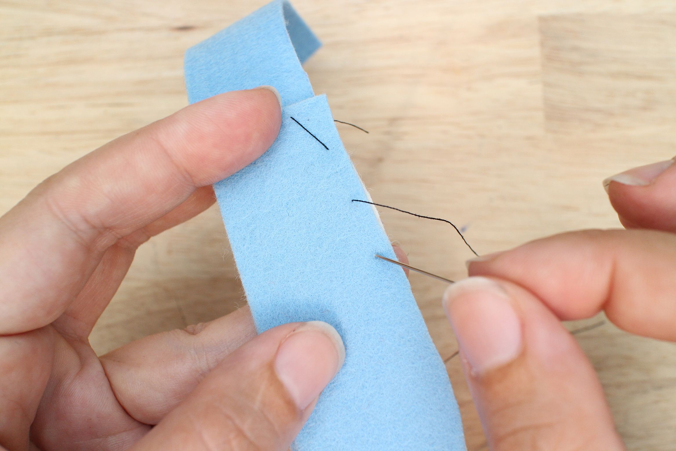

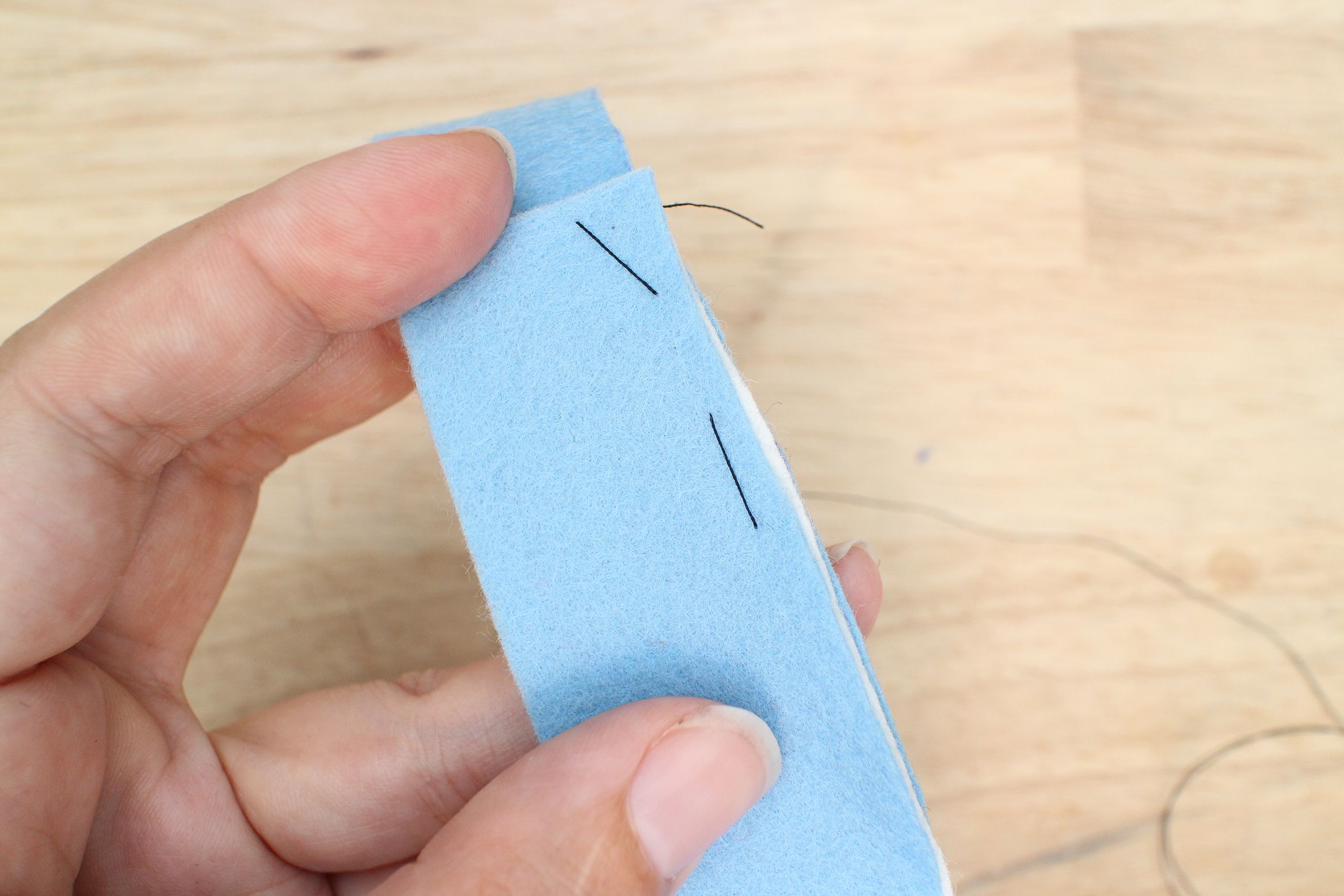

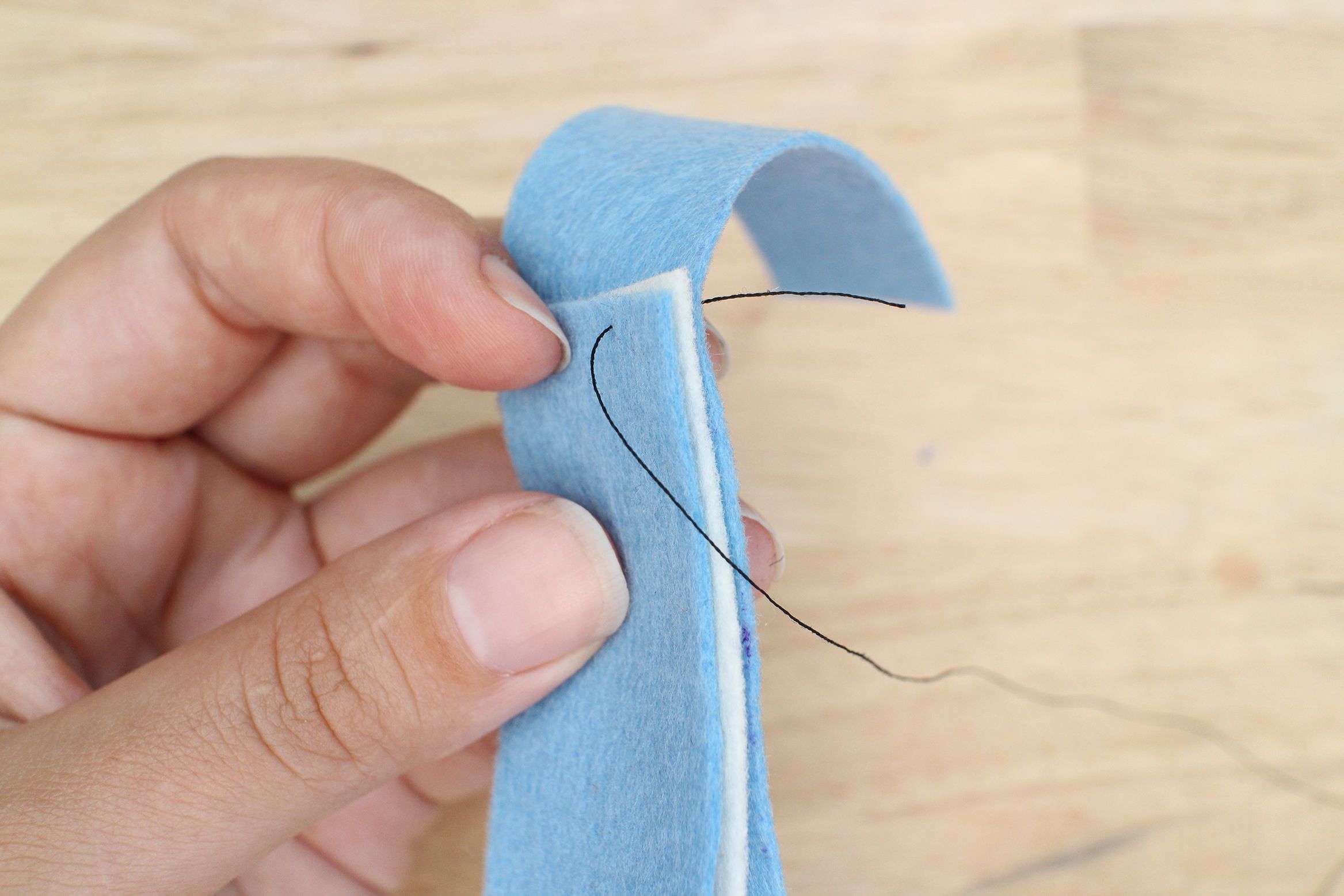

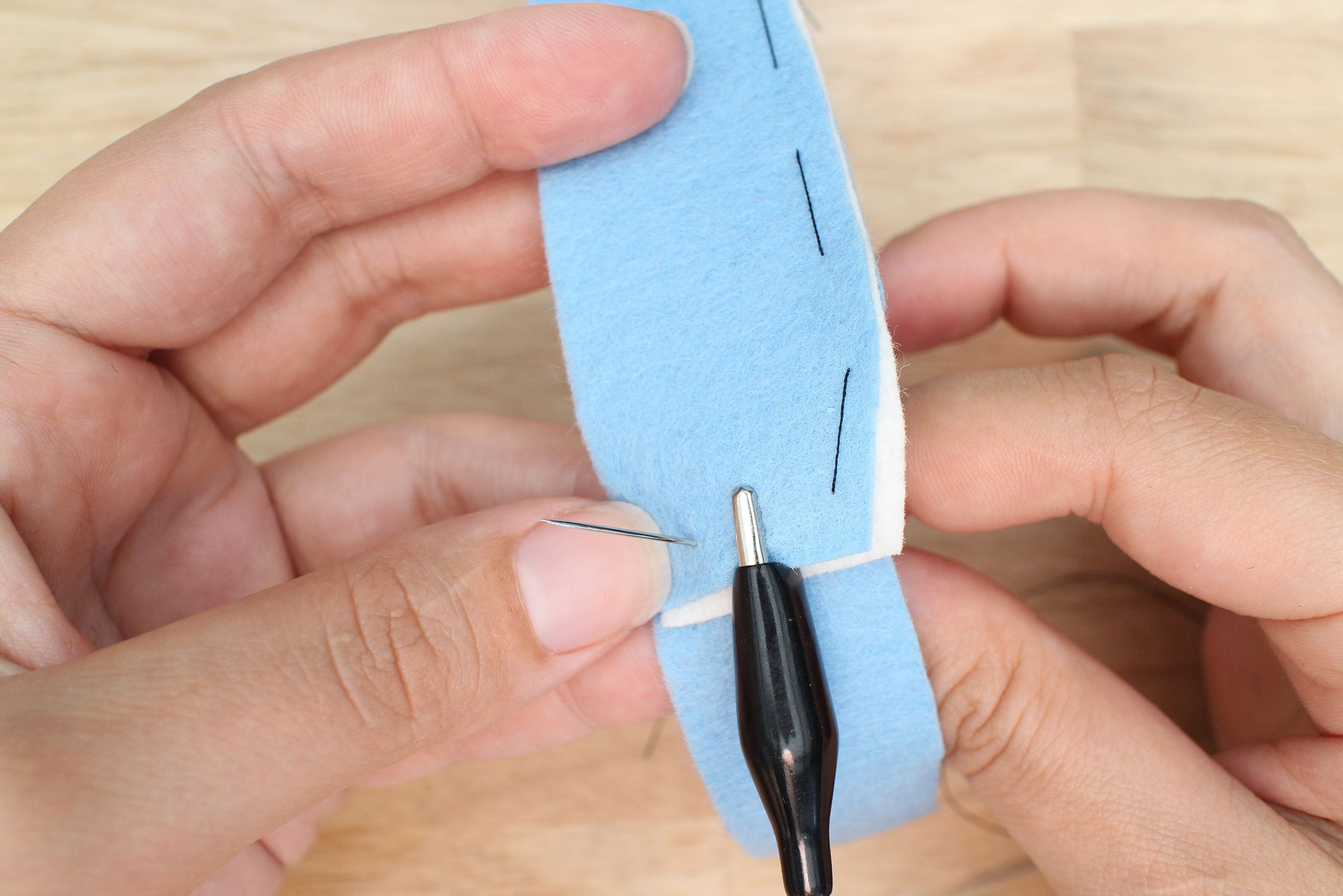

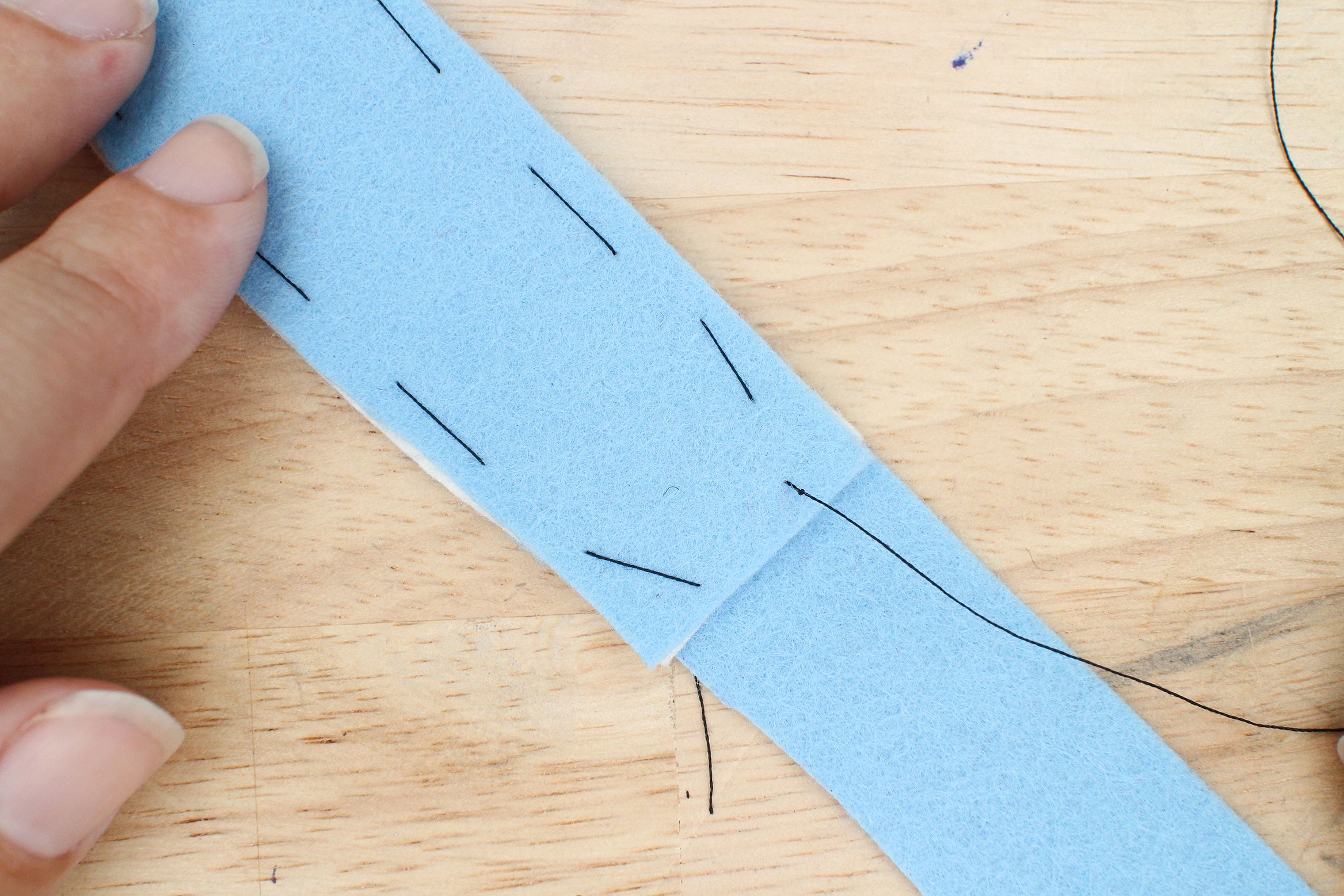

Step 14: The Basting Stitch

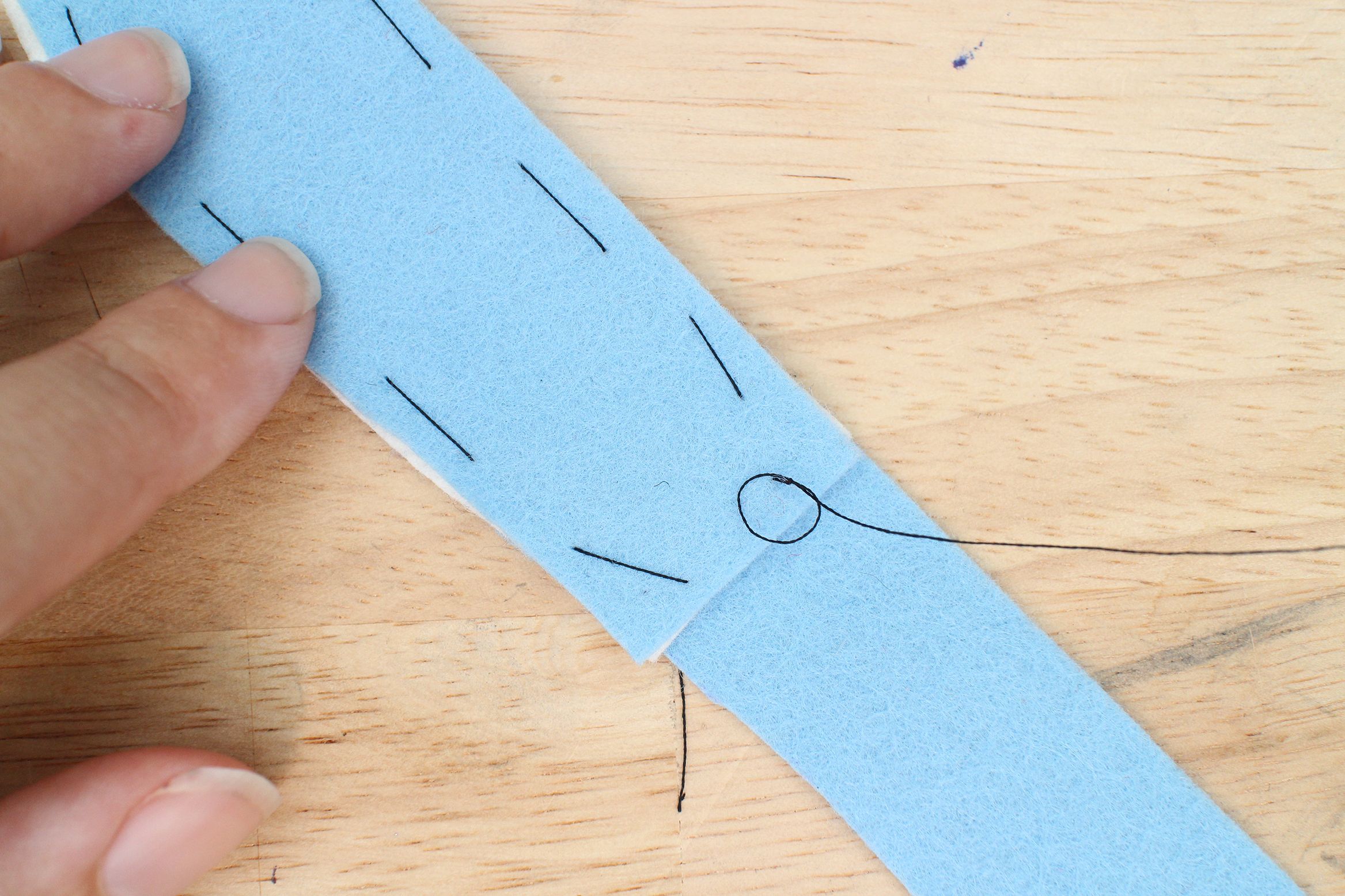

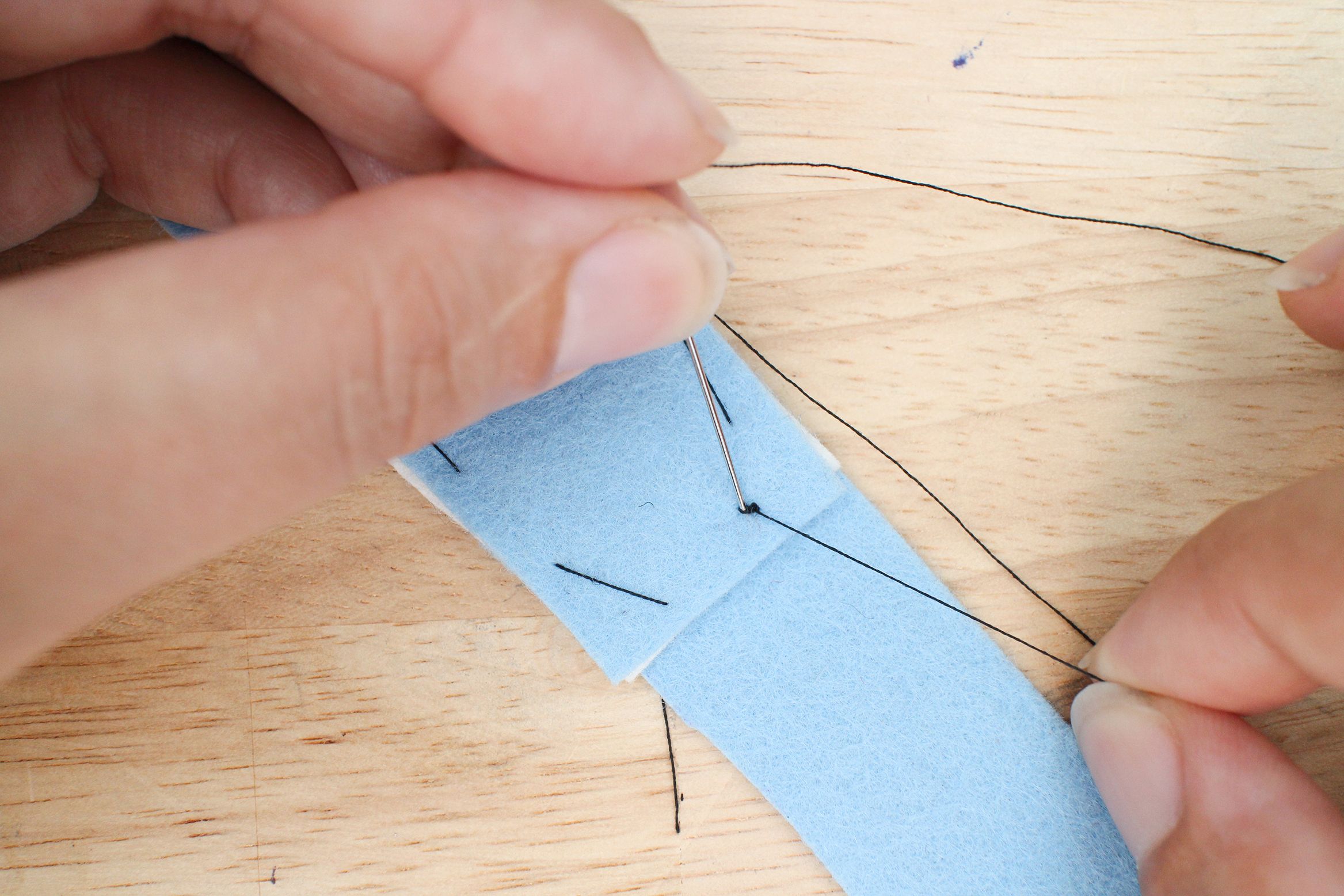

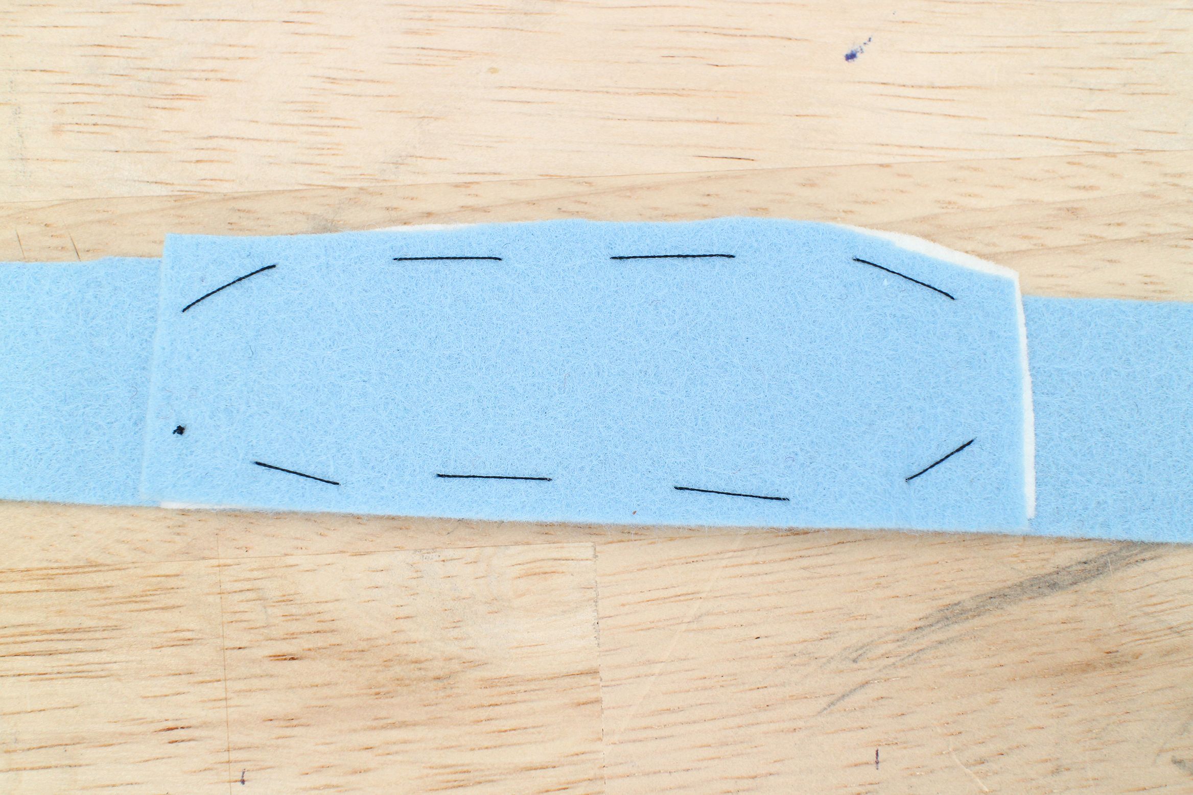

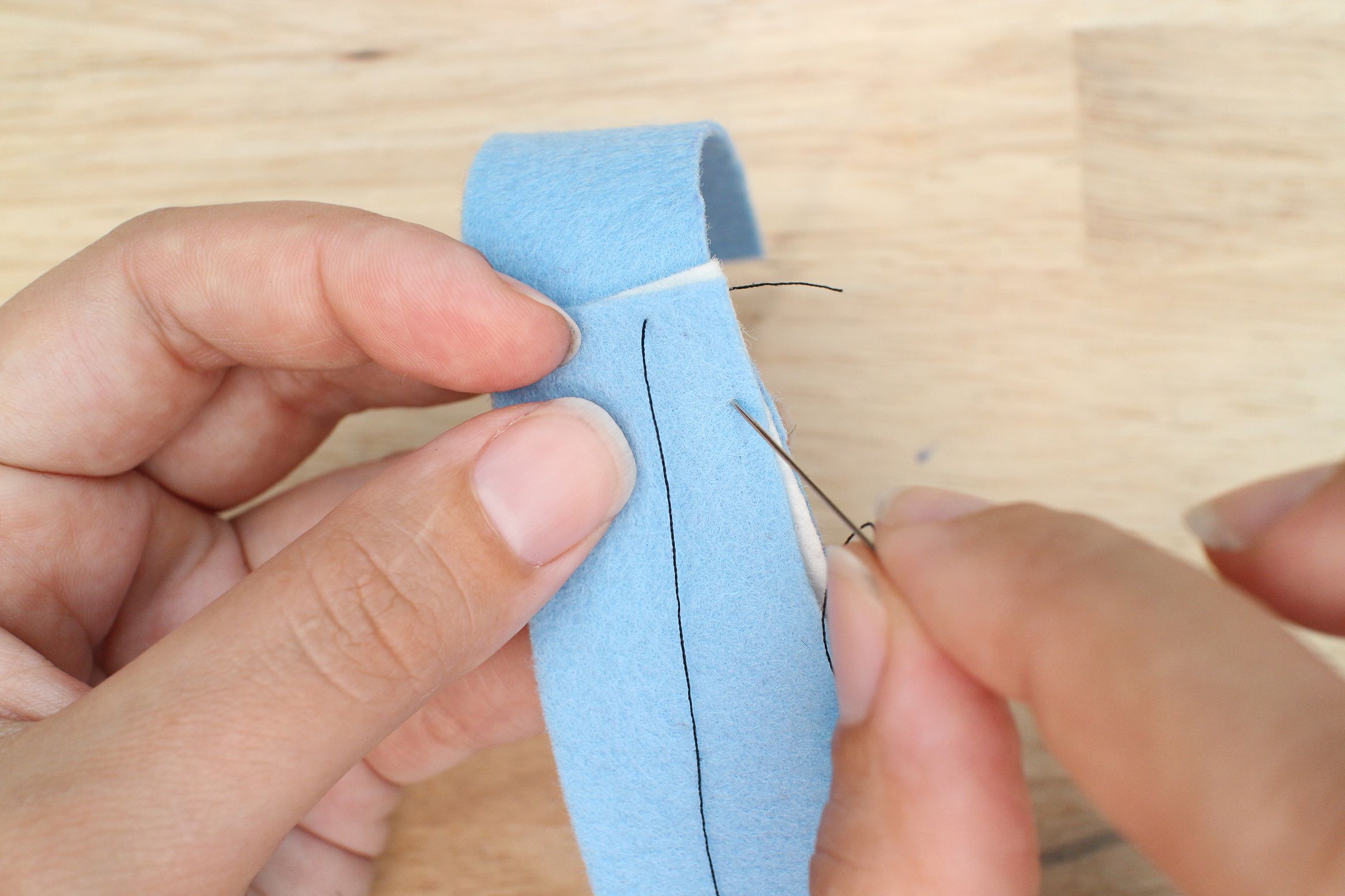

The switch is now ready to be sewn closed! We will be using the basting stitch. This is a stitch made for temporarily tacking fabric in place. It's very useful for prototyping since it's quick and is easily taken out. It's the same as a running stitch, except it has longer stitches.
Thread a needle with 18" of regular thread and knot the end. Baste all 3 layers of the switch together while still leaving room for the alligator leads to clip to the leads.
Knot once using the method learned in the Sew a Circuit lesson.

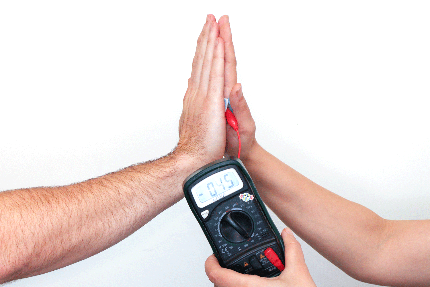

Connect the switch to the multimeter using alligator leads and pin the strap around your hand. Set the multimeter to the continuity setting. Find a friend, give them a high-five and listen for a beep. If the high-five is too quick and the switch only connects when more pressure and time is applied to the switch, make the opening(s) in the spacer larger.
Testing with the multimeter is the best way to fine tune a switch's sensitivity before finalizing the design. For example, I first had three small openings along the length of my switch, fearing that a larger one may be triggered too easily. After testing it with the multimeter, I realized that contact could not be made easily between the three smaller openings. I cut the basting stitch and pulled open the switch sandwich.
Based on the learned information, I ended up cutting a larger opening. I then sewed it back up with a basting stitch, tested it again and it worked great!

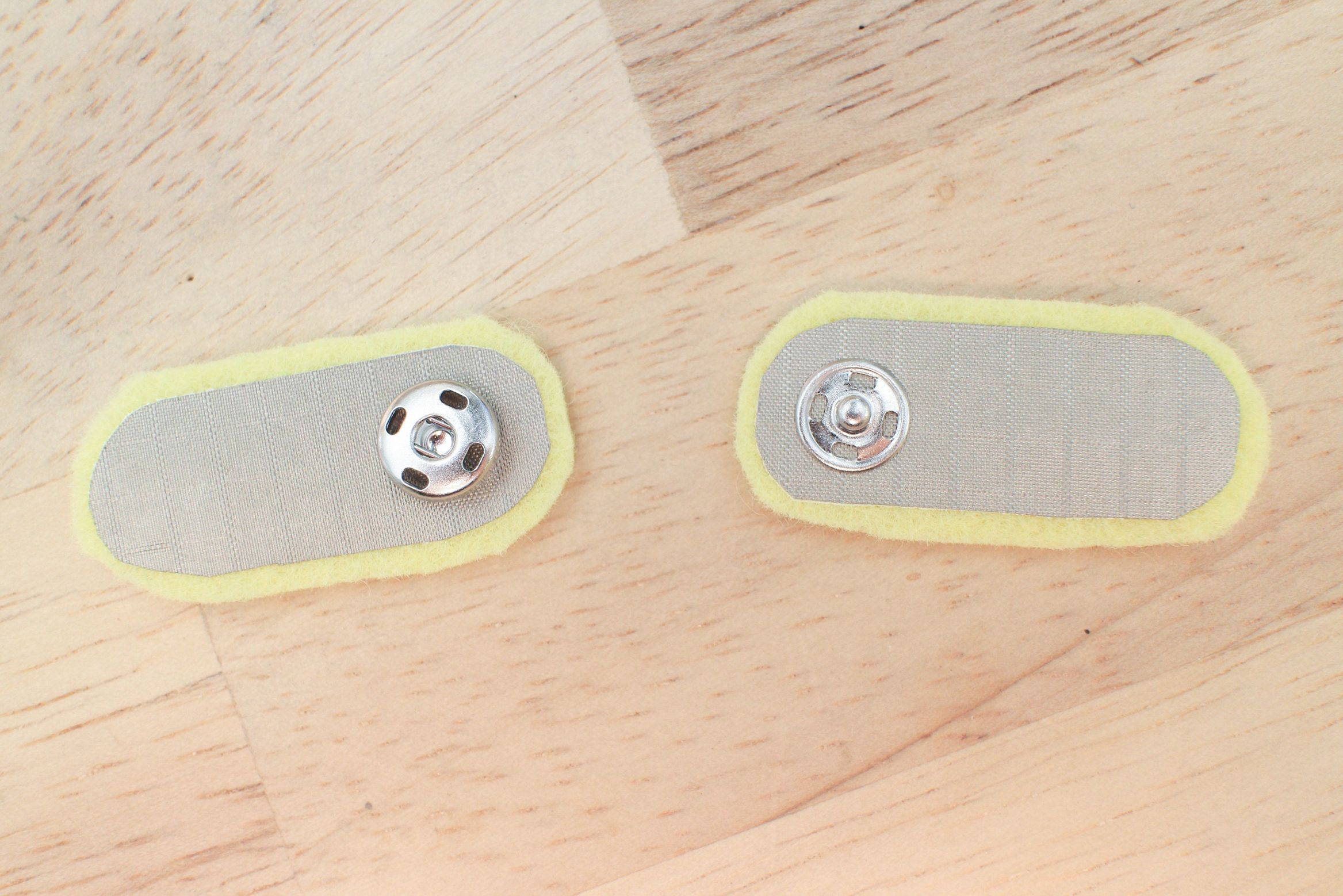

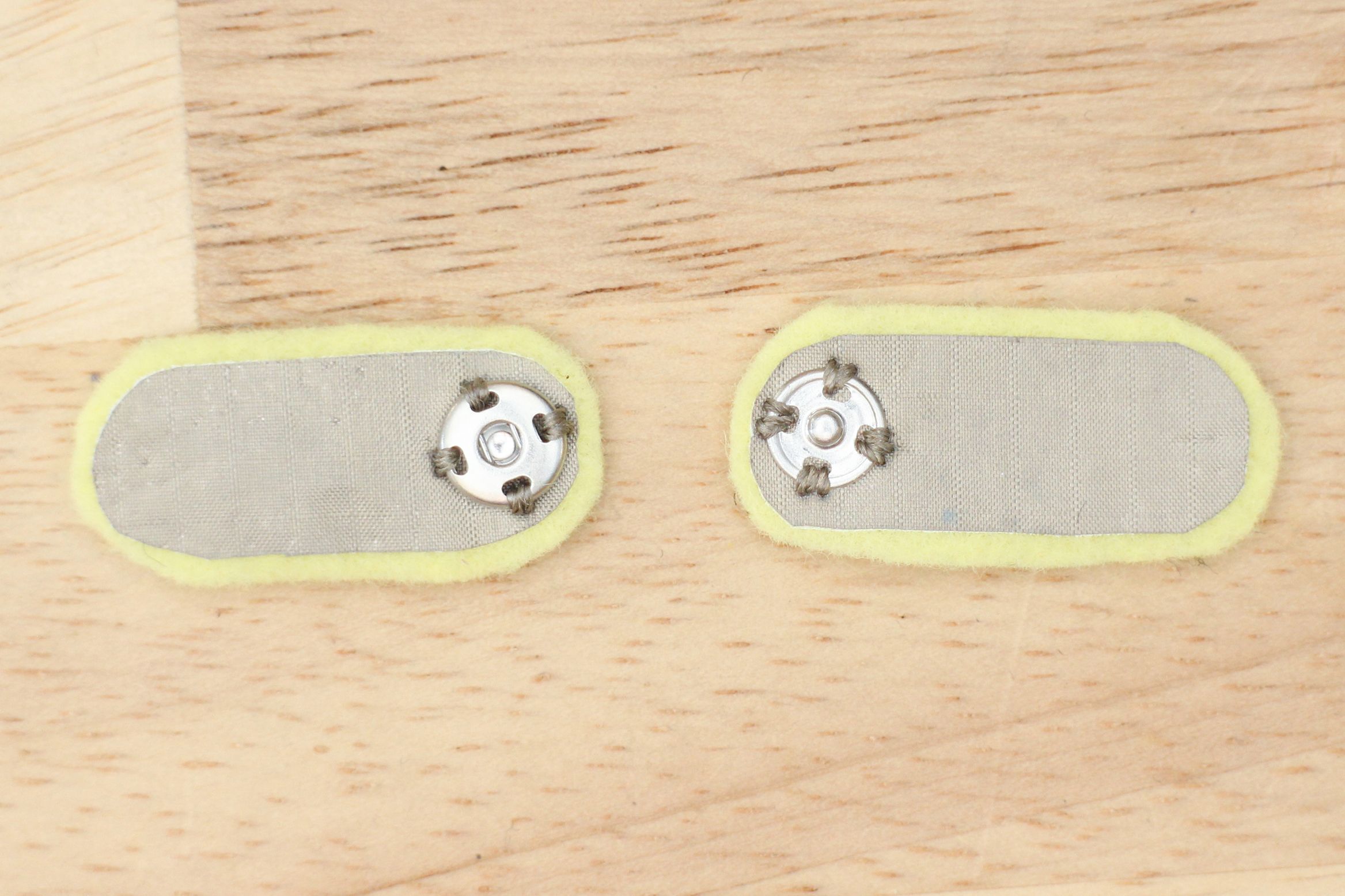

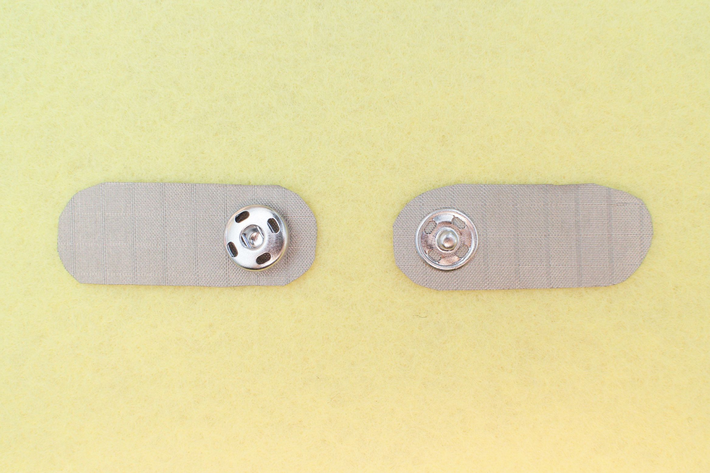

Step 16: Snap Switch

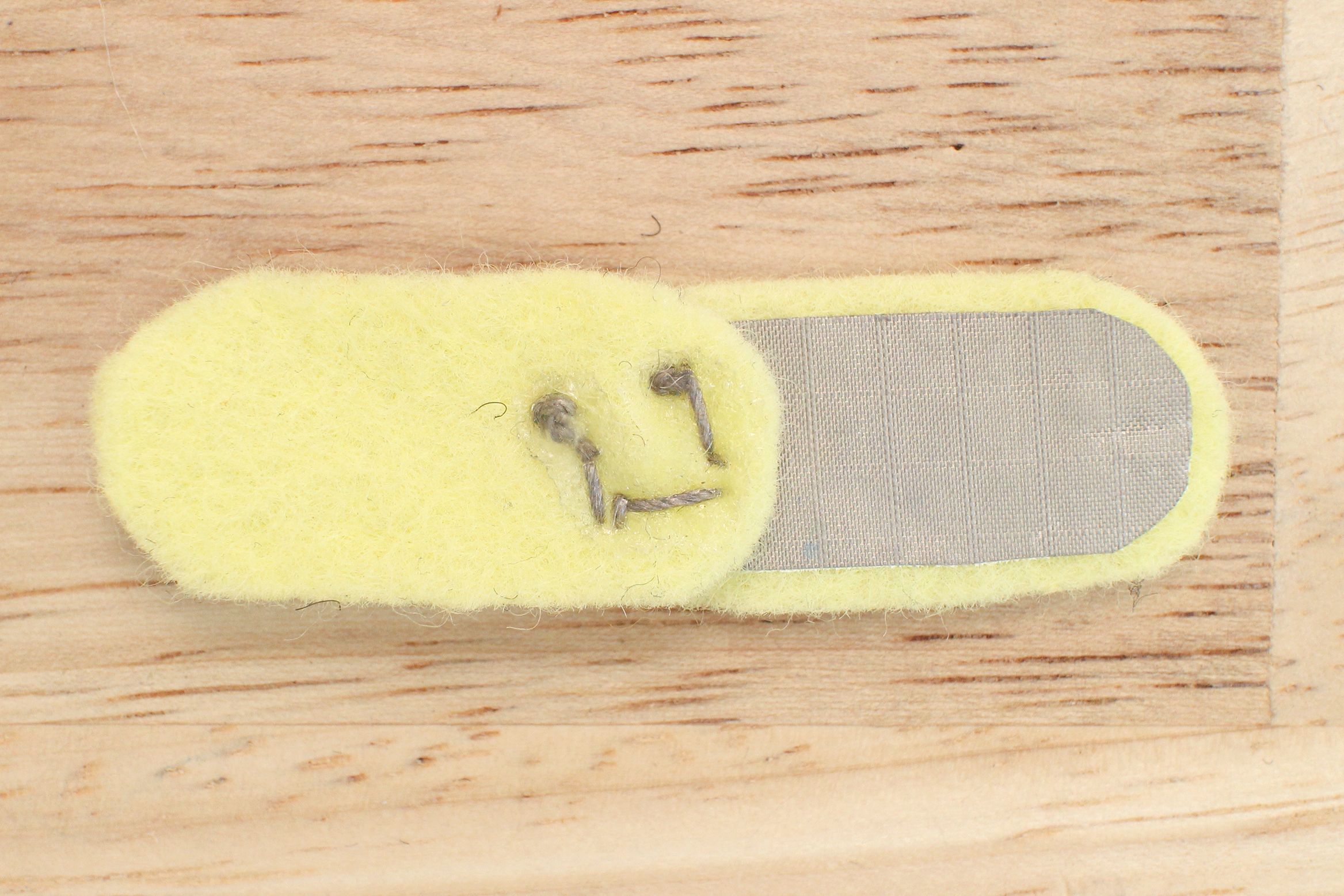

While you are warmed up, you are going to create a second switch. This one will come in handy during a later lesson. Grab the set of snaps, felt, conductive fabric and thread, this one is quick! Use the pattern you downloaded earlier in the lesson or draw it right on the material using the fabric marker.
Cut out two rounded rectangles from the iron-on conductive fabric. The size of the rounded rectangles should include the size of a snap (contact) and room to clip and sew to (lead). Cut out the same size and shape of the contacts from some felt.
Iron down the fabric with the iron on a medium-high setting. Thread a needle with 12" of conductive thread. Sew through all the holes of the snap using the skills learned in the Sew a Circuit lesson. Knot and cut to finish. Instead of just covering the knot, use the Aleene's glue to cover all the thread. It's a small amount to cover so you may as well. This way it's insulated and you don't have to worry about later.
The switch closes when snapped together and is open with disconnected! The snap can act as a connector and as an electrical snap all in one. Go ahead and test it with the multimeter to hear that satisfying beep.
