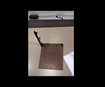

Step 2: Sensory Board Base
- Cut the sheet of plywood using the table saw into two 12"x18" boards.
- Sketch out a curve with a 1.5" radius of curvature on each of the four corners of both boards using string tied to a pencil. Hold the string with your finger 1.5" away from the pencil and sketch the arc.
- Using a jigsaw, cut on the lines of both boards.
- Using a table saw and jigsaw, Cut a 10"x16" rectangle starting on the narrow side of only one of the boards.There should be a two-inch border on all sides of this board except for one narrow side having no border, similar to the shape of a "U" (see picture) This will become the top layer of the final product. Try to keep the wood that was cut out as intact as possible for later use, especially the 10" side that is curved.
- Sand the inside edges of the board using 300-grit sandpaper and electric sander until the edges are straight, and the corners are perpendicular.
- Replace the 300-grit sandpaper with 400-grit and sand lightly for a smoother finish.
- Set the blade height of the table saw to 1/2".
- On the other board, measure and draw four-18" lines that run across the board and are perpendicular to the narrow 12" side. Starting from one side of the board, the lines should be at 3 5/8", 5 1/2", 7 3/8, and 9 1/4". Add two parallel lines 3/8" away on the left and right on each initial line. There should be 4 - 3/4"x18" rectangles on the board that can be shaded in based on the lines drawn.
- Using a table saw, run this board across the blade until each of the 4 - 3/4"x18"x1/2" trenches are carved out.
- Cut the McMaster Carr T-Tracks into 4 -16" long rails using a Mitersaw if it has a blade designed for cutting aluminum. If not, cut using a handsaw.
- Test if the rails fit snuggly into the trenches. If not, sand the inside walls and floor of the trench using 300-grit sandpaper.
- Apply 16" of epoxy on the bottom of each trench and immediately press the four tracks into place. All four tracks should all have one of their ends flush with the same side of the board. Therefore, on the other side of the board, there should be a two-inch unfilled gap. Allow the epoxy to set based on the product's instructions.
- Using the 10"x16" that was cut out in step 4, cut four 1/2"x3/4"x2" rectangular prisms to fit into the four gaps in the trenches. Adhere them to the wooden base using wood glue. Wait until the glue dries.
- Align the board cut in step 4 on top of the board with tracks placed in it. Ensure the open end of the top layer is above the side where the tracks are flush with the narrow side. Using wood glue, adhere the two layers together and wait until the wood dries.
- Underneath the newly dried board, countersink 8 holes along where there is a two-inch border on the top board. There should be 3 holes on either of the longer 18" sides and 2 holes along the 12" where the wooden inserts filled the trench.
- Using a drill or screwdriver, screw in 8 general purpose screws into the 8 holes.
- Countersink two holes that are 1/2" deep that also are centered between each set of rails, (see CAD file).
- Using the 10"x16" rectangle using in steps 4 and 14, cut a 2"x10" rectangle from the side that still has the curved edges that line up with the top layer. Countersink two holes 1/2" deep that line up with the two whole countersunk in the bottom layer. Apply wood glue in the two countersunk holes in the 2"x10" piece and insert the dowels. Wait until the wood glue dries.
- Attach the metal handle to the top of the 2"x10" piece based on the product's method of attachment. Make sure the handle is centered for easier use.
- Apply one "screw and snap" fastener on either side of the metal handle, and another fastener 5.75" away on long sides of the bottom layer of the board.
- Cut the heavy fabric into 2-6" pieces and use a match to cauterize the ends.
- Using the mounting template (comes with the fasteners), hammer the button to both ends of each piece of fabric.
- Cut the neoprene sheet into 3 - 10"x2" strips and apply them evenly spaced on the underside of the board using the 3M adhesive strips.
- Using 400-grit sandpaper, sand down the entire board lightly to reduce splintering, make the surface smoother, and get rid of any pencil marks from measuring/sketching.
- Using painter's and newspaper, cover the entire cavity on the top of the board with newspaper and seal the walls of the cavity with painter's tape. Be sure to also cover the holes of the rails that are flush with one side of the board. Also, use painter's tape to cover the 3 strips of neoprene.
- Apply polyurethane to all of the exposed areas of the board not covered with painter's tape and newspaper.
- Apply polyurethane to the top and outward facing side of the 2"x10" piece.
- Allow the polyurethane to cure for two whole days.
