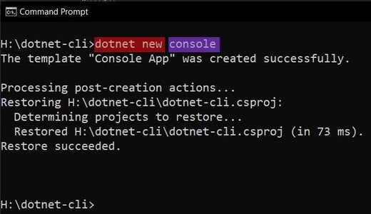

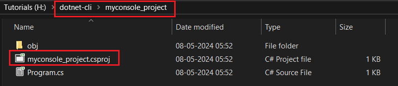

Here we can use the dotnet new command to create a simple console project for beginners.
dotnet new console
Creating a console project using the .NET SDK will automatically default to using the C# language. This means that when you run the command to create a new console project in your current directory, it will be written in C#.
However, if you want to use other languages such as VB.NET or F#, you need to explicitly specify the language during project creation

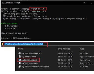

You can build your project using the command
dotnet build
When you run this command, it compiles the source code files in your project and produces executable files, libraries, or other artifacts based on the project type.
The dotnet build command also resolves dependencies specified in your project file (.csproj or .vbproj) and retrieves the necessary packages from NuGet repositories
You can now execute the executable by calling the run command like
dotnet run
here is the output for that

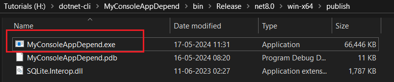

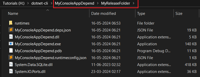

Step 11: Create an Executable Using .NET SDK CLI
You can compile your .NET application into a single folder containing both the executable (.exe) file and its necessary dependencies (.dll) using the dotnet publish command available in the .NET SDK.
Go inside the folder containing your project and run the following command
dotnet publish
this will create the executable inside the folder publish along with the required .dll files.
As you can see from here that publish folder contains a lot of dll files and json files.You can create a single file executable using the -p:PublishSingleFile=true option.
You can find the detailed tutorial on creating a single file .NET platform application using the .NET SDK CLI here.
