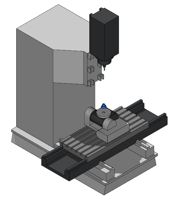

- Run a 3D Simulation
- Run a Machine Simulation
As you can see, Machine Simulations allow us to further visualize the machining of this part, by seeing the machine itself move as the part is machined. 5-axis inherently introduces a lot more moving components, and risk for collision when machining. Machine Simulations in FeatureCAM allows you to specify a ‘Machine Design’ model, and collision check your program before sending it to the machine.
