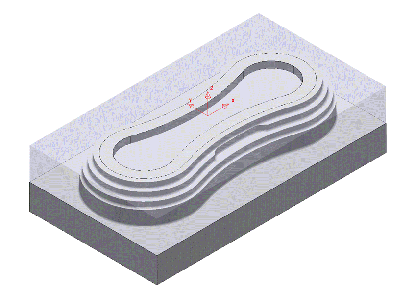

Now we need a tool rough our model with.
- Create
an tip radiused tool
- Diameter: 20 mm
- Tip radius: 1 mm
- Length: 40 mm
- Add appropriate shank
We need to add a holder because this model will involve 5 axis processes
- Holder
tab, add holder
- Upper diameter: 30 mm
- Lower diameter: 25 mm
- Length: 10 mm
- Overhang: 50 mm
- Add
another holder:
- Lower/Upper diameter: 30 mm
- Length: 30 mm
- Name the tool D20TR1 and close the tool dialog
Let’s add the necessary toolpath.
- In
the 3D Area Clearance tab, select Model Area Clearance
- Name: D20TR1-RGH
- Offset Model
- Tolerance: 0.1 mm
- Radial thickness: 1 mm
- Axial thickness: 0 mm
- Stepover: 5 mm
- Stepdown: 5 mm
- Lead in/out: Ramp
- Calculate the toolpath

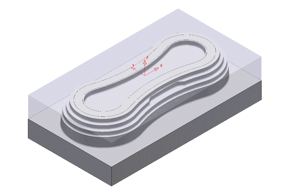

Let’s verify the toolpath because this will be necessary when we have the tool at orientations other than vertical.
- Right
click on the toolpath and select verify then toolpath
- Check for gouges first, select apply
- If no gouges, select collisions
- Holder clearance: 2 mm
- Shank clearance: 1 mm
If no gouges or collisions occur, the symbol next to the toolpath in the explorer should now appear as a blue checkmark.

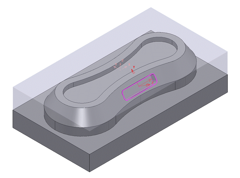

Now we can move onto the finishing strategy for the top pocket. First, we’ll need to create a pocket feature.
- Use the detect feature to create a pocket feature and name it ‘TopPocket.’

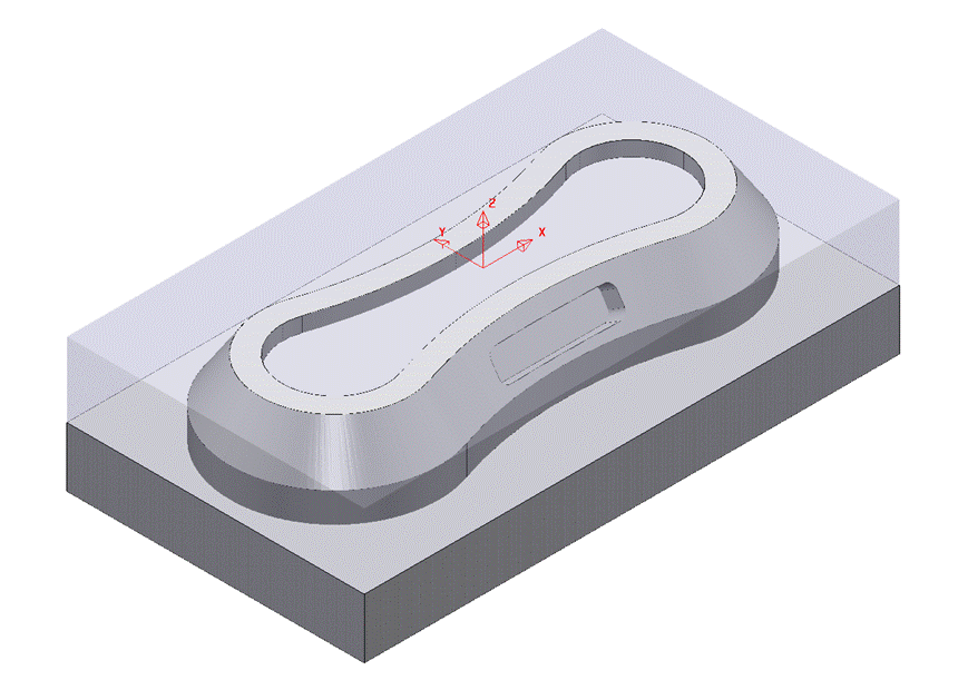

Step 3: Swarf Finishing
Swarf finishing maintains contact between the cutting portion of a tool and any continuous surfaces that need to be finished. We will perform this strategy on the wall of the boss feature and the sloped surface.
For the tooling for our swarf strategies, we will use the EM10 tool that we already created.
- Activate EM10
With our tool selected, now we can create our Swarf Finishing toolpath
- Select the Swarf Finishing strategy from the Toolpath Strategy Dialog
- Give the toolpath a descriptive name like EM10-SWARF-wall
- Leave all options as default.
- Select the surfaces that make up the wall around the boss.
- Calculate the toolpath.
- Verify the swarfing toolpath and run a ViewMill simulation.
NOTE: slow the simulation down, as swarfing toolpaths are often very short.
Repeat the same strategy as above for the sloped surface of the boss and name the toolpath EM.5-SWARF-slope. Once we attempt to simulate, we will immediately get a warning popup due to a possible rapiding of the tool into the part. We can revise this by editing the settings of our new swarf toolpath.
- Open the toolpath settings for
EM10-SWARF-slope
- Rapid Moves:
- Type: Sphere
- Center: (0,0,-28.575)
- Calculate
- Swarf Finishing
- Position
- Offset: -1.25 mm
- Position
After recalculating the toolpath, we can verify and simulate the second swarfing strategy. As you can see, the tool axis is automatically adjusted to swarf the necessary surfaces.

This is where we will need to incorporate techniques for 3+2 programming. From an ISO 1 view, we will program the pocket that is visible first. We won’t be able to machine the entire pocket with a vertical tool axis, so we need to create a new workplane that has its z-axis perpendicular to the floor of the pocket.
- Create
a new workplane using the Workplane Aligned to Geometry option
- Pin
the workplane to the bottom of the pocket
- Location isn’t important as long as the z-axis is perpendicular to the bottom
- Name the workplane Pocket1
- Pin
- Create a pocket feature for the first pocket that we’ll be programming using the same process from previous videos and name it SidePocket1.
Because we have a new workplane, we need to change our safe area or we could gouge the model.
- Go into the toolpath connections, and recalculate the safe area after changing the workplane to Pocket1.
