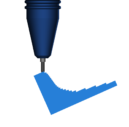

  • Create a Z-Level Roughing operation to rough the part with step-cutting
    • Surface Milling
    • Select the entire model
    • Choose a single operation
    • Z-Level Rough
    • Remachining
    • Step up: 0.125”

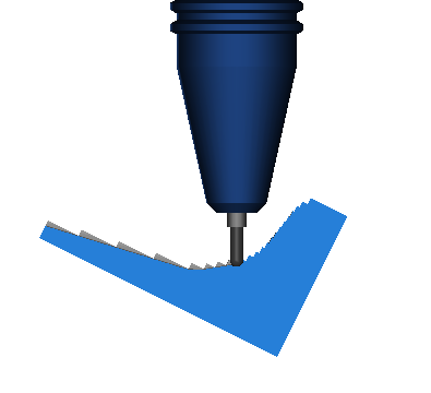

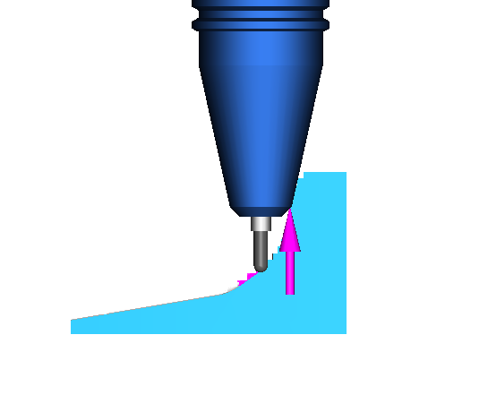

It looks like our holder is colliding into the part during the finishing operation. On a 3-axis machine, our solution might include using a longer tool, but in this case, we have a 5-axis machine – so let’s utilize our machine’s 5-axis simultaneous capabilities to correct this collision!
  • Change the tool axis of the finishing operation by defining a fixed vector
    • srf_mill2 properties
    • finishing operation
    • 5-axis tab
    • Select ‘Fixed’ and enter (-0.5,0,1) as the new tool vector
  • Run a Machine Simulation
Now we can see that the tool axis has changed to reflect our specified ‘fixed’ tool axis vector (depending on the machine, you will see these changes reflected by rotating either the table or the head). This change has completely eliminated the collisions we were experiencing earlier, and this program is safe enough to send to the machine now. However, let’s take a look at some of the other options we have utilize our 5-axis machine’s capabilities when programming surface milling features.

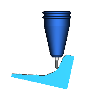

  • Change the 5-axis control of the parallel finishing operation to utilize 0-degree lead and lean angles
    • 5-axis tab
    • Select ‘Use Lead and Lean’ under the ‘Multi-Axis’ header
      • From: Contact Normal
      • Lead Angle: 0
      • Lean Angle: 0
As we can see, the ‘Lead and Lean’ options allow us to specify a tool-axis angle in reference to the direction of travel at all times – when we are machining a horizontal wall, the tool is completely vertical, and when we are machining a vertical wall, our tool is horizontal because we have indicated a lead and lean angle of zero. These options can help us generate safe, efficient tool path in a lot of situation, but in this situation, it seems that these lead and lean angles have created machine collision where the table has collided with the machine, so in this case, lead and lean angles may not be our best option.

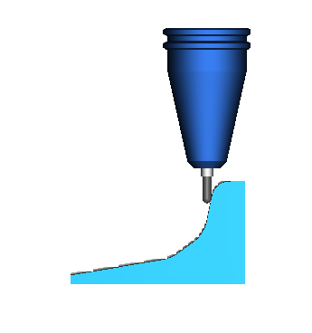

  • Set the tool axis back to vertical, and enable ‘Tilt Axis for Gouge Avoidance’
    • 5-axis tab
    • Vertical (Z)
    • Set ‘Tilt Axis for Gouge Avoidance’ to ‘Lead’
As you probably noticed, when enabling the automatic tilting options, we let FeatureCAM recognize when we are about to collide, and only engage our rotational axes when needed to prevent collisions. So in this case specifically, we kept the tool-axis fixed vertically until the holder was about to collide with the part, and then altered the lead angle accordingly.
