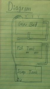

There are quite a few aquaponics system designs out there. The basic requirement for the system is to flood and drain the grow bed (plants need nutrition, but cannot be in water constantly) and to keep the level in the fish tank constant while cycling the water. I'll outline the design used in this project.
The simplest possible design is simply having a grow bed above a fish tank, then pumping water out of the fish tank into the grow bed on set intervals. The water will then drain back into the fish tank. The main issue with this system lies with the water level in the fish tank fluctuating. If the grow bed is properly sized, it will have at least as much volume as the fish tank. Therefore, the water in fish tank will be nearly all pumped into the grow bed once the pump cycle starts. In the interest of the fish, this is not desirable. The fish will be stressed as-is, considering a freshly started aquaponics system isn't exactly an ideal, stable environment.
The solution to this issue is a design known as CHOP (Constant Height One Pump). This system adds a third tank to provide the water to fill the grow bed instead of drawing from the fish tank. Therefore, the fish tank is kept at a constant height (CH) and one pump is used (OP).
I used a CHOP system, using three identical containers stacked on top of each other. The grow bed is on top, fish tank in the middle, and sump tank on the bottom. There is a drain on the bottom of the grow bed, so it will completely drain before the next pumping cycle. This is necessary so the plants can breathe and not be constantly submerged. The grow bed also has a drain placed within an couple inches of the top so there is no risk of overflow. The grow bed drains into the fish tank, which I will go into detail with later. The fish tank is kept at a constant height by a drain also placed within a couple inches of the top. The fish tank drains to the sump tank, where the pump is located. Water is pumped from the sump tank to the grow bed.
This is just an overview, I'll be going into more detail as each of these parts are built. A diagram of this system is included, check it out!

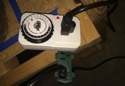

Timer: Another key part of the system, this is how the flood and drain cycles are controlled. There are other ways of controlling this, such as a bell siphon, but a timer is the easiest option to set up. The timer will need to have 15 minute on/off intervals, so we can turn the pump on for 15 minutes and let the grow bed drain for 45.
I used this one: http://www.amazon.com/Titan-Controls-734110-Inter...

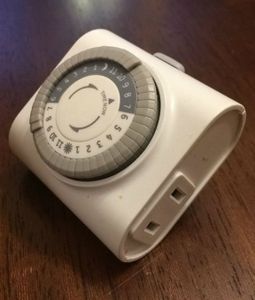

I also used a cheap christmas light timer I had laying around for the grow light. Not needed, but I figured I may as well use it.

After everything is hooked up, set the timer to 15 minutes on and 45 minutes off. The system should be ready for testing at this point. Leaks are easier to fix now than later.

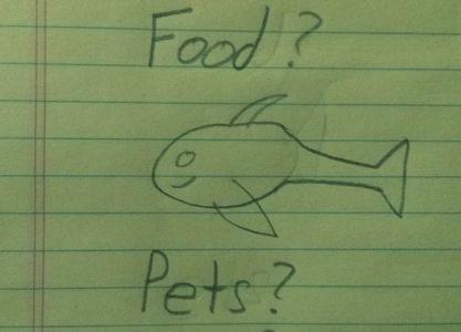

Options for food fish range from tilapia and South American pacu to whatever can be caught in the nearest pond. I won't go into detail on varieties of fish, as I'm not very knowledgeable and a quick google search will reveal far more than I can. Take note of the oxygen, temperature, and food requirements of prospective species.
Clean water free of chemicals is necessary. If you have a municipal water supply that adds chlorine to your water, let the water sit out for a few days before adding it to your system. It would be a good idea to let the system run without fish or plants for a few days after the plumbing and pump have been set up in this case. The chlorine will evaporate into the air after this period, rendering it safe for use. It would also be a good idea to test your water (many pet/aquarium stores will do this for free) so you have an idea of the properties.
I'd say to go ahead and fancy up the fish tank. Some gravel on the bottom will make their environment look more natural, and some 3" PVC fittings will give the fish cover and stimulation.

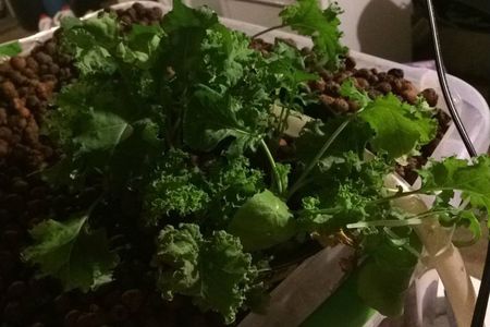

For starters, I've grown some kale. Later, other vegetables will be added. I chose the kale because they are cheap enough to be disposable, and there is a good chance not all the plants will make it during the initial phases.
As for how to actually grow the plants, they can be planted directly in the grow media as if being planted in soil. Live plants can be planted like this, as well as seeds. Seeds may not have ideal growing conditions in the grow media, and to fix this they can be started a number of different ways before being placed in the grow media.

A simple light timer will simplify things a tad.
