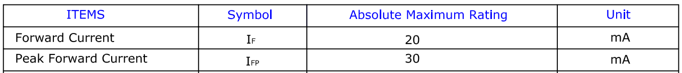

Forward Current
This is the amount of constant current the LED will use to light up. If using multiple LEDs (loads), current used adds up fast and if not considered carefully, will drain the battery prematurely or not allow the current to get to other parts of the circuit. Forward Current will most likely be next to Peak Forward Current, the difference is this: Forward Current tells you the maximum constant current the LED can take, Peak Current tells you the maximum current the LED can handle in a short burst, or when a power surge happens. The datasheet tells me the red LED needs up or 20 milliamps to light up. What does the datasheet tell you about your LED? Grab a paper and pen and write it down.
Forward Voltage (pictured above)
This is how much voltage the LED needs in order to operate, there are a minimum and maximum defined. If you give it too little, it will not light, if you give it too much, it could burn up or wear out faster over a period of time. My red LED needs a minimum of 1.8V and a maximum of 2.2V. What range of voltage does your LED need?

By looking at the datasheet in the previous step, I learned that my red LED needs 1.8V - 2.2V to operate. I will split the difference and say it needs 2 volts. The coin cell battery supplies 3 volts, which is higher than the maximum forward voltage of my LED. It's the battery that is closest to my operating voltage but giving the LED all 3 volts could burn it out.

From looking at the datasheet for the red LED I already know the voltage needed is 2V and the max current draw is 20 mA. Those are the two values I will use in the equation to get my third missing one, the resistance. At this point, you should know the forward voltage and current of your LED. Follow the steps below, plugging in your current and voltage and find out what value resistor you need.

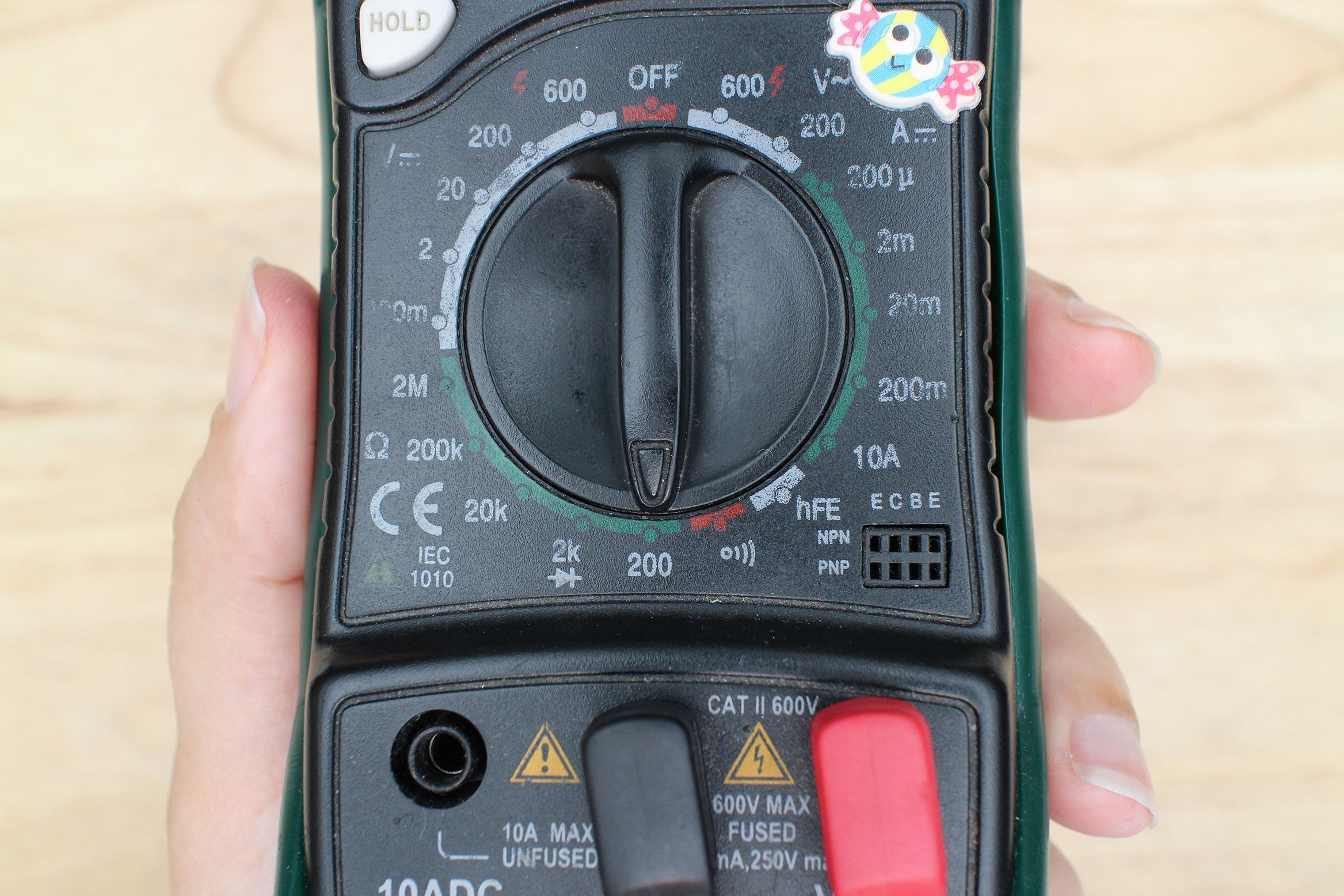

Time to get hands on! A multimeter is a measuring tool and more. It's the most useful tool you will want to keep by your side while building circuits. In this lesson, we will go over how to measure two things you have learned about: voltage and resistance. By using a multimeter you can measure how much life a battery still has or how resistive a material is. Grab your multimeter and let's measure the battery and resistor used in your circuit.
Your multimeter has two probes coming from it, a red and black one. The black should be plugged into the hole labeled COM and the red probe should be plugged into the hole that is labeled mAVΩ (milliamps, volts and Ohms).

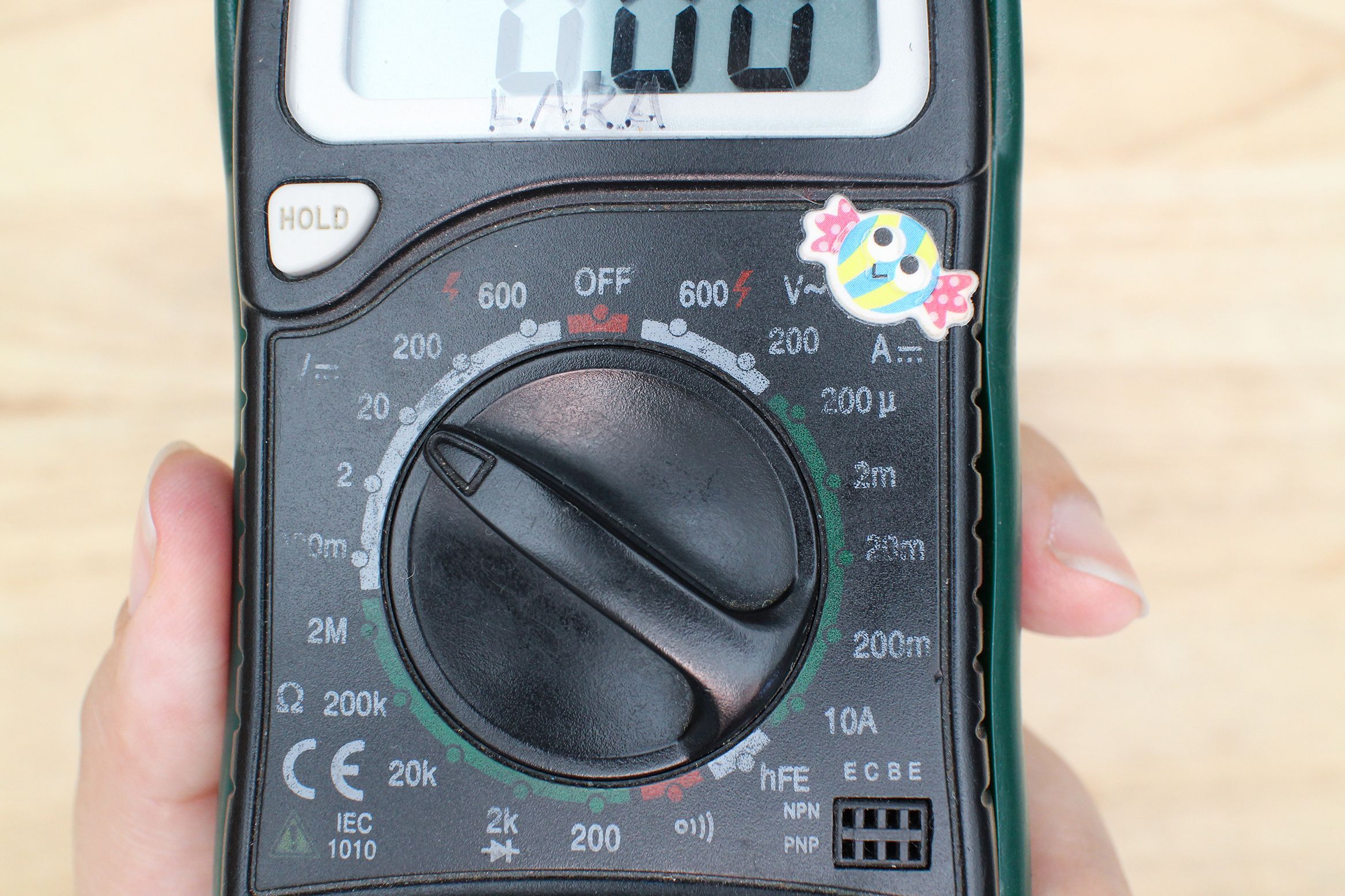

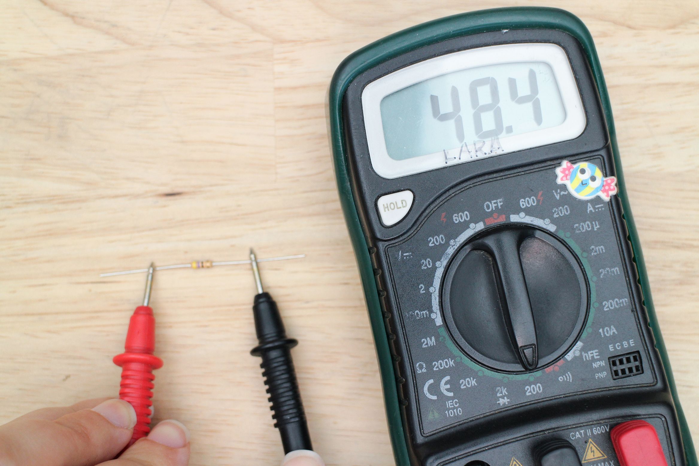

Measuring Resistance
Turn the dial from Off to 200Ω. This setting means that you can measure anything up to 200Ω. If you need to measure higher than that, click the dial-up to select the max value you need.
Grab a resistor and place it on a surface. Touch one metal lead with a probe and the second lead with the other probe. A value should pop up on the multimeter's screen. If I measure the 47Ω resistor, it tells me it's 48.4. It's ok if the resistor value is a little above or below. The gold band you can find on all your resistors tell you it has a 5% tolerance. This means it can have a value 5% lower or 5% higher than 47Ω. For many circuits, this is an ok margin of flexibility. Cool, right? Now you are read the resistance of anything that electricity can travel through. Grab another resistor and test that. You can even test a small part of your finger tip, remember, we are conductive too!

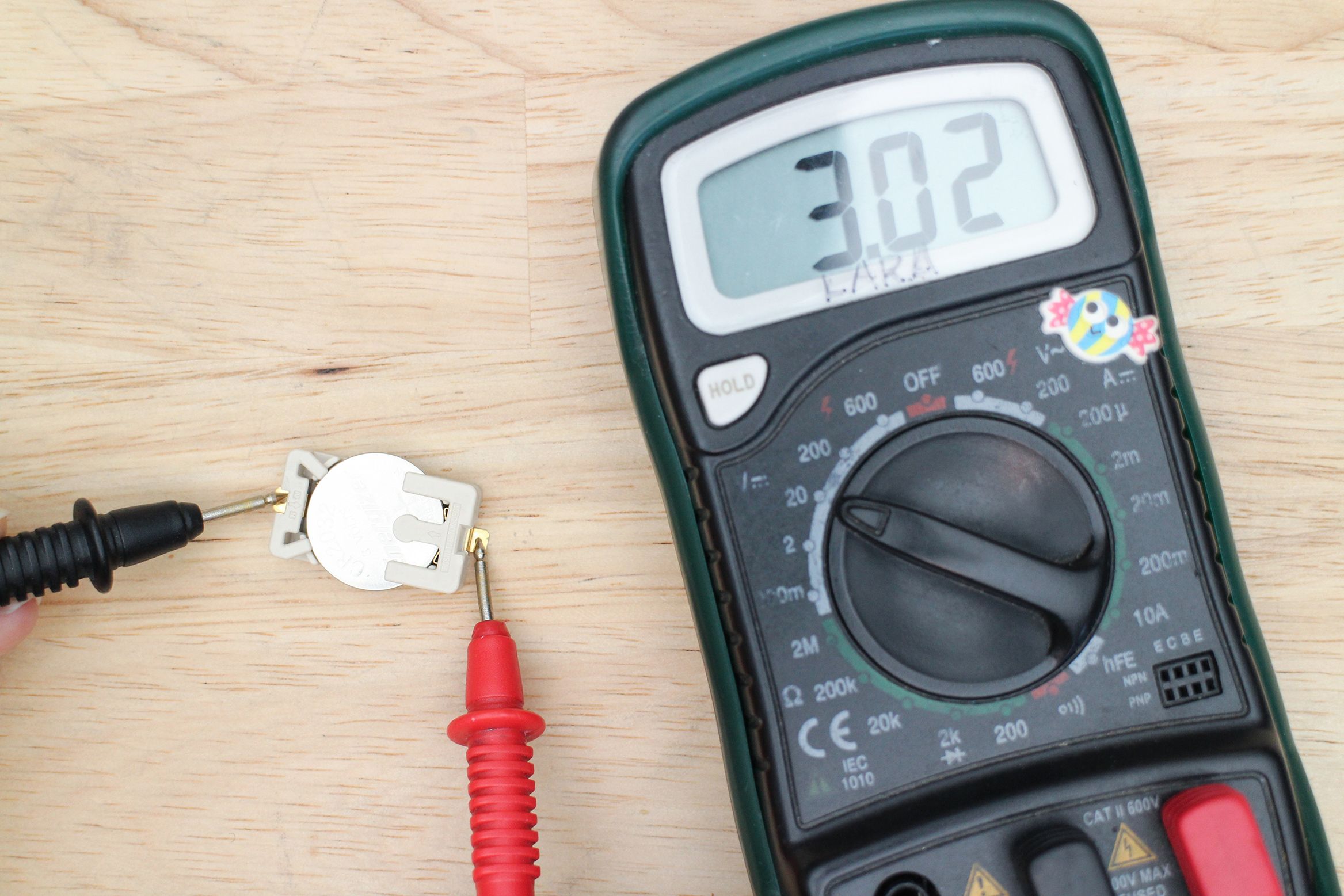

Measuring Voltage
With a multimeter, you will never have to wonder whether a battery is good or not again. You will be able to read how many volts are left. Turn the multimeter's dial to 20V, this allows you to measure up to 20 volts.
Pop the coin cell battery into the battery holder. Place the red probe of the multimeter on to the power tab and the black probe of the ground tab. Look for the "-" symbol to know which is ground, the "+" symbolizes which side is power. A number will climb on the multimeter's screen until it stops at the voltage provided by the battery. Sometimes batteries will have more volts than they are marketed to have. I've read as much as 3.2 volts coming from a fresh 3-volt coin cell before.

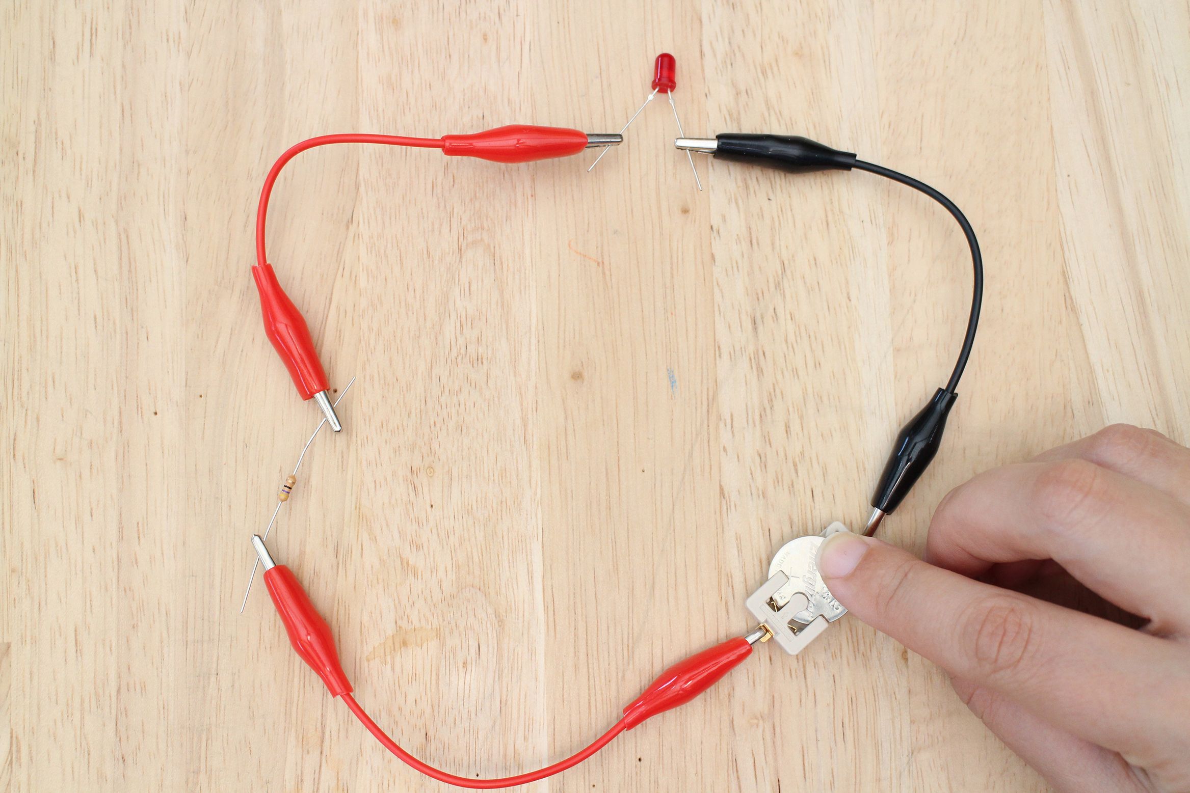

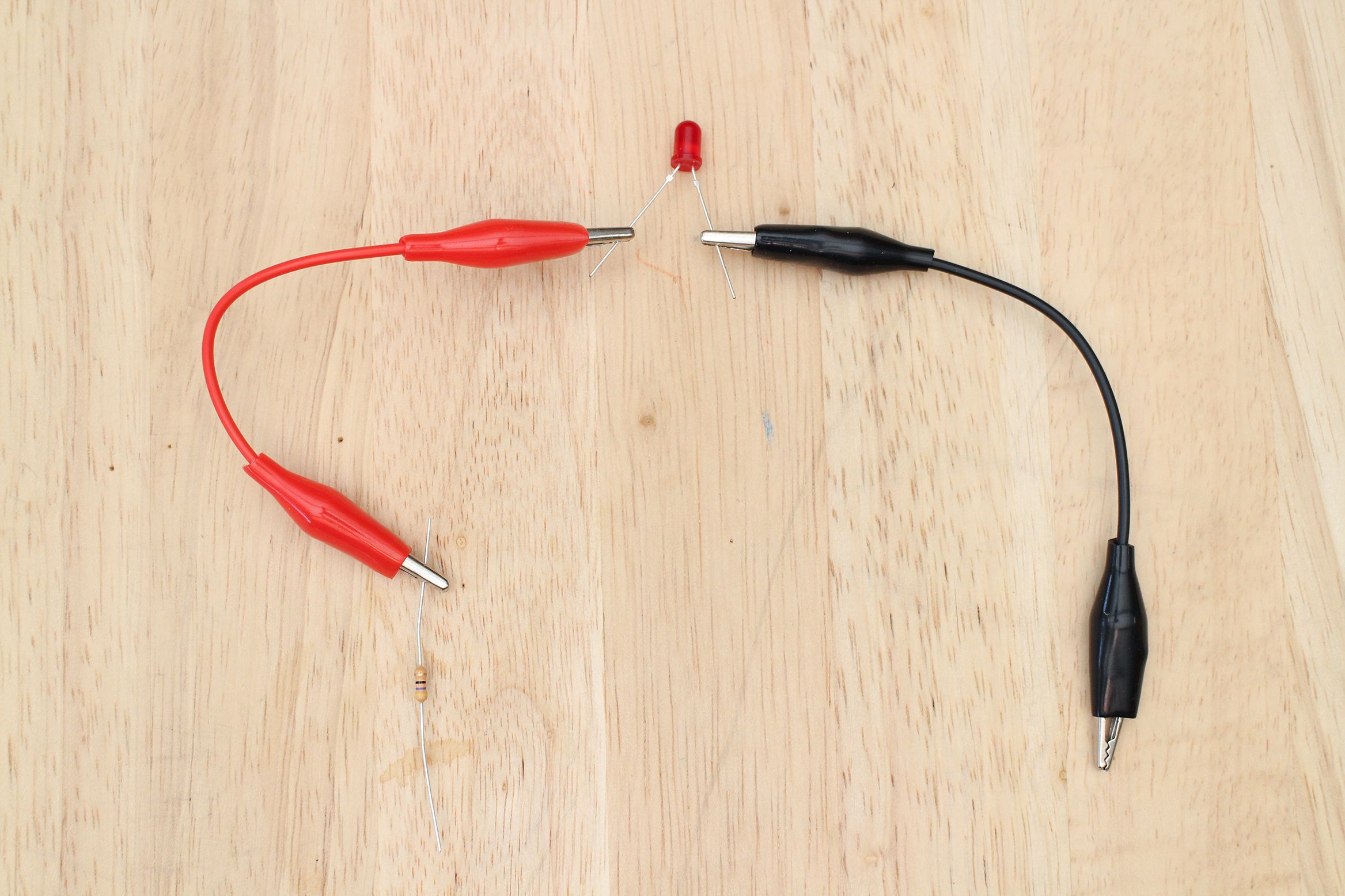

Step 8: Build the Circuit
Phew! You made it! Time to string your components together into a circuit. Grab some alligator leads. Here is your component list:
1 x LED
1 x resistor (value figured out using Ohm's Law)
1 x coin cell battery
1 x battery holder

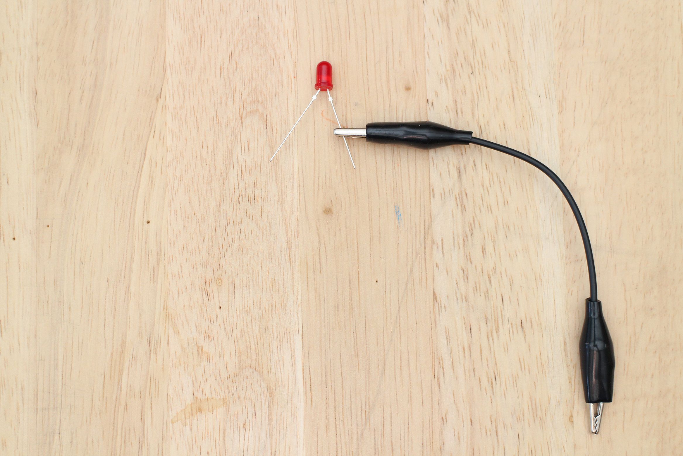

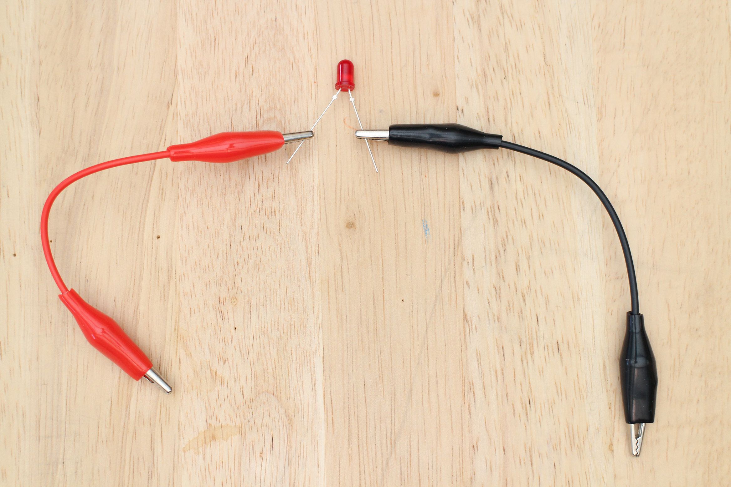

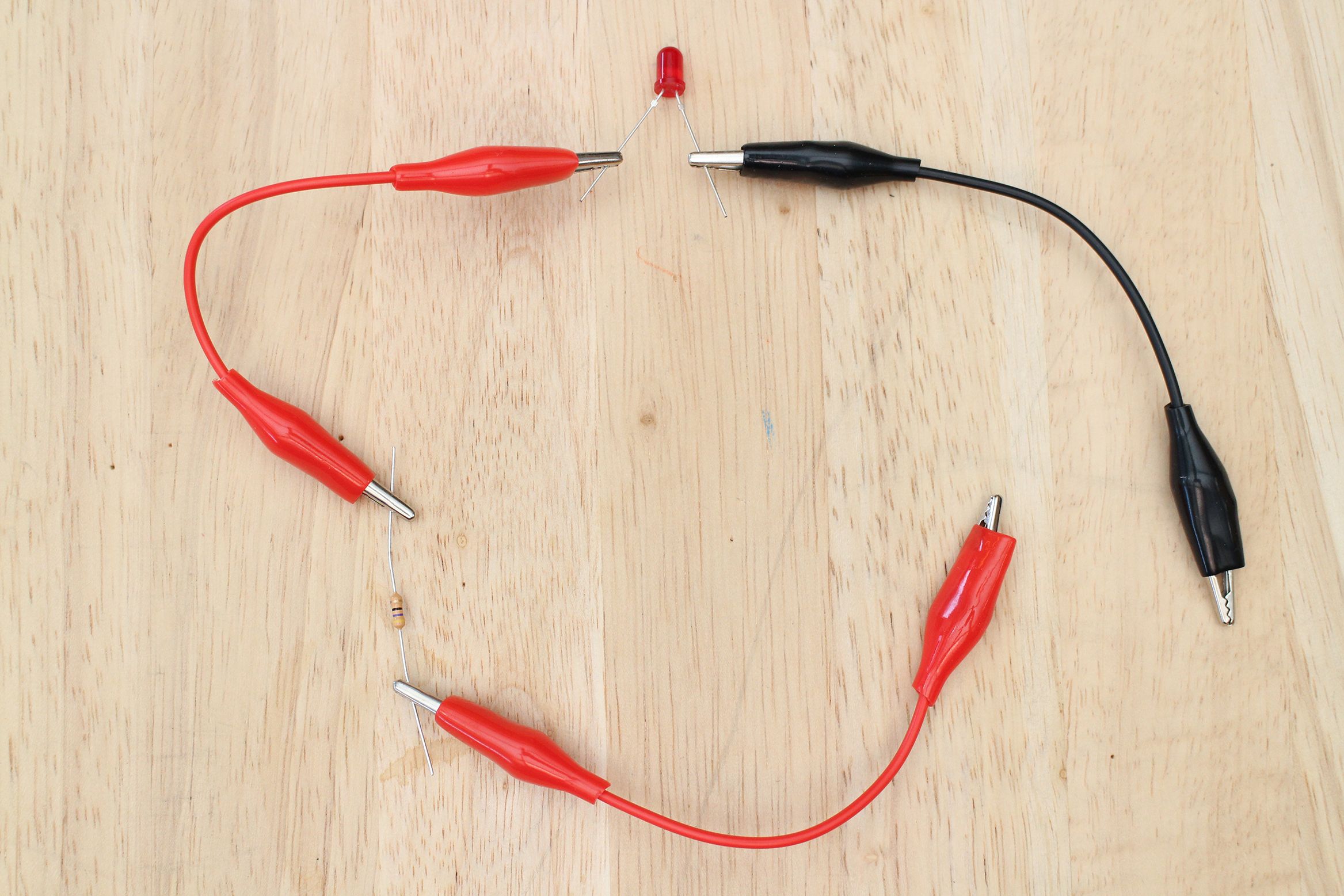

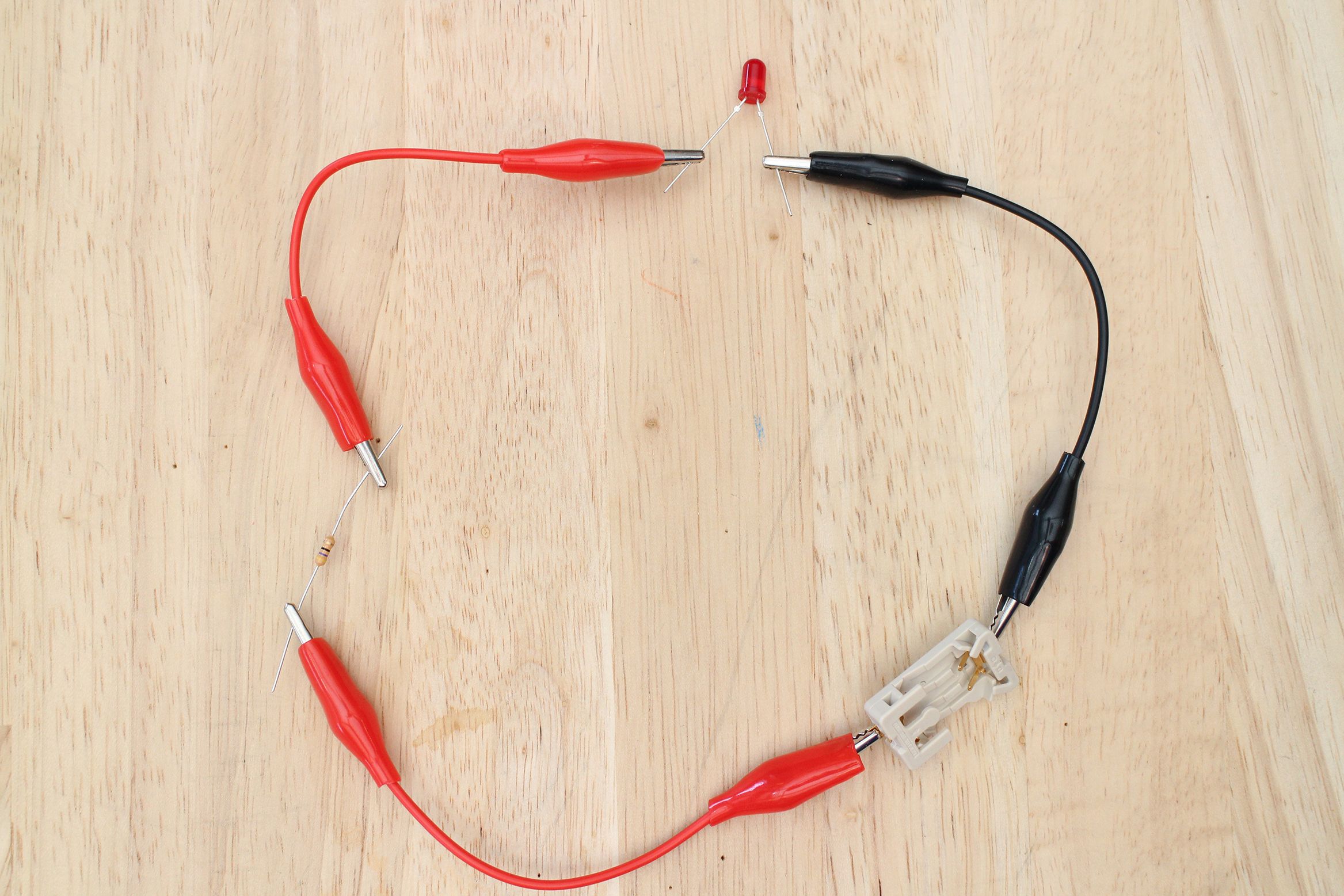

When building circuits that use low voltage batteries you use certain colors to indicate power and ground. Red is used for making connections to power and black is used to connect to ground. Components can be damaged or small shocks can occur if power and ground touch, so it's important to keep them clearly indicated. This also makes for easier circuit building when you need to find out what is grounded and what is powered quickly.
To identify which side of the battery is power and which is ground, look for the - and + symbols. They are small and embossed on the holder. Make these connections using the proper color of alligator leads.

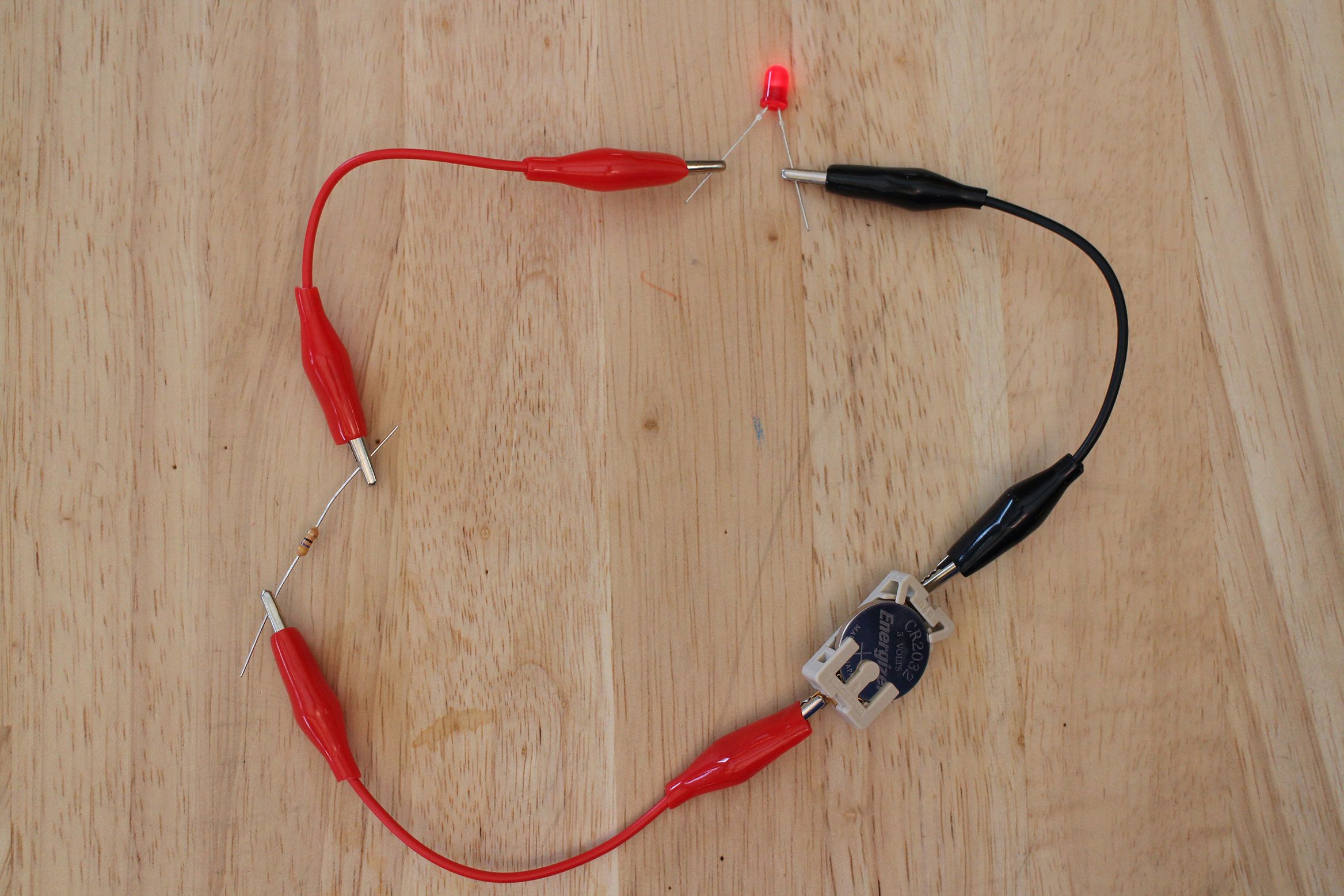

+ power lead of LED (long leg) to resistor
+ resistor to power (+) side of battery
+ ground lead of LED (short leg) to ground (-) of battery
Pop in the battery and the LED will turn on. Great job! You have built your first circuit.
