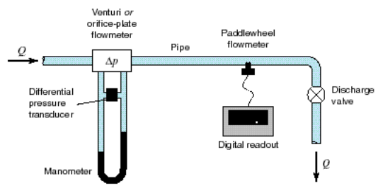

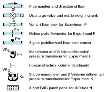

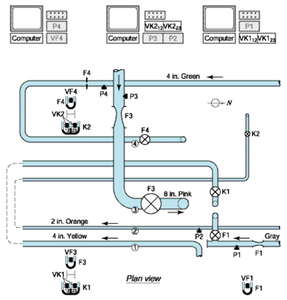

The first image details the plan view of your laboratory. The second image is a key for all symbols included in the first image. As you may see, there are four sets of experimental stations within your whole work station. We will be looking specifically at stations F-1, F-3, and F-4.
FLOWMETERS

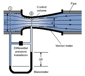

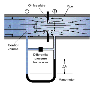

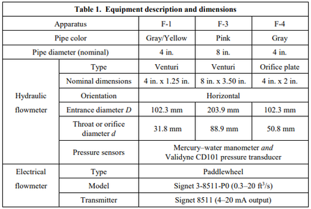

The next two images detail the Venturi flowmeter and the orifice-plate flowmeter, respectively, included in your work station. Both of these hydraulic flowmeters are fitted with a Validyne pressure transducer and a mercury-water differential manometer to measure pressure differences across each flowmeter. A Signet 3-8511-P0 “lo-flo” paddlewheel flowmeter is also used to measure bulk flow rate. The last image provides more detailed descriptions and dimensions of these flowmeters.

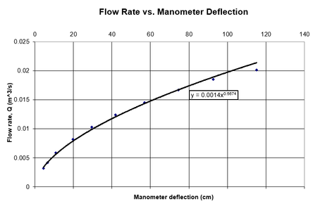

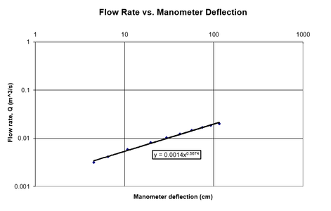

Data from station F-4 was recorded in the LabVIEW software to produce the four provided data plots. You will produce these plots with your own required data to perform data analysis on this lab experiment.
The first two plots exhibit the relationship between the bulk flow rates and their corresponding manometer readings. The first plot has linear axes, while the second plot has logarithmic axes. As you may see, the first plot exhibits a logarithmic relationship, and the second plot exhibits a linear relationship, meaning that the bulk flow rate and manometer height follow a power-law relationship.

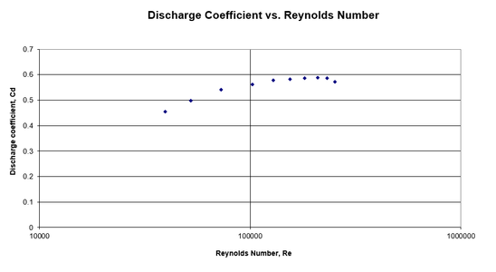

The third plot exhibits the relationship between the discharge coefficients calculated from each trial and their corresponding Reynolds number. This plot should be a linear-log plot.

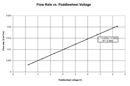

The fourth plot exhibits the relationship between each trial's bulk flow rate and the recorded paddlewheel flowmeter voltage. The fluid velocity through the paddlewheel flowmeter can be calculated by dividing the bulk flow rate by the cross sectional area of the pipe, the latter of which should be 0.0082 m^2. For example, the lowest fluid velocity tested through the paddlewheel flowmeter was approximately 0.304 m/s, and the maximum fluid velocity was approximately 2.448 m/s.

Ideally, the discharge coefficient should have a constant value of 1 at different Reynolds number values. However, the discharge coefficient is neither constant nor at unity. This is due to the fact that the discharge coefficient does not take into account the energy losses in the water flow, which are associated with viscous and frictional forces. Therefore, it is important to note that the bulk flow rate will not be constant due to these forces not being considered in our calculations, so flowmeter readings may not be entirely accurate.
The paddlewheel flowmeter also exhibited a very linear relationship between the bulk flow rate and its voltage readings, with an R^2 value of 0.9995. This relationship means that the paddlewheel flowmeter delivers very precise measurements and can be considered reliable. However, lower and higher bulk flow rates seem to cause the flowmeter to deviate from precision by a slight but noticeable margin. This can be attributed to the paddlewheels being immobile at lower flow rates and the flowmeters providing incorrect voltage readings at higher flow rates.
