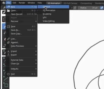

Start a new work by clicking on File, New, General. To create a new canvas.

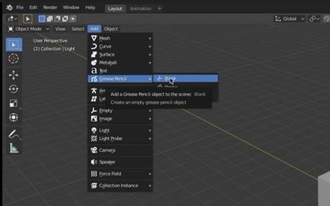

Make sure you are in "Object Mode", then proceed to click on: add, then select Grease pencil then click on the Blank option.

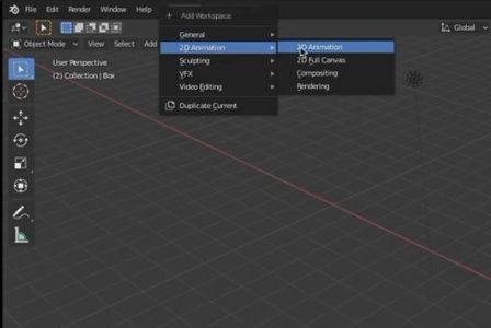

Now to start using our 2D drawing into a 3D space, first, we need to create a 2D space to draw on it. For that we need to create a new workspace on the top menu.
This new screen only appears if we open it with the Grease Pencil already selected.
This new screen will give you a brand new menu of tools.
Example of how it would look like:

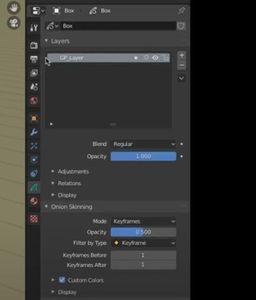

To start drawing we need to create a layer to draw. For this, we need to click on the icon that looks like green spaghetti. (check image 1 on step 7)

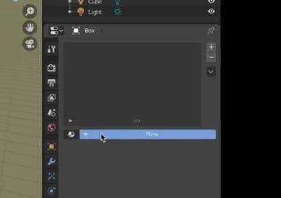

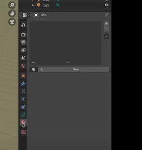

Now to create our palette of colors to use in this new layer, we need to go "Material Properties" which looks like a red circle. (check on image 2 on step 7)
Then click on "new" to create a new color. (check on image 3 on step7)
You can even rename it as you prefer.
Down you will notice there is an option to change the color too. (check on the last image of step 7)
