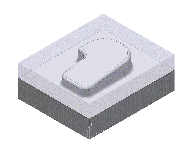

  • Open PowerMill, import instructables model into PowerMill

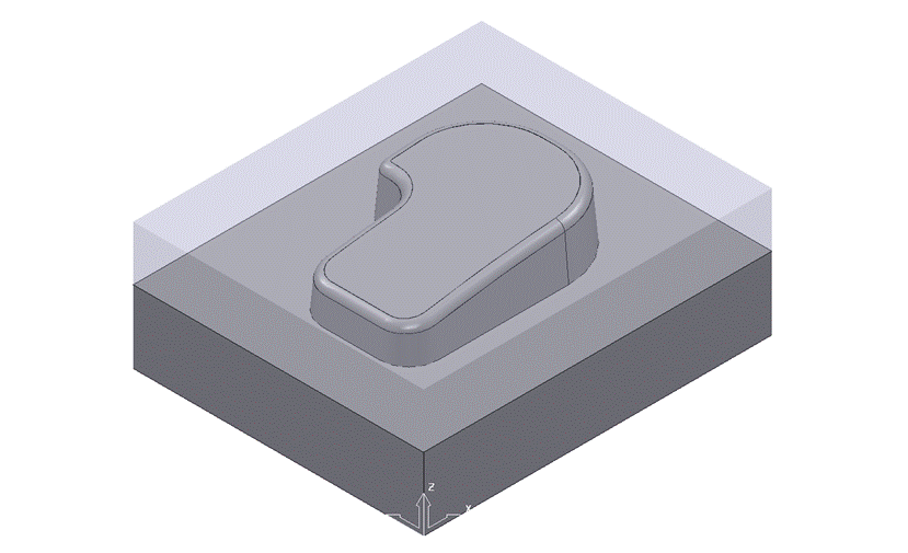

We need to create a block to machine our part from.
  • Select the block option from the home tab
    • Calculate the block size and apply

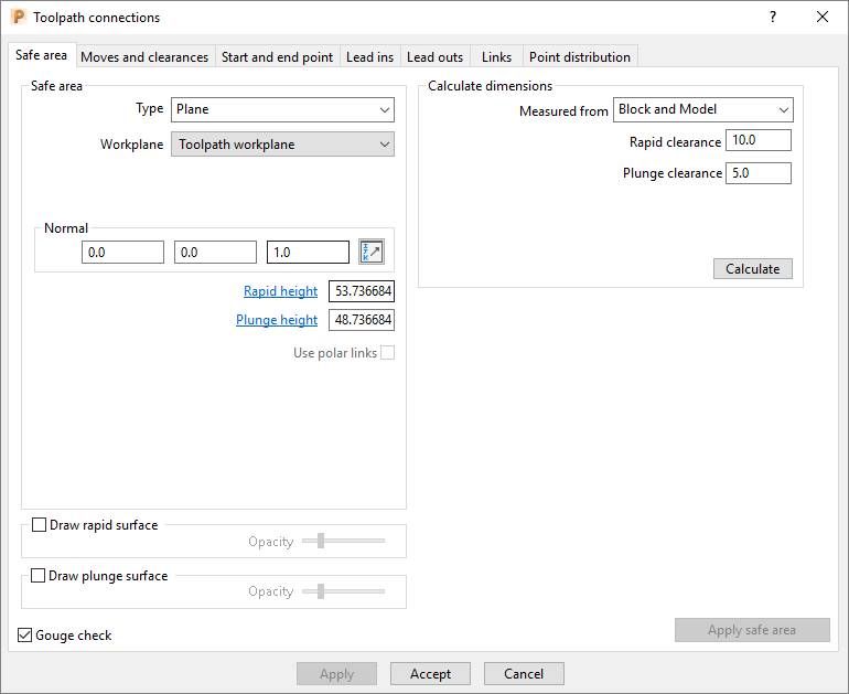

Calculate the toolpath safe area:
  • Open the toolpath connections dialog from the home tab
    • Select calculate on the right-hand side of the dialog box for safe area
    • Apply the changes and close the dialog
With our model imported, block set up, and toolpath connections calculated, we are ready to begin programming!

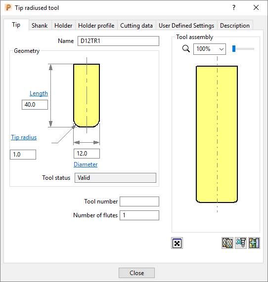

First, we’ll create a tool for the roughing pass
  • Create a Tip Radiused Tool
    • Length: 40 mm
    • Diameter: 12 mm
    • Tip Radius: 1 mm
    • Name the tool D12TR1 and close the tool dialog

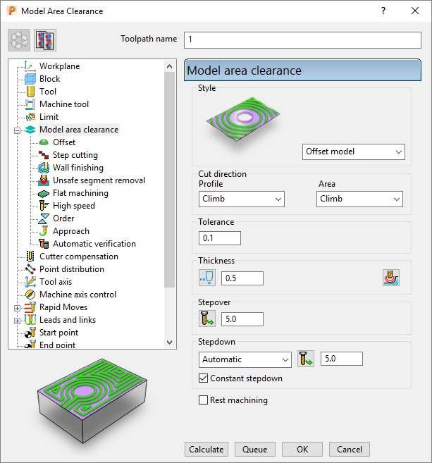

Now that we have our tool for the roughing pass, we can create the necessary toolpath
  • Create a Model Area Clearance strategy and name it D12TR1-RGH
    • Offset Model
    • Thickness: 0.5 mm
    • Stepover: 5 mm
    • Stepdown: 5 mm

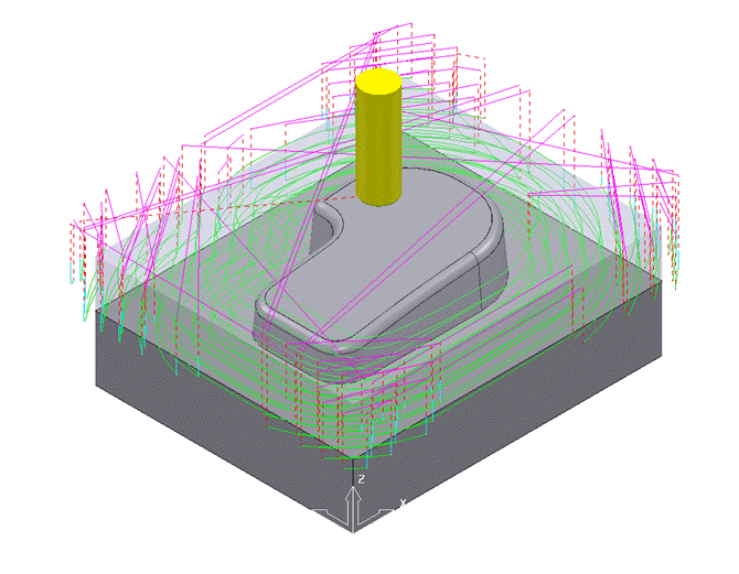

  • Calculate the Toolpath

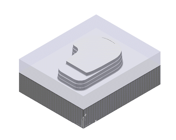

  • Run a ViewMill simulation of the roughing pass.
    • Right click on D12TR1-RGH and select simulate from start. Click the red circle in the ViewMill section of the simulation ribbon to turn on ViewMill.
    • Click the play button to run the simulation
With our model roughed, we are ready to finish programming the model by adding a finishing pass.
