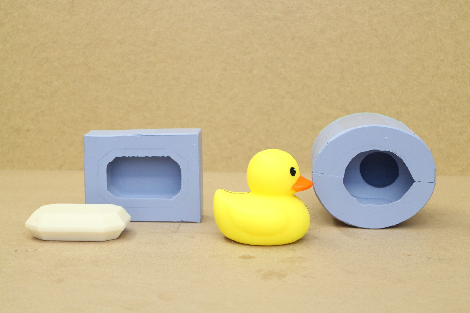

While there are a variety of mold making techniques to accommodate the MANY different model types, mold materials, and casting applications, we will focus on three of the easiest and most commonly used mold types in this class and all the making techniques that go into each one:
- Simple one part mold – for models with a flat back and no undercuts
- Flexible block mold – for 3D models with undercuts
- Two part mold – for models with challenging shapes and undercuts
Lesson 3: Simple One Part Mold - casting a rhinoceros ice cube!
Lesson 4: Flexible Block Mold - casting custom soaps!

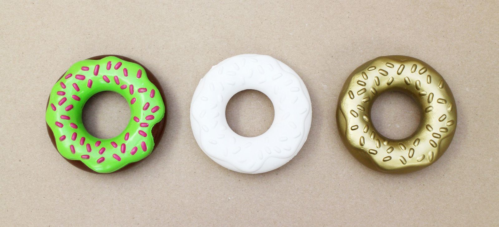

L to R: donut model from Lesson 5: 2-Part Molds, plaster cast of model, finished spray painted cast

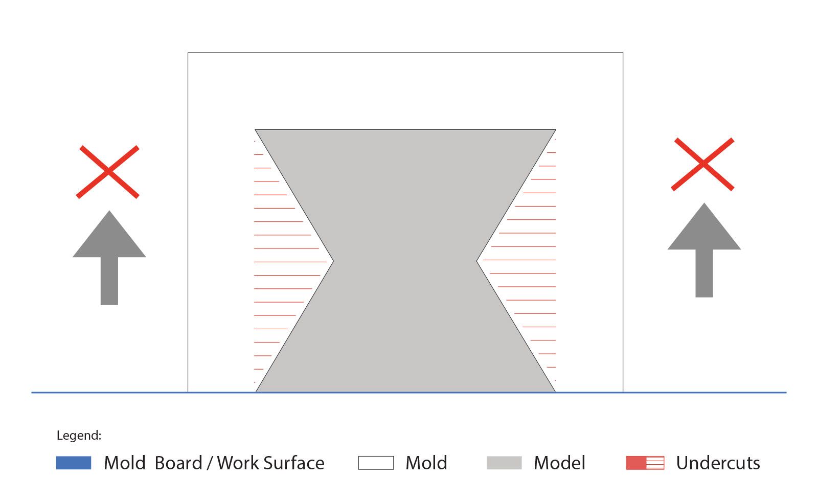

An undercut is a protruding or indented area of a model that prevents the easy and safe removal of the model (and therefore cast) from the mold (see examples in illustration above). These are important to be aware of when determining the type of mold making technique to use and the level of casting difficulty of an object.

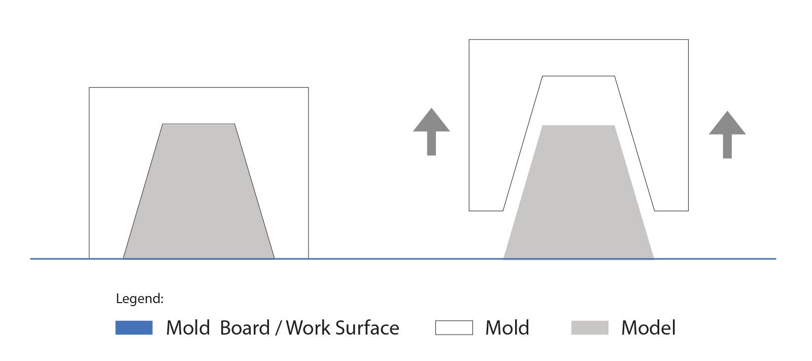

As an example of a model with no undercuts, a simple cup (conical) shape is well suited to an open faced, one part mold because it has nothing obstructing it's easy removal (I demonstrate this mold type in the Simple One Part Mold lesson).
Something with a peanut shape would be prevented from coming out of a one part mold due to its 'waistline' or undercuts. This shape would require a more complex mold type like a cut flexible block mold (see Flexible Block Mold lesson) or a two part mold (see Two Part Mold lesson).
IMPORTANT NOTE: When making molds, small undercuts created by surface relief details (like canvas fabric texture for example) aren't an issue if you're using a flexible mold material like RTV silicone or urethane rubber. Though, if you're using a more rigid material for your mold, like plaster, and a rigid model, even the smallest undercut can be an issue when it comes time to remove the model from the mold. It will get hung up on the undercuts and can only be removed by breaking the mold.
