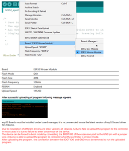

Step 1: Installing ESP32 Board in Arduino IDE and Booting the Device
  • Install the ESP32 Wrover board in your Arduino IDE to start programming the device as shown in the image.
  • ESP32 board must be installed under board manager, it is recommended to use the latest version of ESP32 board driver for Arduino.

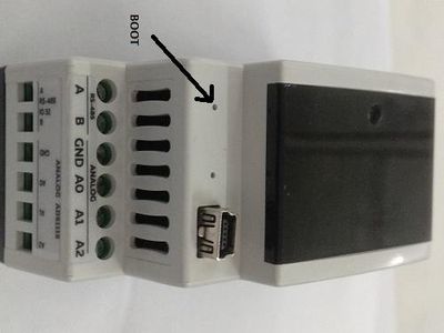

  • Due to the installation of different drivers and older versions of libraries, Arduino fails to upload the program to the controller. In most cases, it is due to failure to enter the boot mode of the device. After uploading the program the device can be booted by pressing the boot hole using a pin.

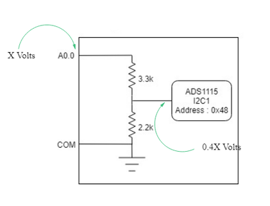

Step 2: Understanding More About the Analog Inputs.
  • The device has a ADS1115 module of address 0x48 .
  • ADS1115 is a 16-bit analog to digital converter (ADC) that consists of four analog channels. Here in the device, the last three (channel 2, channel 3 and channel 4) channels of the first ADS1115 module used as analog inputs, to measure the input voltage.
  • The GPIOs, 21(SDA) and 22(SCL) of ESP32 in the device are used for I2C communication with the ADC. This ADC module is capable of measuring a maximum voltage of 4.0V. Considering this into account and to facilitate measurement of maximum 10V, the above arrangement is made inside the device using resistors, as shown in the figure.
Hence it is to be noted that the value read by the analog channels of the ADC is 2.5 times smaller than the actual analog input reading at the analog input pins A0-A2.

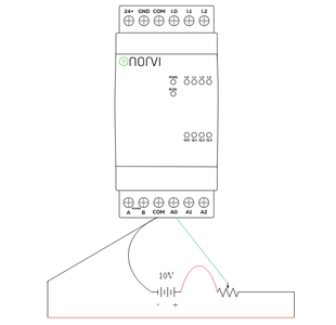

Step 7: Circuit Connection and Verification
  • Complete the circuit as shown in the diagram. Then upload the sketch and boot the device.
**Norvi Agent One AT01-BM1 is capable of reading 0-10V industrial level voltages.
  • By varying the potentiometer value, you can see for the chosen voltage range, the respective color is being displayed inside the device.
