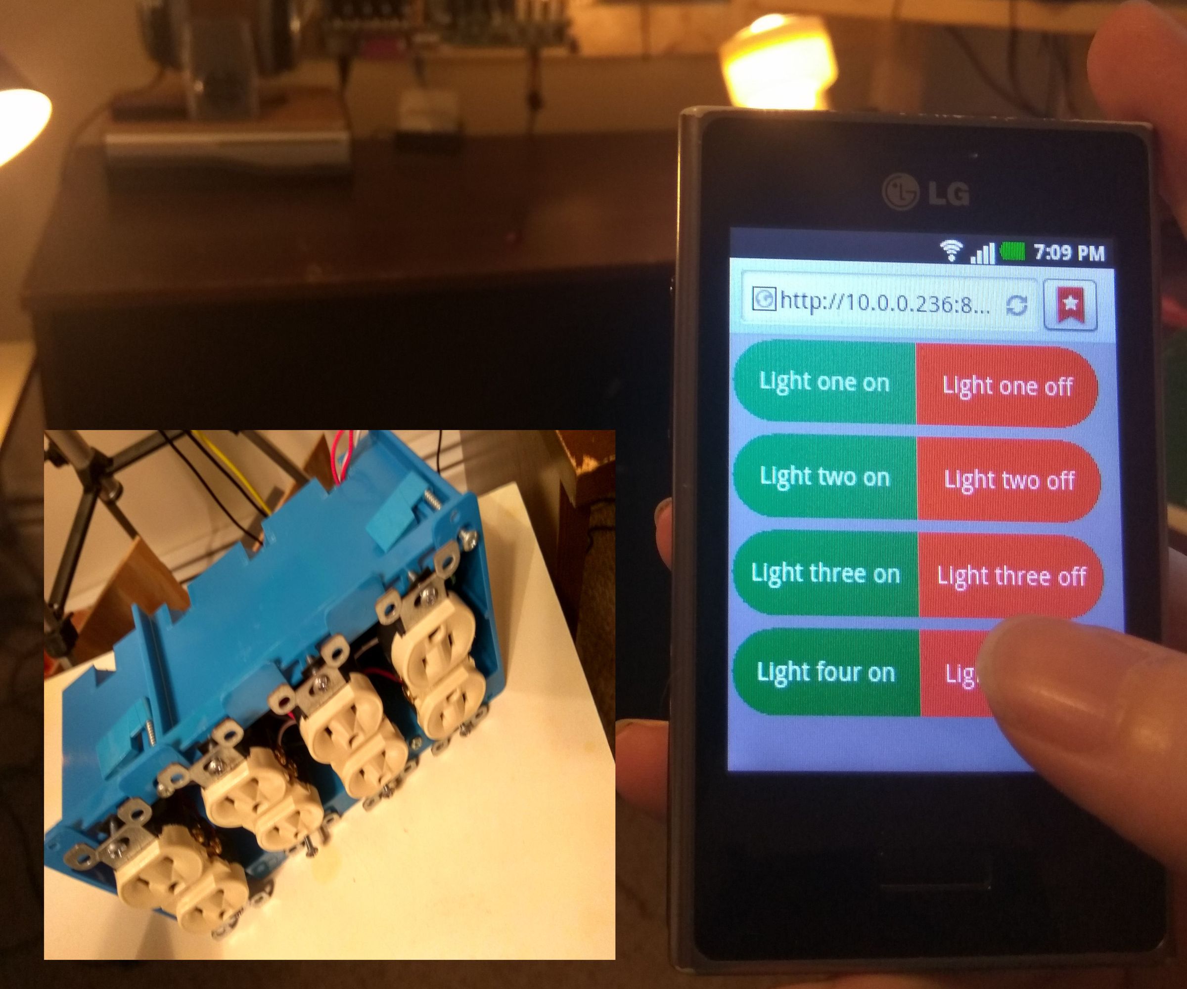

I hope you enjoyed this tutorial. In it you have learned how to install Pocketsphinx the Open source STT Toolset, and also how to utilize some of it’s capabilities using Python. Please feel free to use the code in ‘helperScripts’ to build your own projects and show them off. I've attached a video and linked one of me making a small modification to the voice assistant script to control my web-app controlled lights which you can figure out how to build in my other instructable:
https://www.instructables.com/id/Web-app-Controlle...
