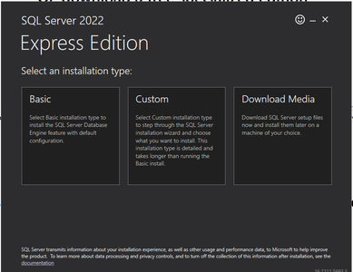

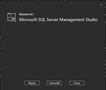

To set up SQL server, start by downloading the database engine at the following link: https://go.microsoft.com/fwlink/p/?linkid=2216019&clcid=0x409&culture=en-us&country=us. Open the downloaded file click "Install" and then select "Basic." next, download the management studio from this link: https://aka.ms/ssmsfullsetup, and use the downloaded file to install. Once both of the files are installed, open SQL Server Management studio, and in the box, check "Trust Server Certificate." Then you are into your SQL server.

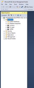

To start using SQL server, you need to understand how it works. You can have 1 SQL Server per machine (real hardware or virtual.) In each SQL server, you can have multiple databases. these databases contain tables. The tables are like Excel spreadsheets. You can have columns and in the columns, you can have rows of data. To start, you will need to create a database. on the top bar, click "New Query" (You can use the above photos for help.) This will open up a text editor, and this is where you will write SQL code (or queries) to perform actions on your SQL server. To create a new database, type the following: CREATE DATABASE [Your database name]; So if my database was called "Test," I would type CREATE DATABASE Test; Now click execute at the top and wait a few seconds. Now reopen SQL Server Management Studio and you should see your database under the databases folder on the left. Expand your database and expand the "Tables" folder under it. To create a table, type:
