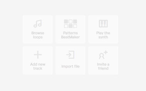

Soundtrap organizes all the sounds in your project as "tracks," which will appear as separate lines across the screen. Think of your project like a sandwich of sounds, with tracks layered on top of each other. The quickest way to start a new project is to start a new track by clicking on the “Add New Track” tile in the empty workspace. You can also add a new track by clicking on the plus sign (+) labeled “Add New Track” to the left. A pop-up will appear with different instruments to choose from. We’re going to start by selecting “Drums and Beats.”

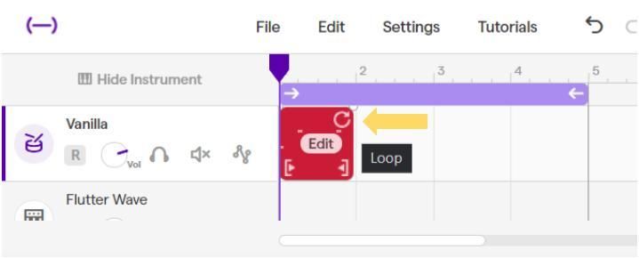

To make a simple rhythm, try putting a kick on the 1st and 3rd beats and a snare hit on the 2nd and 4th. After creating your rhythm, you should see a bubble in the drum track line. You can use the loop tool (different from Loops) to repeat your rhythm as long as you need. The loop tool can be found by moving your cursor over the top-right edge of the audio bubble. Click and drag to the right to loop your audio. This is useful for when you have a repetitive beat or melodic line; you record once and then you can loop it out as far as you need. Listen to how your beat sounds by clicking the Play button on the bottom.

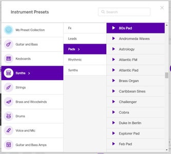

Once you’ve practiced creating rhythms and using loops, try your hand at creating your own loops with Soundtrap’s instruments! The process is similar to adding loops or a rhythm with the beat maker; create a new track and choose what kind of instrument you want to play. Within each instrument category, there are even more choices. Click on the instrument’s name to open a menu with more instrument options (GIF of selecting new sound for Instrument).

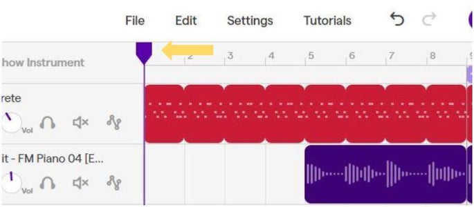

After some practice, try recording! To do so, make sure the playhead is placed where you want the recording to start (pic of playhead). Next, click on the Record button to begin. You should see a countdown, which will be the same tempo you’ve chosen for your project and is designed to help you feel the beat before playing. After the countdown, you will begin playing. Once you have finished recording, you can use the Stop button or the Spacebar to stop recording. Next, you should see your recording show up on the track. If you need, you can delete the recording, move the playhead, and try again.
