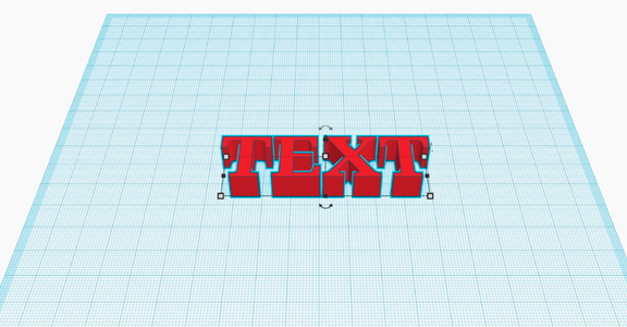

Step 2: Add "TEXT"
Click, hold, drag, and release the "TEXT" onto your workplane
Step 3: Change the "TEXT"
in the menu to the right that appears when the "TEXT" on the workplane is selected, change the "TEXT" to your name

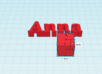

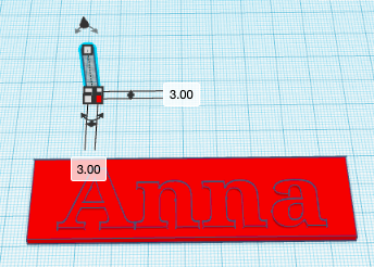

Step 4: Add a Box
Click, hold, drag, and release the box in front of your name on the workplane.
Step 5: Changing Heights
When you click on the white square on top of the 3d figures, you can change the height of the 3D figure either by the click-hold-drag-release or clicking the number signifying the height (normally in millimeters) and typing in the desired number. Normally for speedy printing, 3 mm for the name and 2 mm for the rectangular prism works best. Click and drag the rectangular prism covering an area bigger than your name.

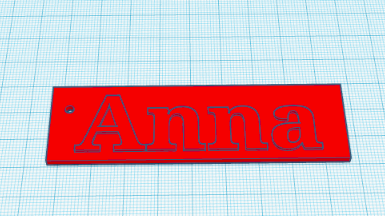

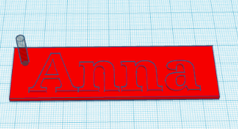

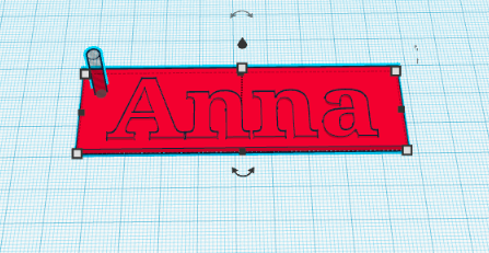

Step 6: Make a Hold for a Keychain
Click-hold-drag-release a hole cylinder on your workplane. Change the diameter to 3mm. Move it to a spot on the rectangular prism.

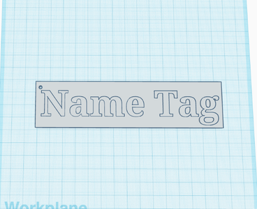

Step 7: Group
Select all the items and group them.
