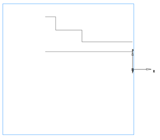

  • Use the ‘Connected Line' line constructor to sketch an outer profile of the part, this will be used to create the turning feature.
  • Now use the '2 Points' line constructor https://www.instructables.com/files/orig/FXG/PLIC/J1QP3J7D/FXGPLICJ1QP3J7D.pngto create a single line to define the outer diameter of the bore.
  • Use the ‘Connected Line' line constructor to sketch the cross section of the groove.

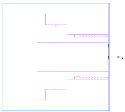

When you are done, your features should look similar to the features shown below.
With all the features needed to machine this part created, we are ready to simulate our results, and revise from there.
