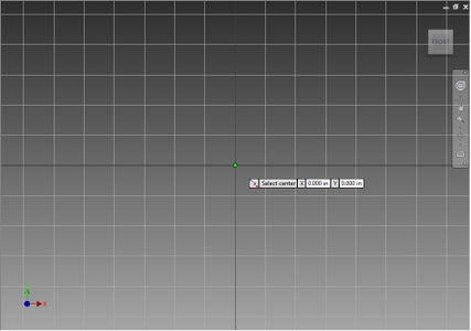

Step 4: Create a Two Point Center Rectangle
Select the origin as the center point of your rectangle.

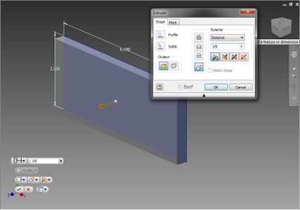

Step 6: Give It Some Thickness - Extrude
Select "Finish Sketch" and select "Extrude". Input the thickness as .375 or 3/8 in the distance input and select "OK"

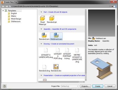

Step 8: Create a New Weldment.iam
Create a new standard "Weldment.iam" file.

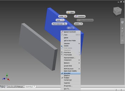

Step 12: Ground It
Select one of the components, right click and select "grounded" to ground the component. Grounding restricts the motions of the component.

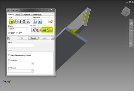

Step 14: Flush Constrain
Select the "Flush" constrain option and select the face shown. When complete select "Apply" and move to the next step.

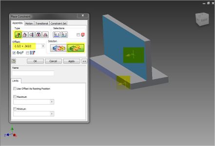

Step 15: Center Plate Using Flush With Offset
Center the plate using the "Flush" constraint and an offset. Select the face as shown and input the values as shown in the "Offset" box.

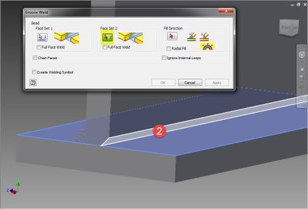

Step 19: Groove Weld Face 2
Select "Face Set 2" and select the face shown in the figure. Once complete move to the next step.

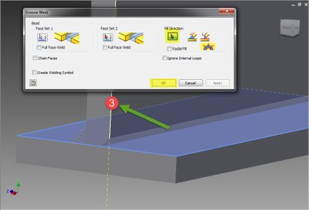

Step 20: Groove Weld 3
Select the "Fill Direction" button and select the edge as indicated by the figure. Once complete select "OK".

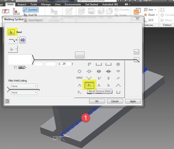

Step 21: Create Welding Symbols
Select the "Symbol" feature to create welding symbols for the weld we have just created. Select the fillet weld bead from the screen and input the size as shown. Once complete select "Apply" and move to the next step.
Step 22: Symbols 2
Select the "Bead" button to select a new bead for symbol creation. Select the groove weld bead and change the symbol from a fillet to groove by selecting the fillet symbol in the weld symbol detail. Select "OK" once completed.
