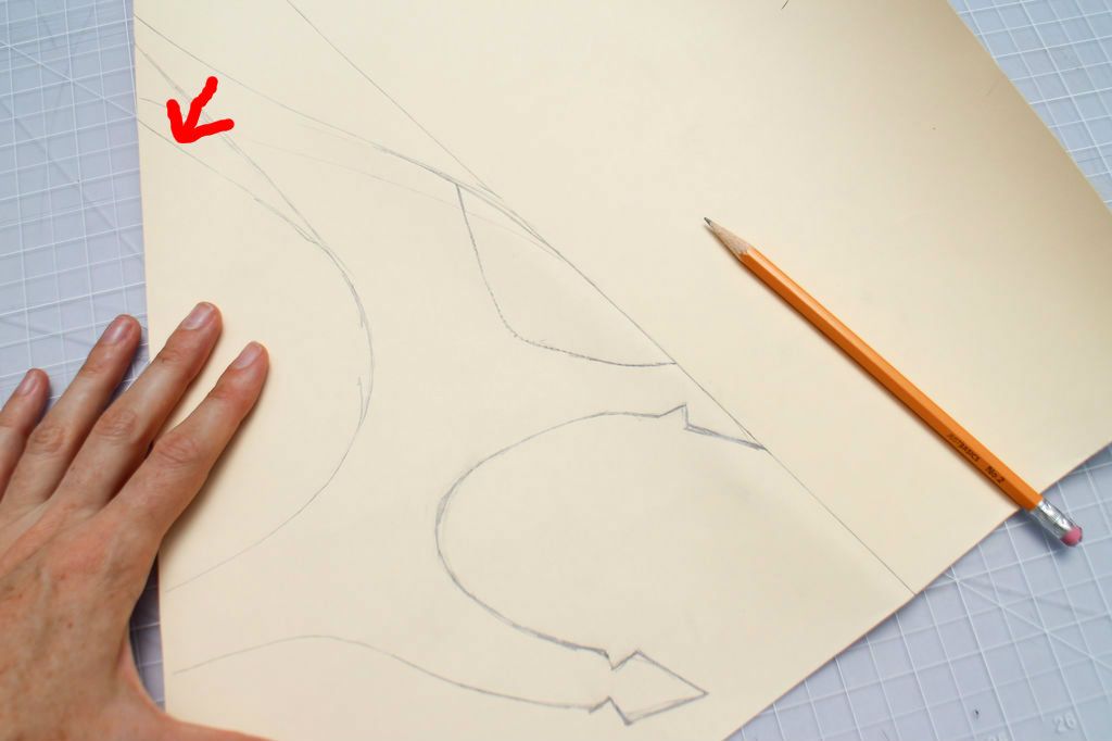

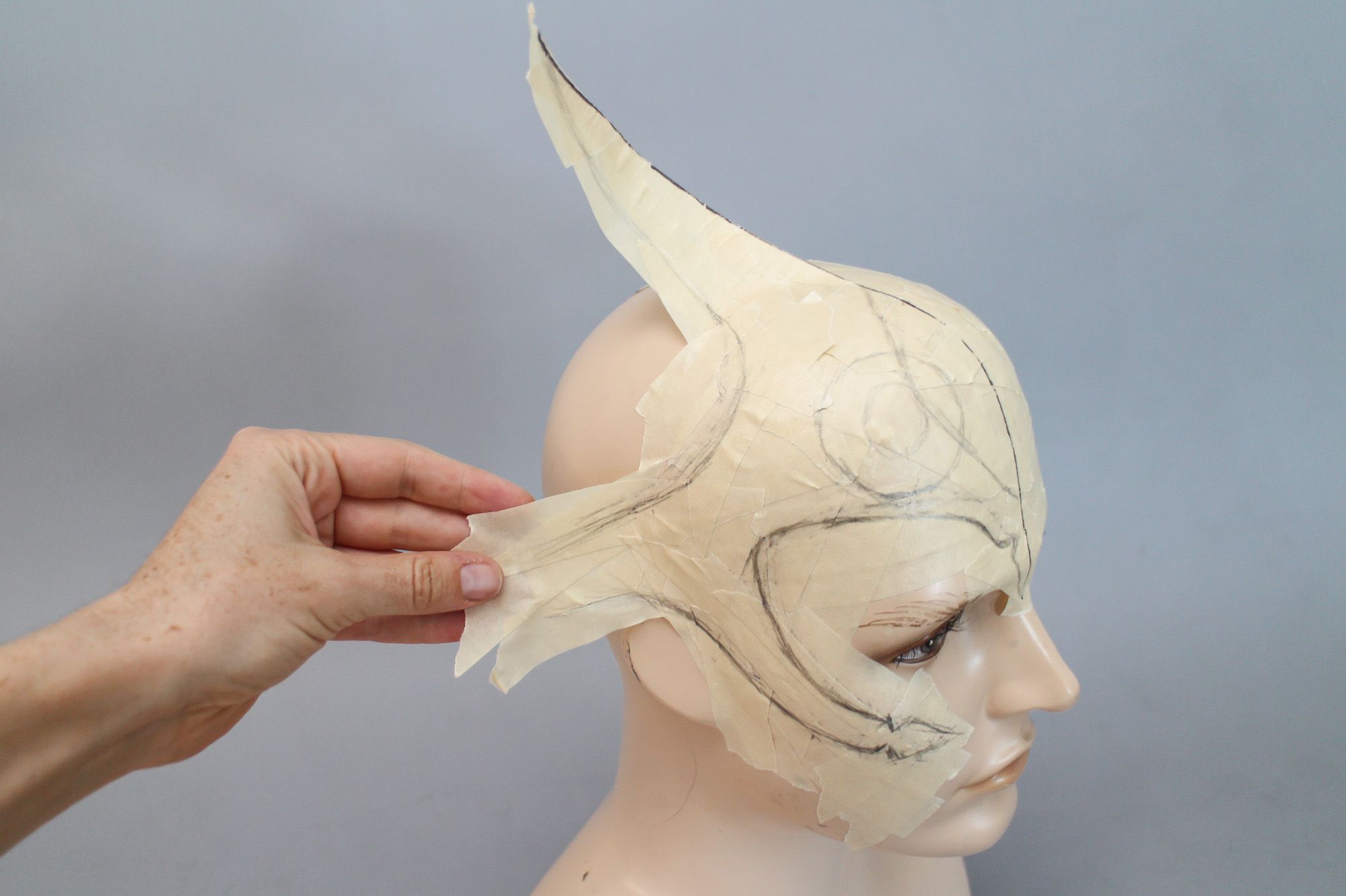

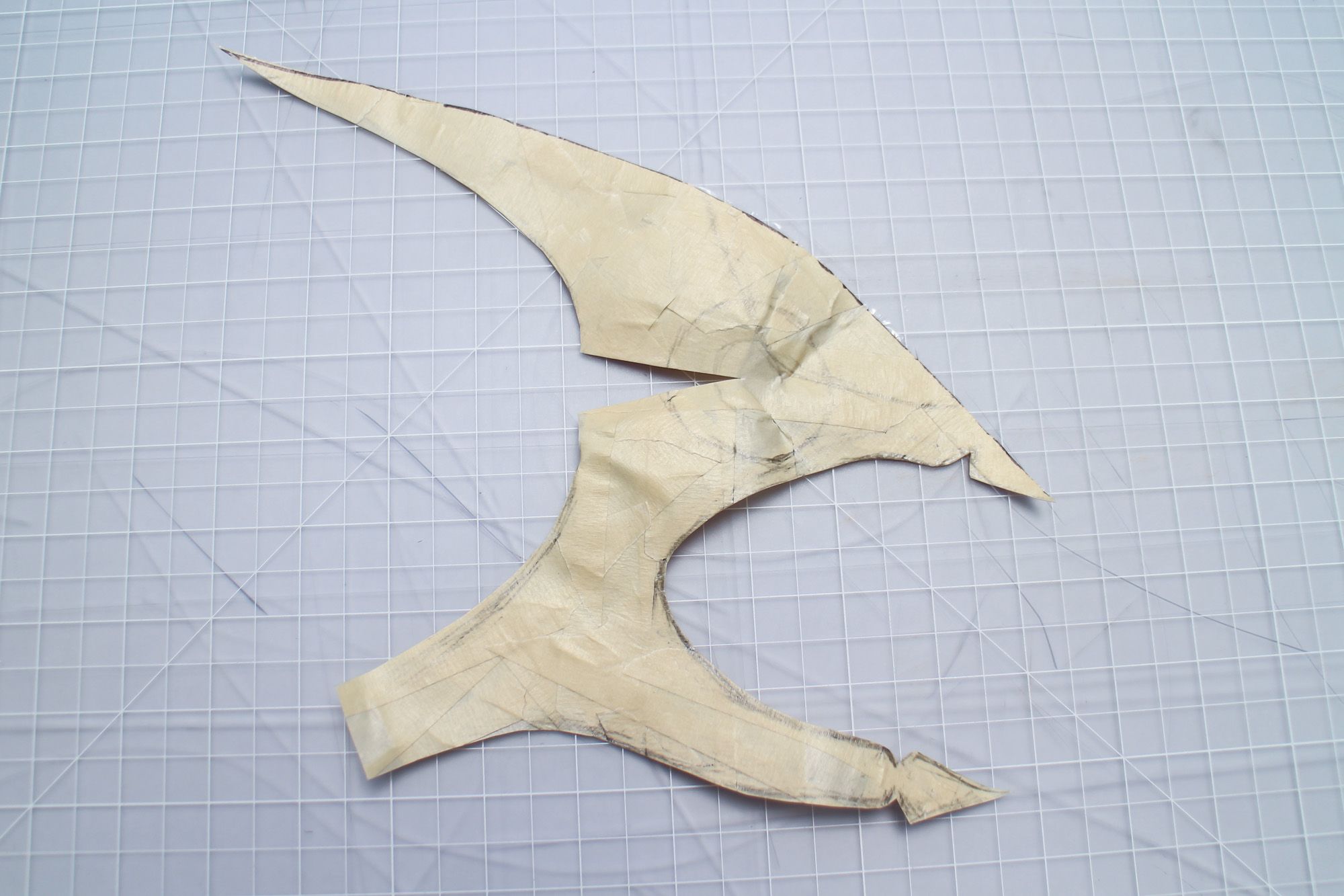

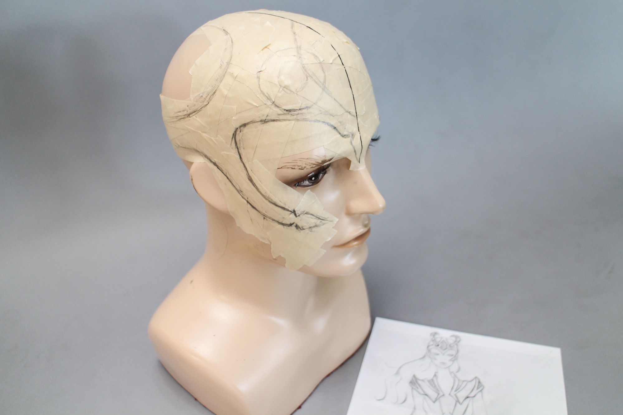

Just like with EVA foam, the first thing you need to do when working with Worbla is make yourself a pattern. The method of patternmaking you use will always depend on what you're going to create and how it needs to fit on your body. If you are making a larger piece like a breastplate or shoulder piece the methods I discussed in the foam lesson could just as easily be used here, but I'm going to show you another great method that works really well for headpieces like the one I'm making.

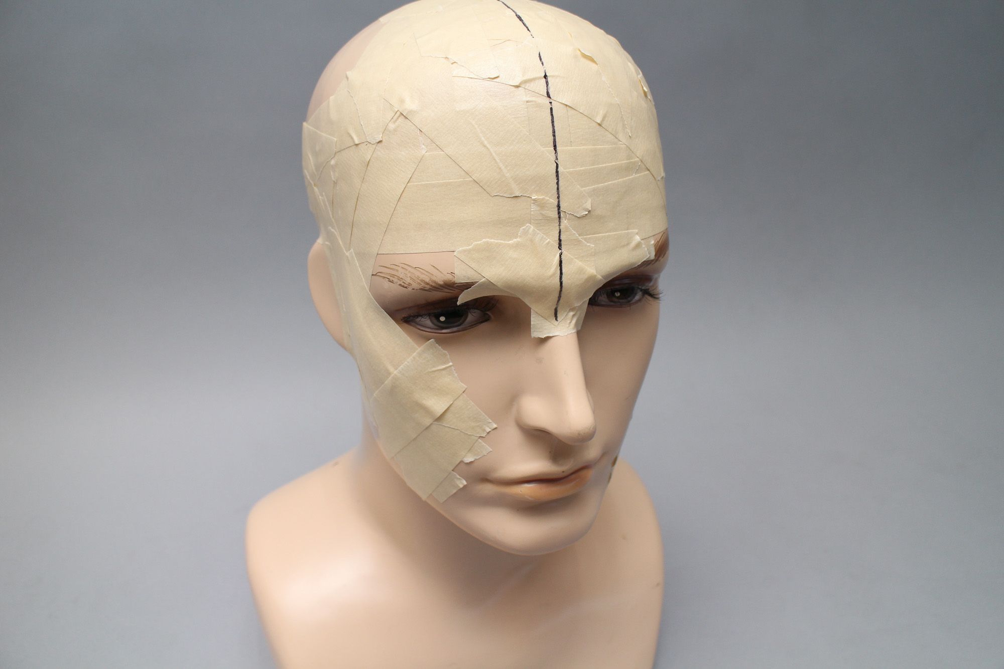

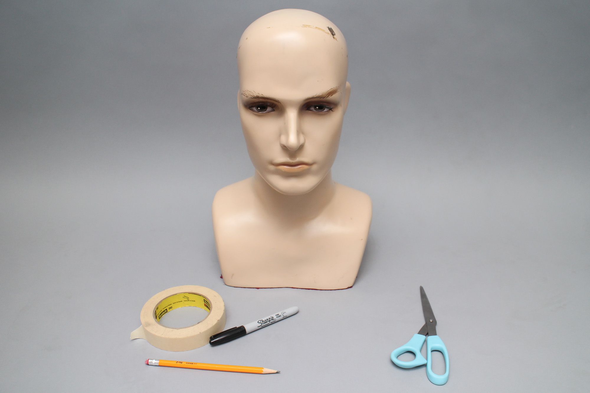

I used this method on a head form because I happened to have one, but you could also do this on yourself by wrapping your head in plastic wrap and covering that with masking tape in strategic places (being careful not to suffocate anyone, by covering the mouth or nose, and using extra caution if you're working with kids). Head forms are great tools though, and you can usually find them fairly easily and cheaply online or at a wig store (I think this one was $15).
I covered my head form with tape masking tape, and drew a line down the center of the head.
Then, referring to my sketch, I drew the shape of my headpiece out on top of the tape on one side.
I took the tape off the head and cut out the pattern. I also cut a slit in the pattern to allow it lay flat.
As it was, this pattern was going to require three darts to create the shape I wanted, one at the top of the head, and one on each side where I cut the slit. Worbla can mold around compound curves but I wanted to use some EVA foam as well in the base of this headpiece, so I knew I couldn't rely too much on compound shaping. However, I didn't really want a dart in the final piece where I had cut the slit, so when I traced the pattern onto paper I decided instead to rotate the point at the top of the head down a little making the dart at the top of the head larger while eliminating the two side darts.
This is a patternmaking trick a bit like the one I used when I moved the sleeve seam of the bodysuit down. As long as the volume of the dart is going somewhere, you can often move it around to suit your design vision.

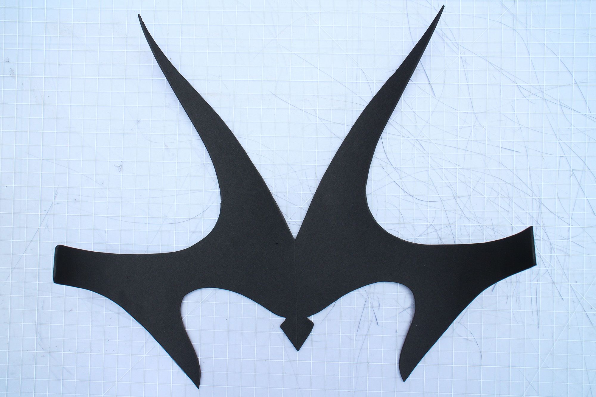

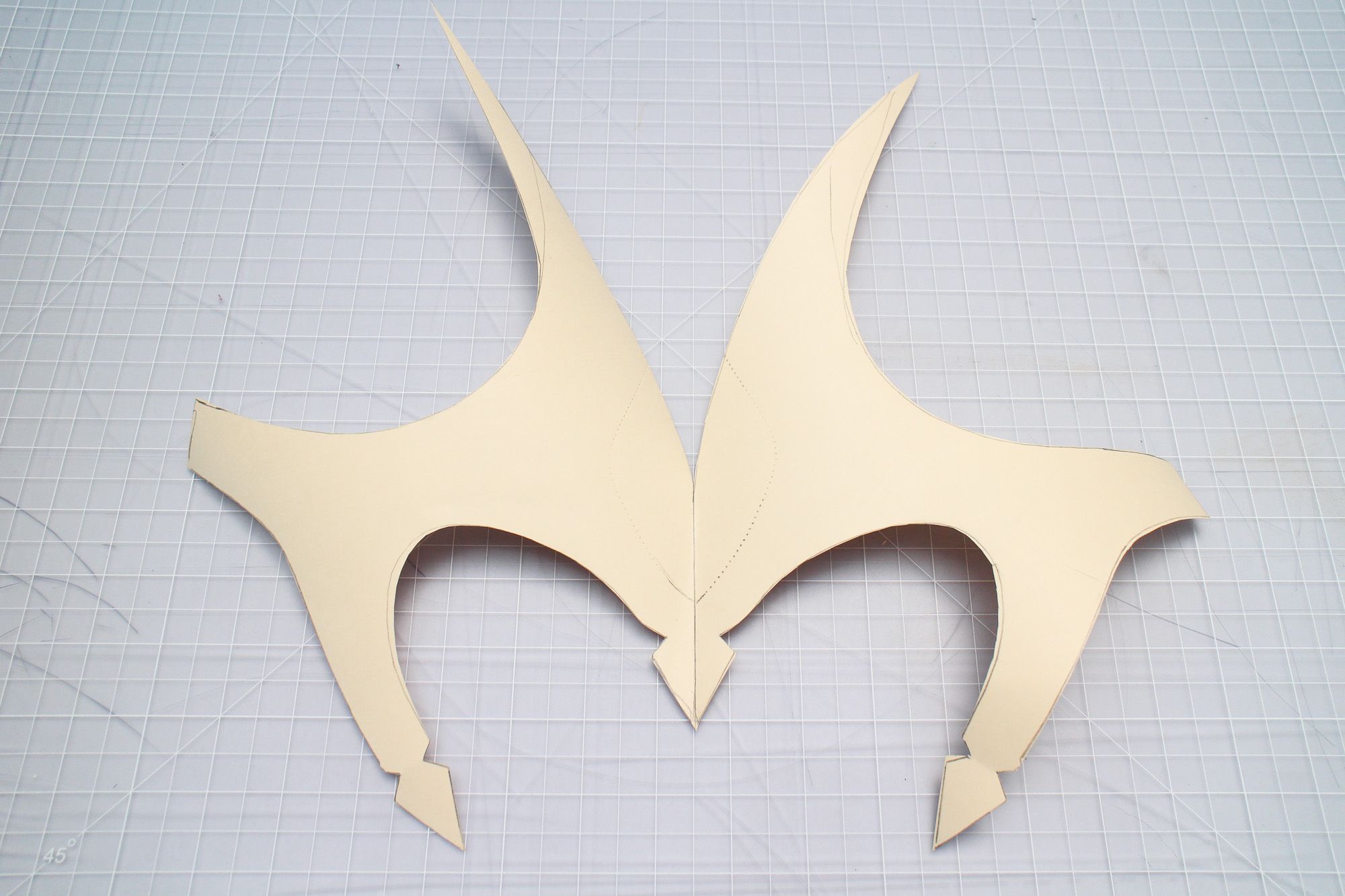

Once I had revised the pattern, I mirrored it to create the other side, then cut it out and tried it on my own head to see how it was looking. I altered it a bit, for the shape of my face, and decided that I didn't like the arrow points at the ends of the pieces extending over the cheeks, they looked a little weird so I eliminated them. I think it's really important, and sometimes hard, when you're creating to accept when something isn't working and be willing to change your design - but you're a superhero, be brave!
I made sure the bands extending over the ears were long enough to curve around the back of my head a little, and I marked little slits in the end of each that would allow me to add an elastic attachment. Now I was pretty much ready to cut and sculpt with Worbla!

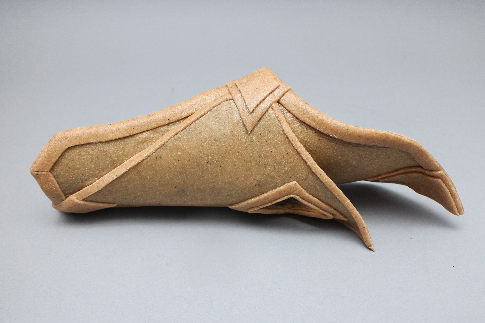

For some accessories you can use a much simpler patterning method, for example to create a pattern for this bracer I just measured the distance around my wrist, the length of my forearm, and the distance around the thickest part of my forearm. I drafted these measurements on paper, then drew the shape of the bracer base onto this basic shape.
Obviously both these designs have details and other elements so why am I not patterning them now? As when you're working with EVA foam, the curvature and thickness of the Worbla makes it hard to pattern details accurately ahead of time, so it's usually best to pattern and create them as you go. This is actually one of my favorite things about Worbla, it's is a very spontaneous material that allows you to design and create as you go and still see fast, durable results immediately. Like I said, it's fairly supernatural :)

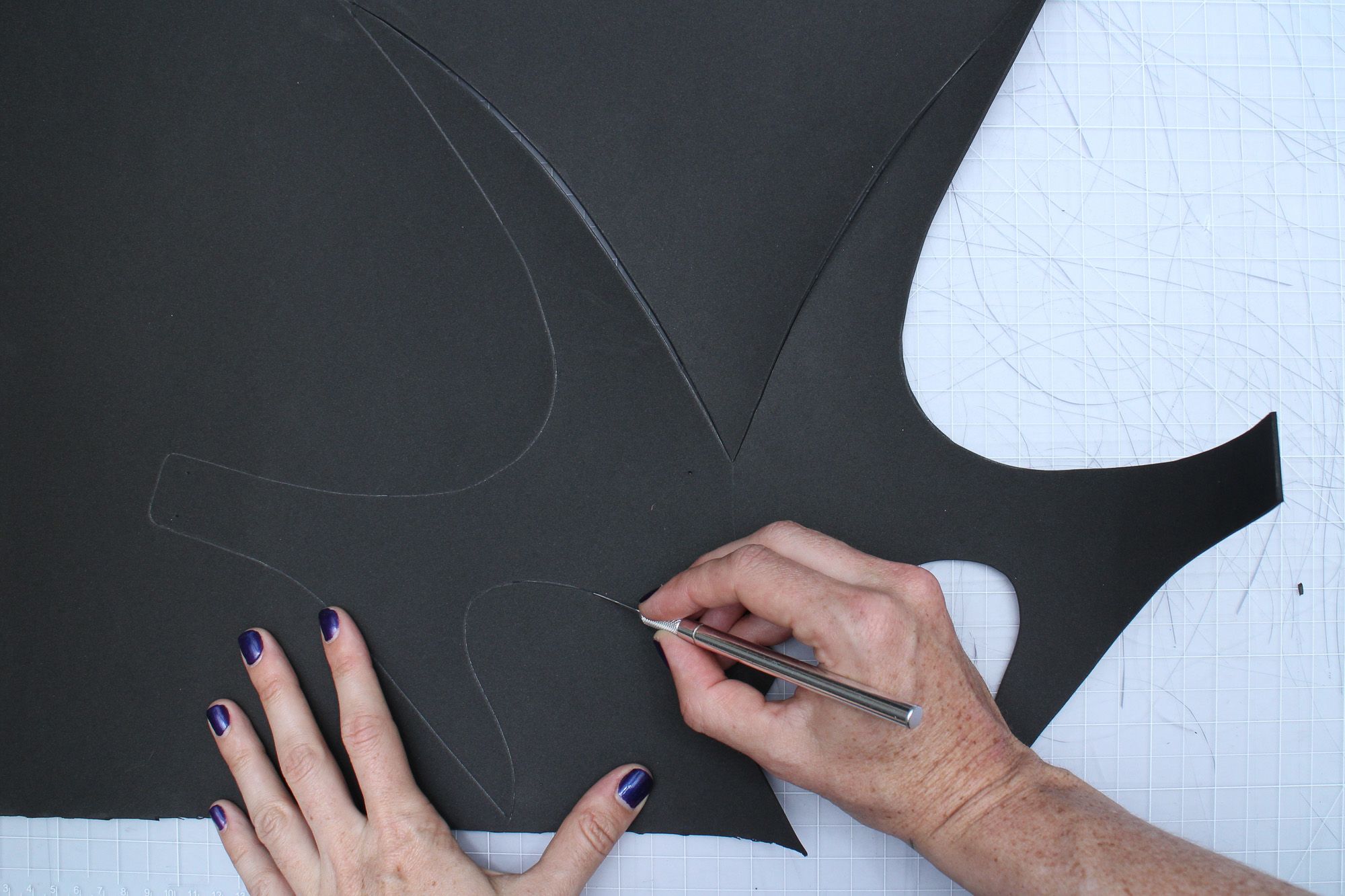

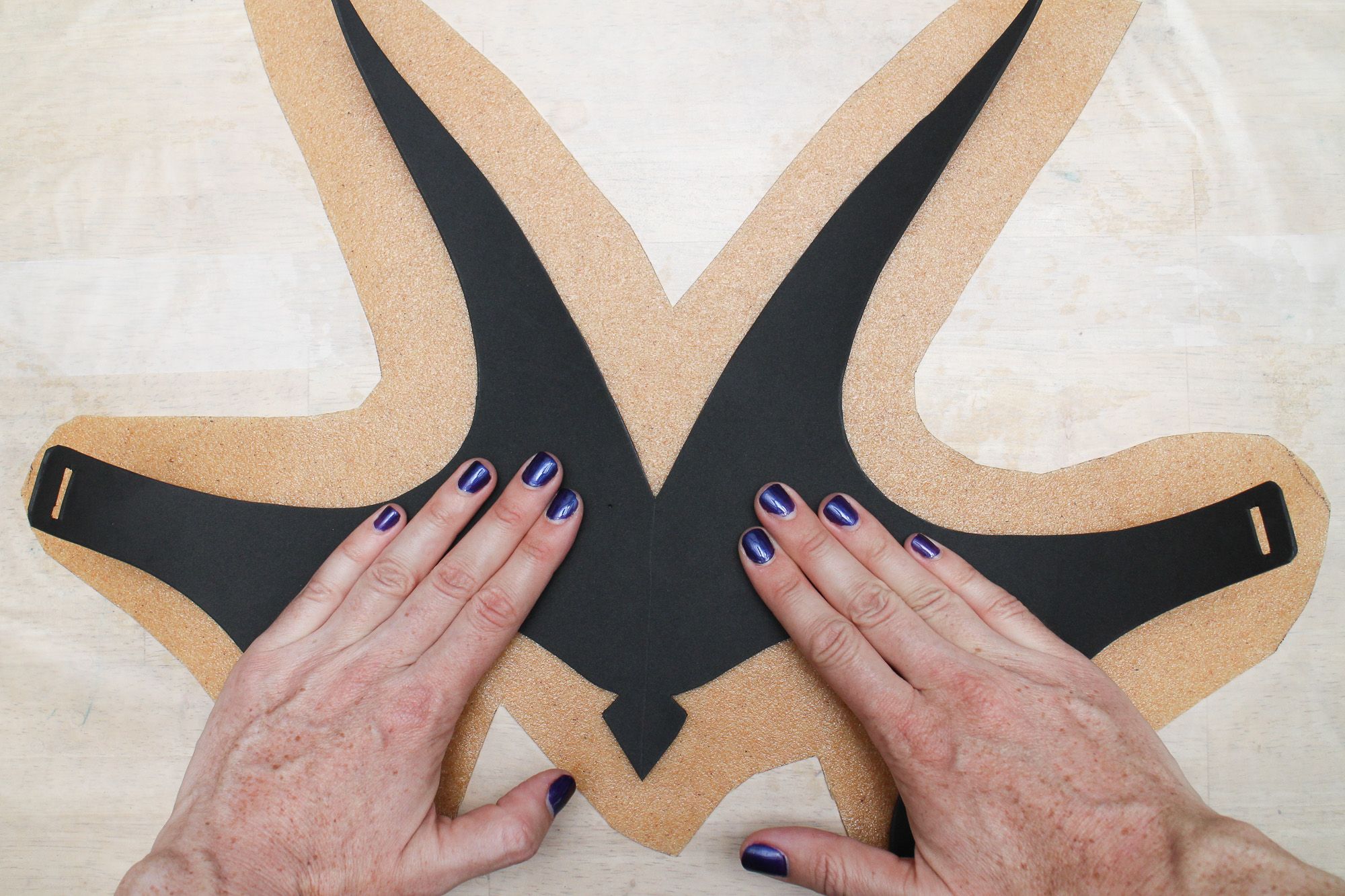

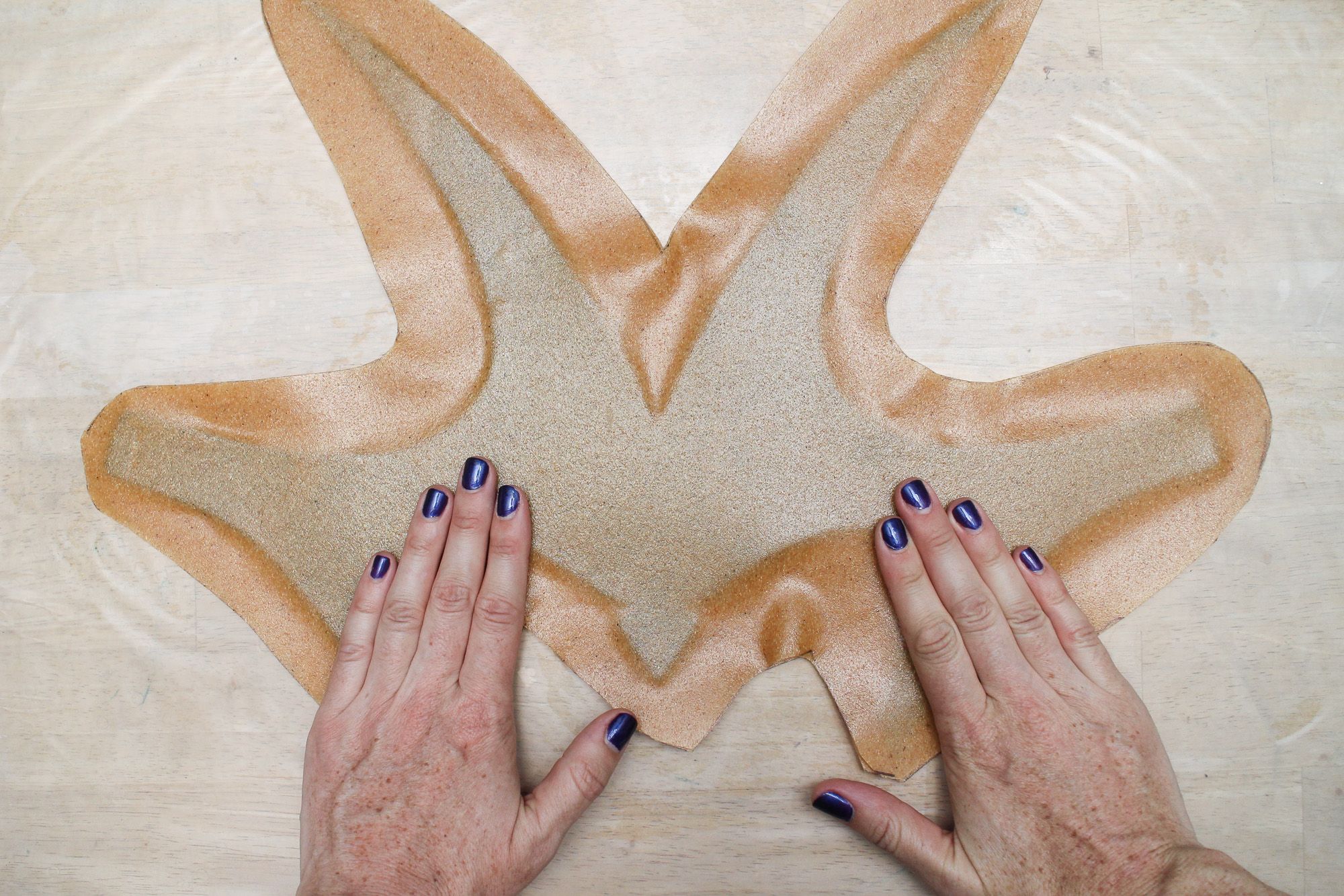

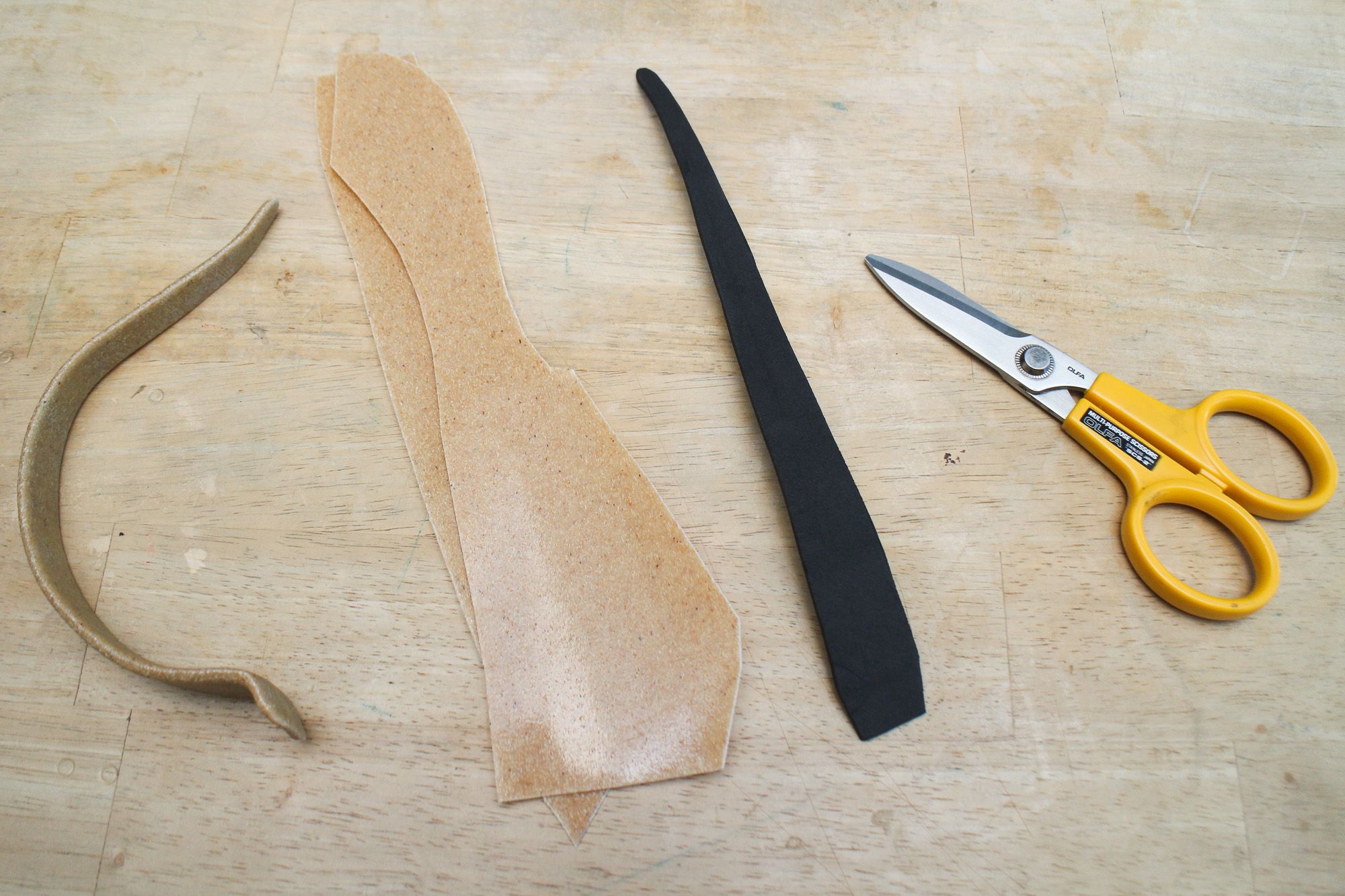

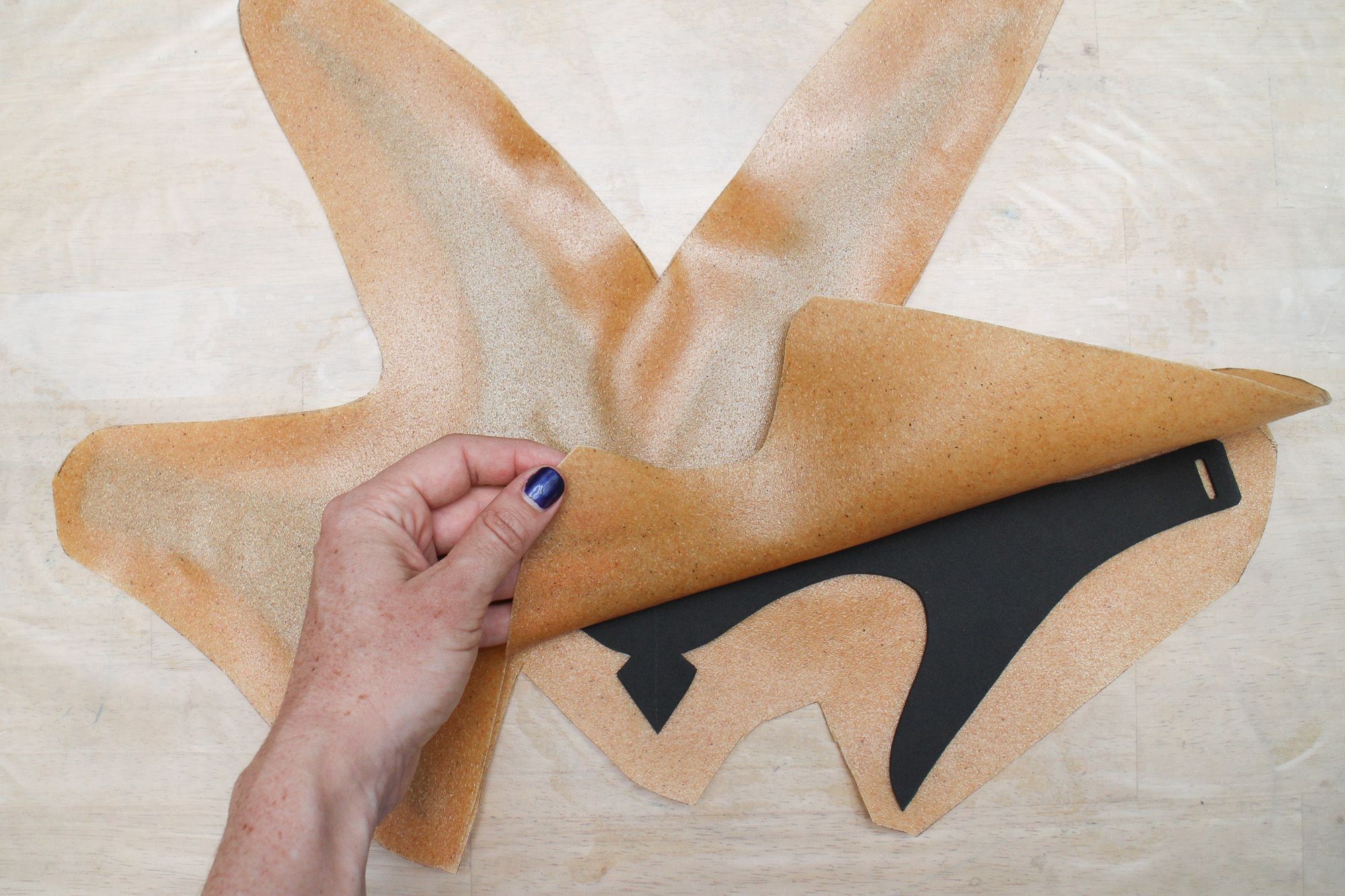

Once you have your pattern it's time to create your base layer of Worbla. You could use 2 or 3 layers of Worbla sandwiched together for this, but I like to use the foam sandwiching method. I usually use this method because it adds some extra thickness and stability without using too many layers of Worbla (making it both lighter, and less expensive). This would also be a good place to use Wonderflex or Mesh Worbla.
To use the foam sandwiching method, use your pattern to cut out a piece of foam, I'm using 2mm thick EVA foam here. You really don't need something too thick, and keeping it thin will help maintain the flexibility of your Worbla.
I also used my pattern to cut out two pieces of Worbla a bit bigger than the pattern on all sides. You'll notice that it has a shiny side and a slightly duller, more grainy side; the shiny side is slightly more adhesive so it's better to use this side as the side you stick to your foam.

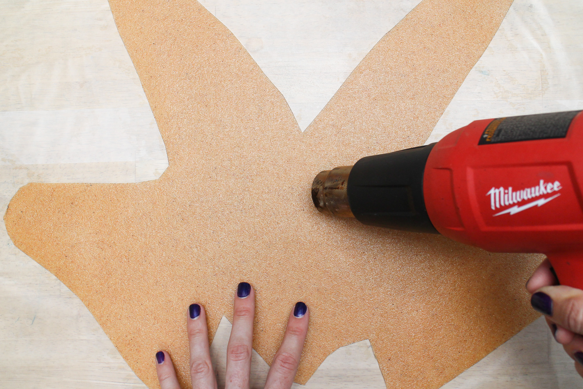

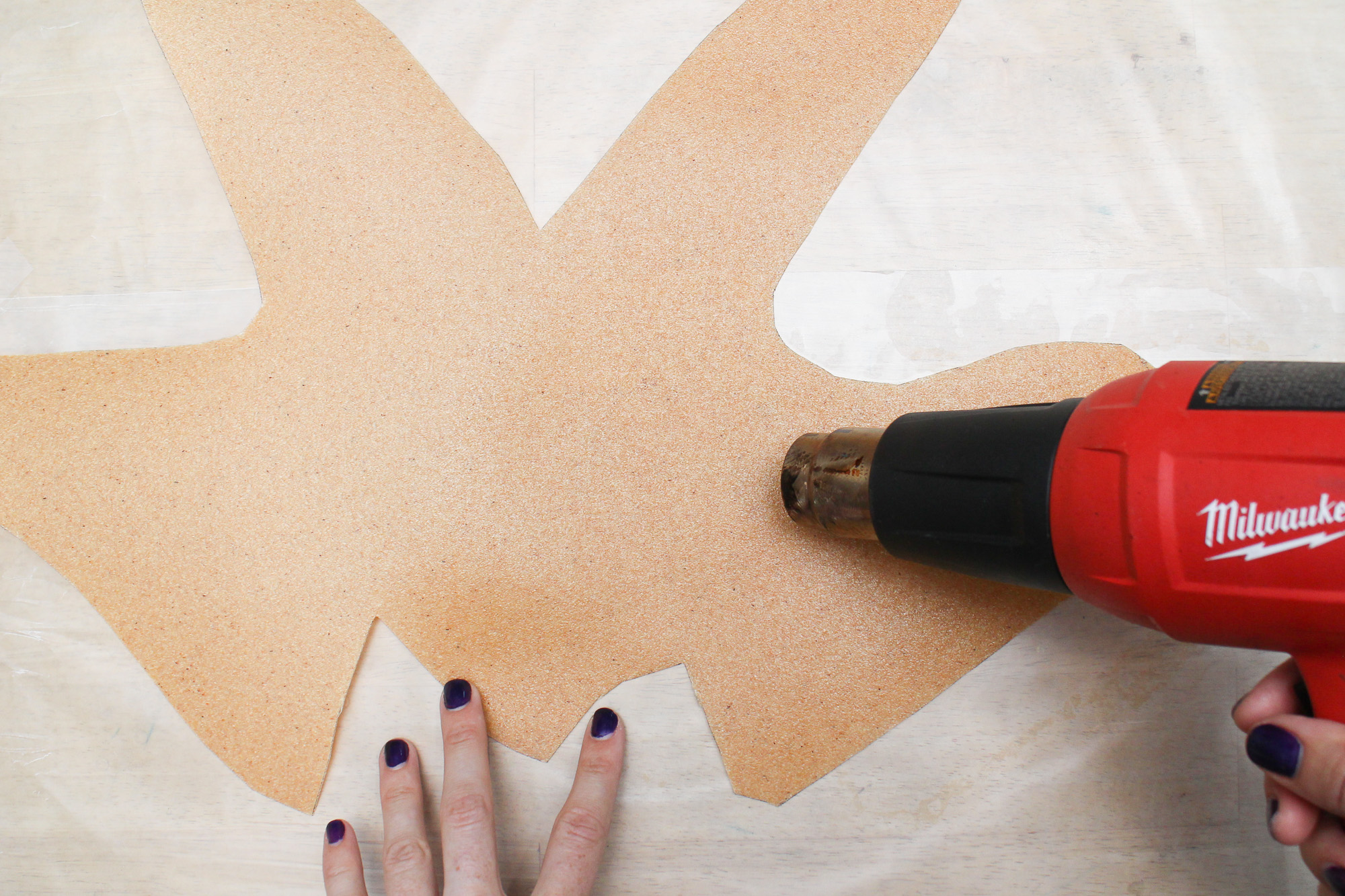

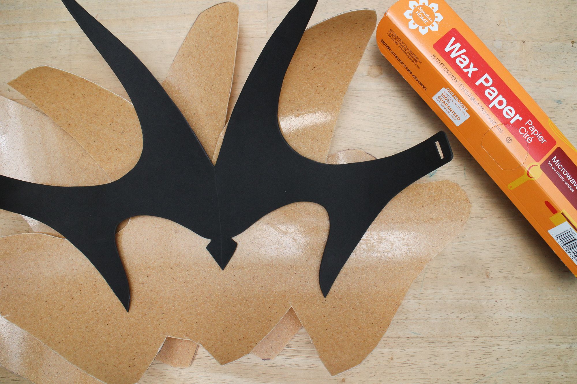

Now you need to heat your Worbla. A lot of tutorials recommend using a layer of wax paper under your Worbla when you heat it up, but I have found that wax paper sometimes sticks to the hot Worbla so I often just work on a wooden butcher block counter, which works great. Aluminum foil will also work well as a base.
Lay your Worbla on the table and wave your heat gun over it, holding it about 4" away. My heat gun has two settings and I usually use the lower one because the higher one can start to really melt the Worbla if you aren't careful. You want to wave the heat gun back and forth, not focusing too long on one place until you see the Worbla start to soften and darken slightly. If the Worbla gets too hot it will start to turn white, so stop heating if you see that happening.
Heat one layer of Worbla evenly all over, then place your foam piece on top of it, pressing it down so it sticks.
Heat the second piece of Worbla and place it on top of the foam, pressing it down lightly, and working your way from the center to the edges to eliminate any bubbles.
To seal the edges of the two pieces of Worbla around the foam it's nice to have some kind of thin smooth implement to run along the edges. I found this tool in a drawer, I think it's some kind of sculpting tool, but anything similar will work. The Worbla will probably have begun to harden again by now, so heat it again and run the tool around the edges, pressing the two layers together.

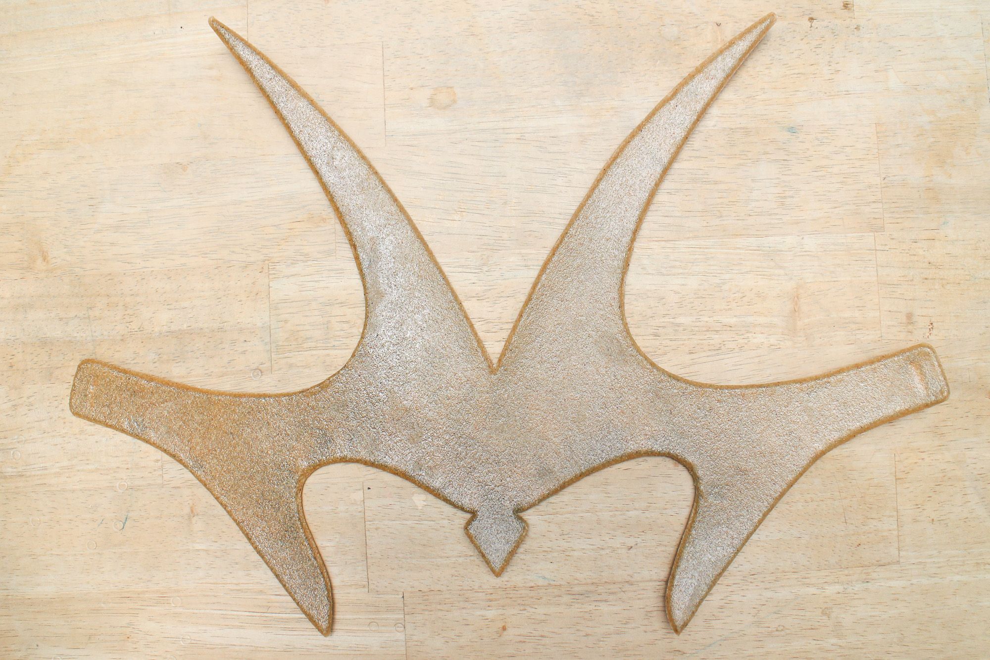

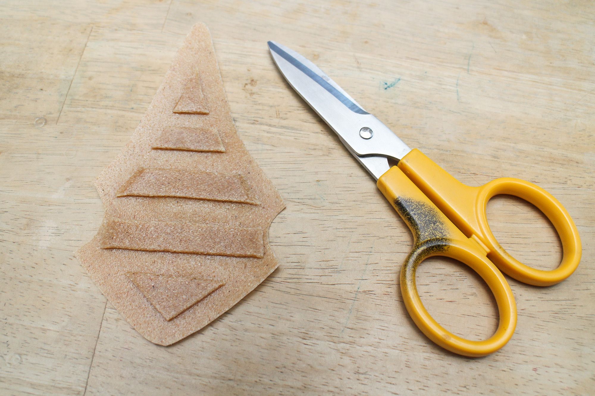

When you've gone all the way around use your scissors to cut away the excess, re-heating as you go.

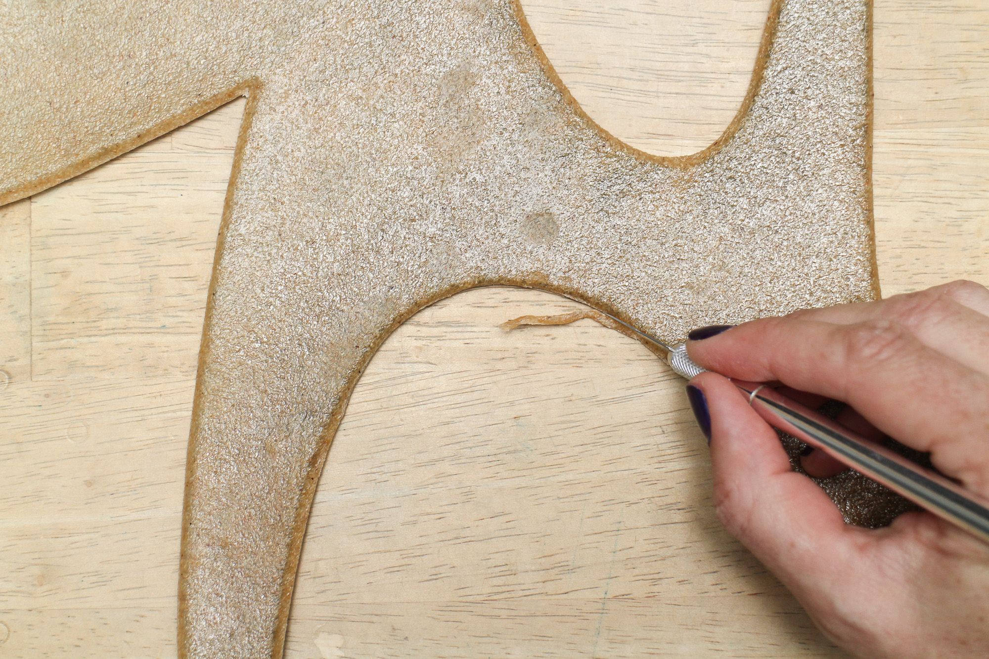

If there are any jagged edges you can use an X-acto to trim the hot Worbla.

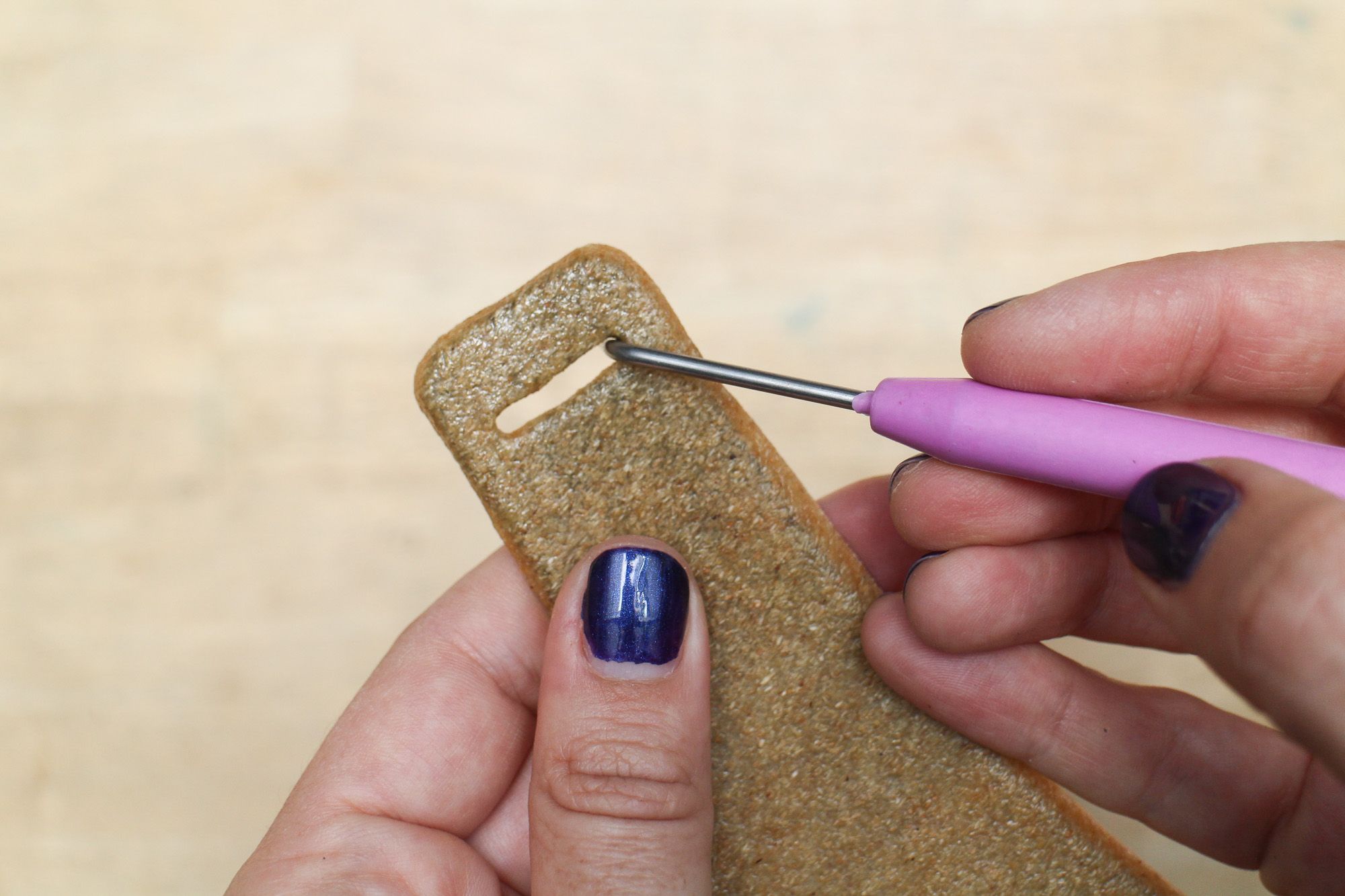

To create the openings to attach elastic I used my X-acto to cut into the Worbla, then moulded it into the gap with my mysterious pokey tool.

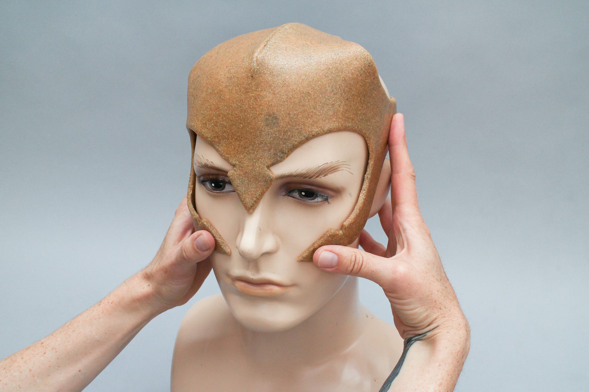

Step 4: Shaping

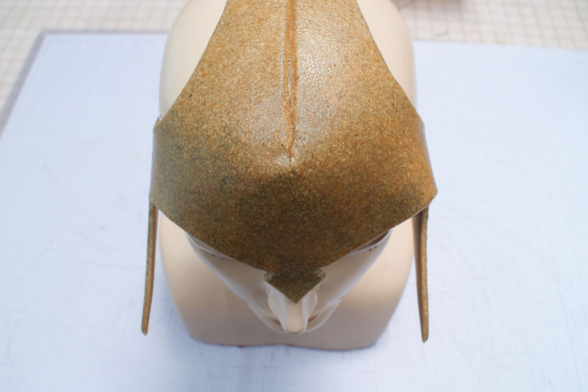

Once you have a flat sandwiched piece of Worbla and foam, you need to shape it into your headpiece or whatever you're making.
If you're already working with a head form you can use it to create the basic shape of the headpiece, then adjust it to fit you. You could also use another similarly sized round object like a the base of a vase. Household objects can work great as shaping aids and finding them is a pretty fun treasure hunt :)
If you are going to form over something, test a hot piece of Worbla on it before you shape your design to see if the Worbla sticks badly to the surface when it cools. Worbla doesn't stick to this head form, but if it did I'd use a little vaseline on the base to prevent sticking.

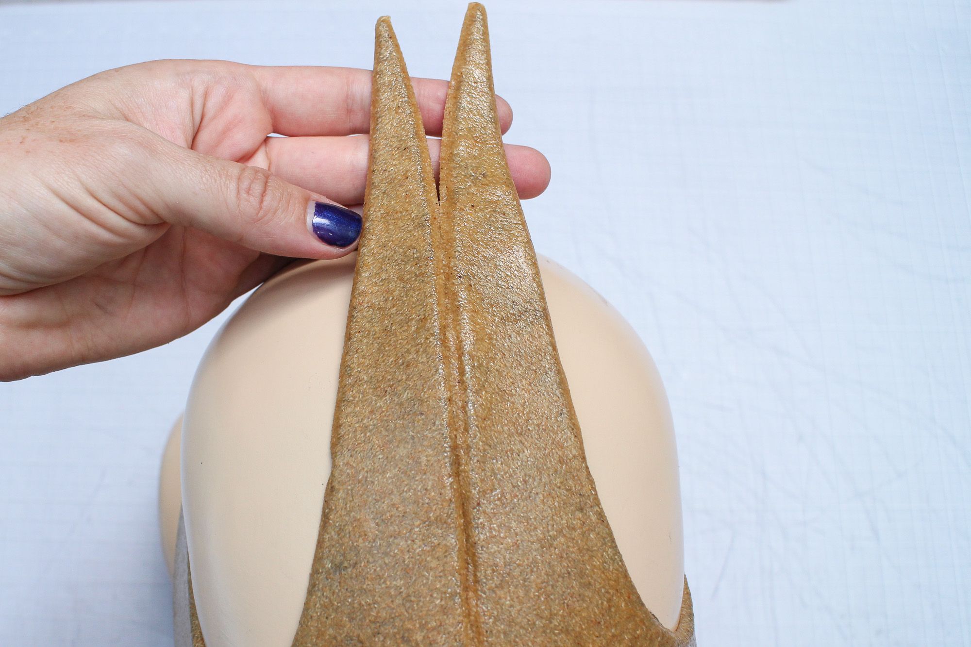

When you're ready use your heat gun again on the sandwich, flipping it over to get both sides evenly. Then place your Worbla over the form, and if you have any seams like I do here, press them together along the edge so they stick, closing the dart and giving the piece shape.
Press the rest of the piece around the base, moulding it into the shape you want. Try to keep the mirrored sides even, and hold them in place until they cool and harden into shape. You may have to keep reheating and reshaping until you get everything looking just right.

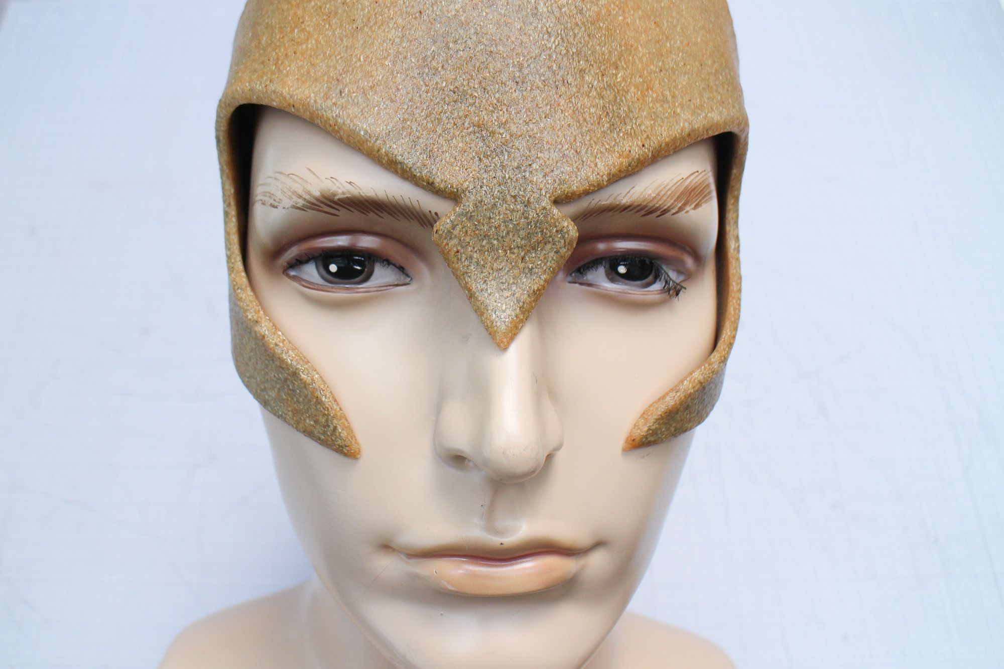

Let the piece cool, then try it on yourself and see if there's anything you want to change. If so, heat just these areas and re-shape them. You can also re-enforce any seams from beneath with strips of Worbla.

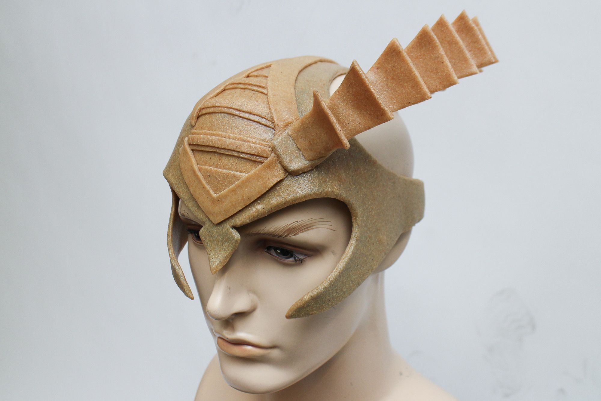

Step 5: Creating Details

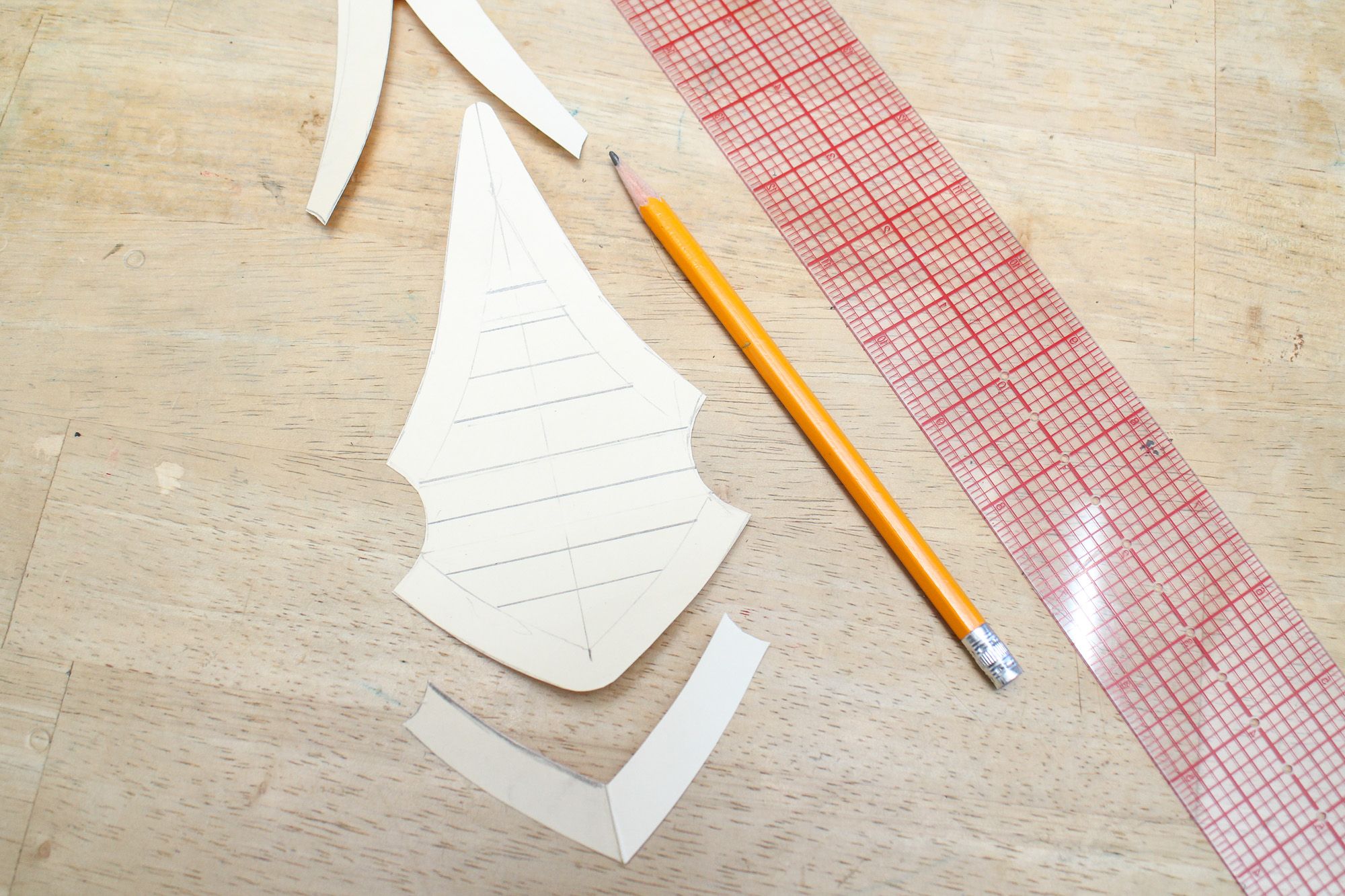

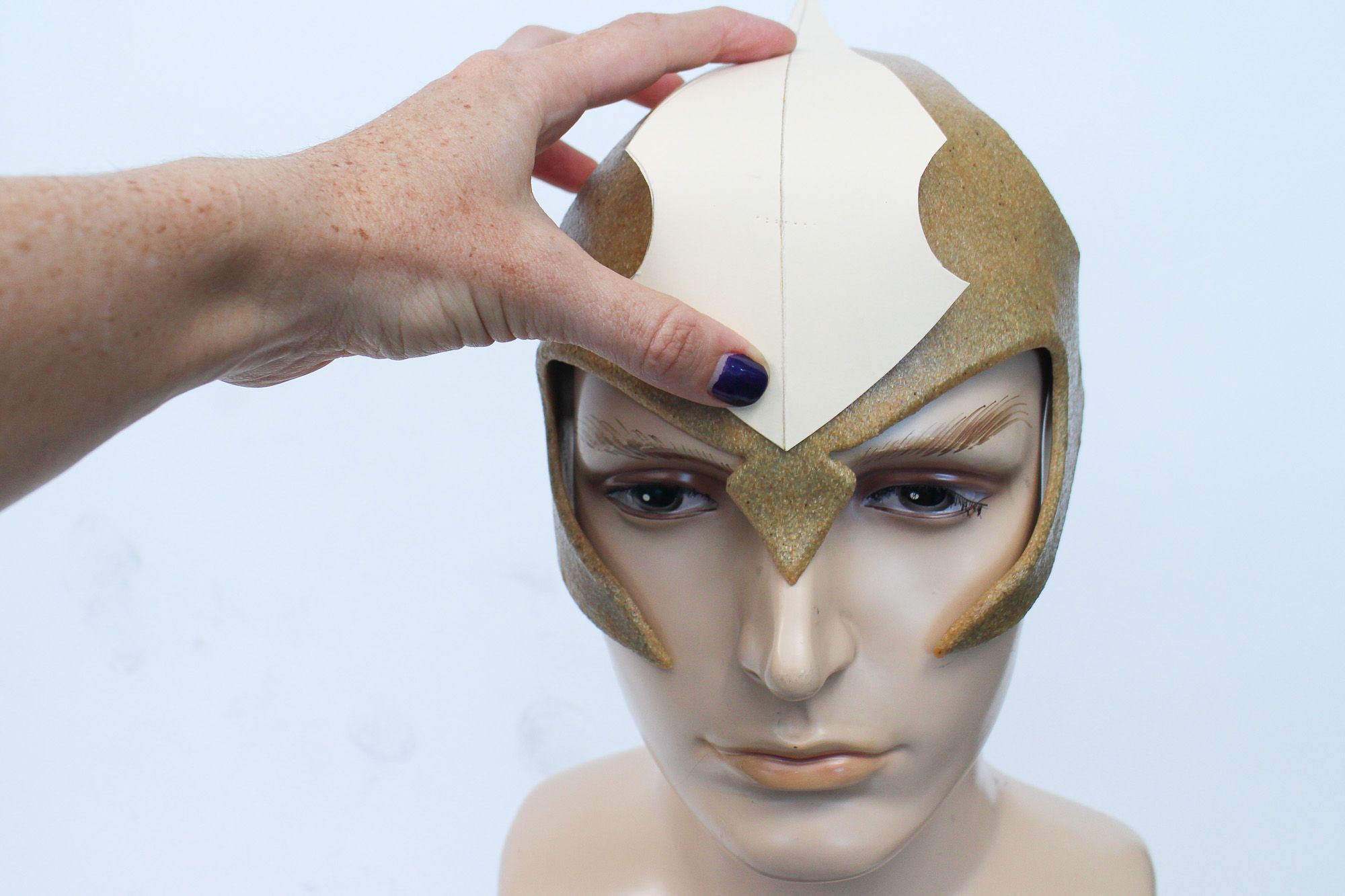

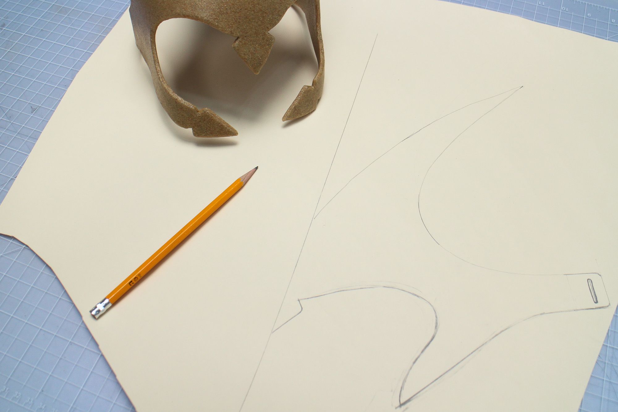

Now comes the fun part, creating the details that will make your design unique and beautiful. For some of these pieces it's a good idea to create patterns, and for some things you can just work freehand.
To create pattern for details you can use the masking tape method again, this time taping and drawing directly over your Worbla, or you can use your base pattern to just sketch out shapes and then hold them up to your piece to see if they fit - do whatever feels most natural to you.

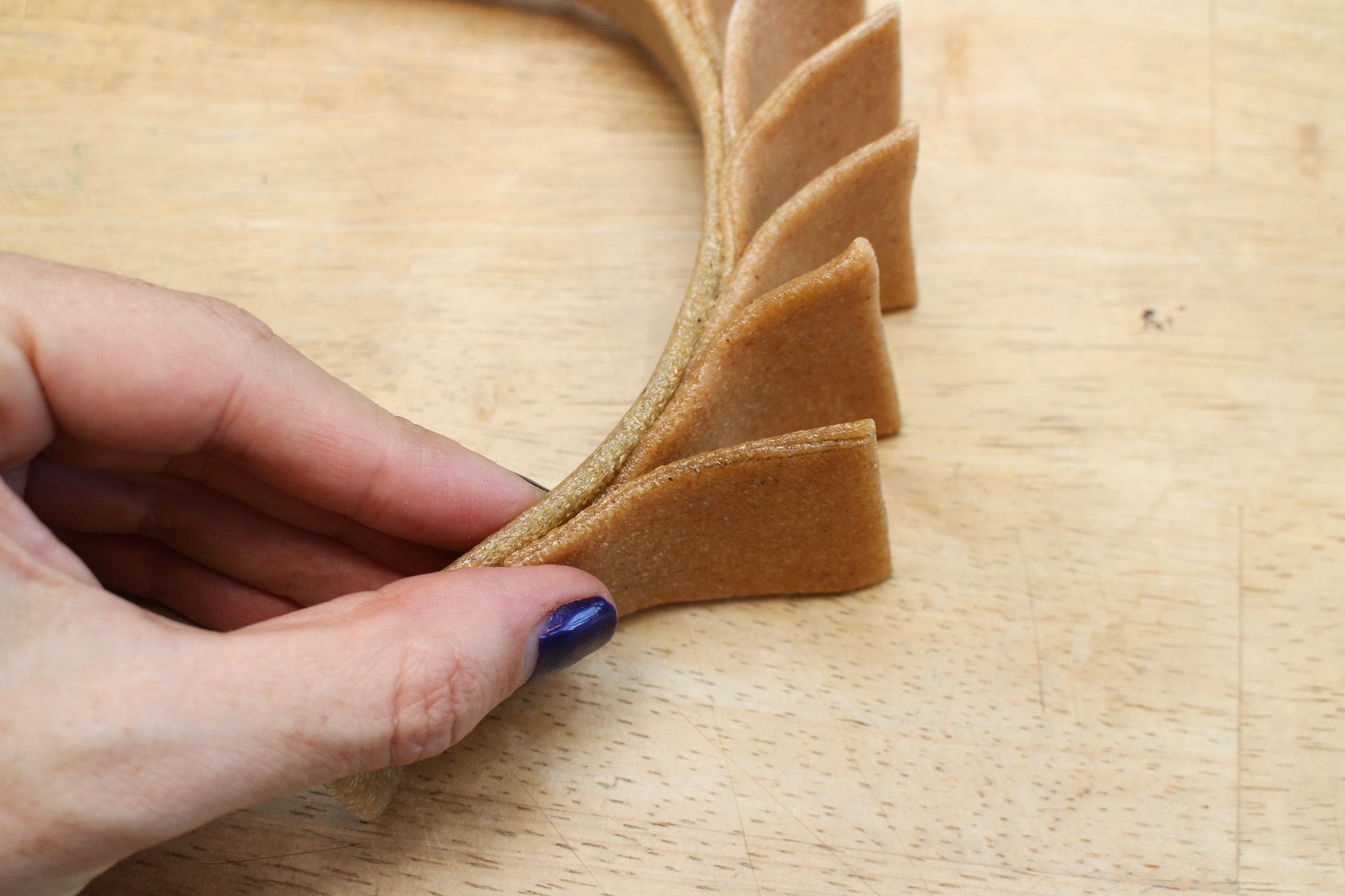

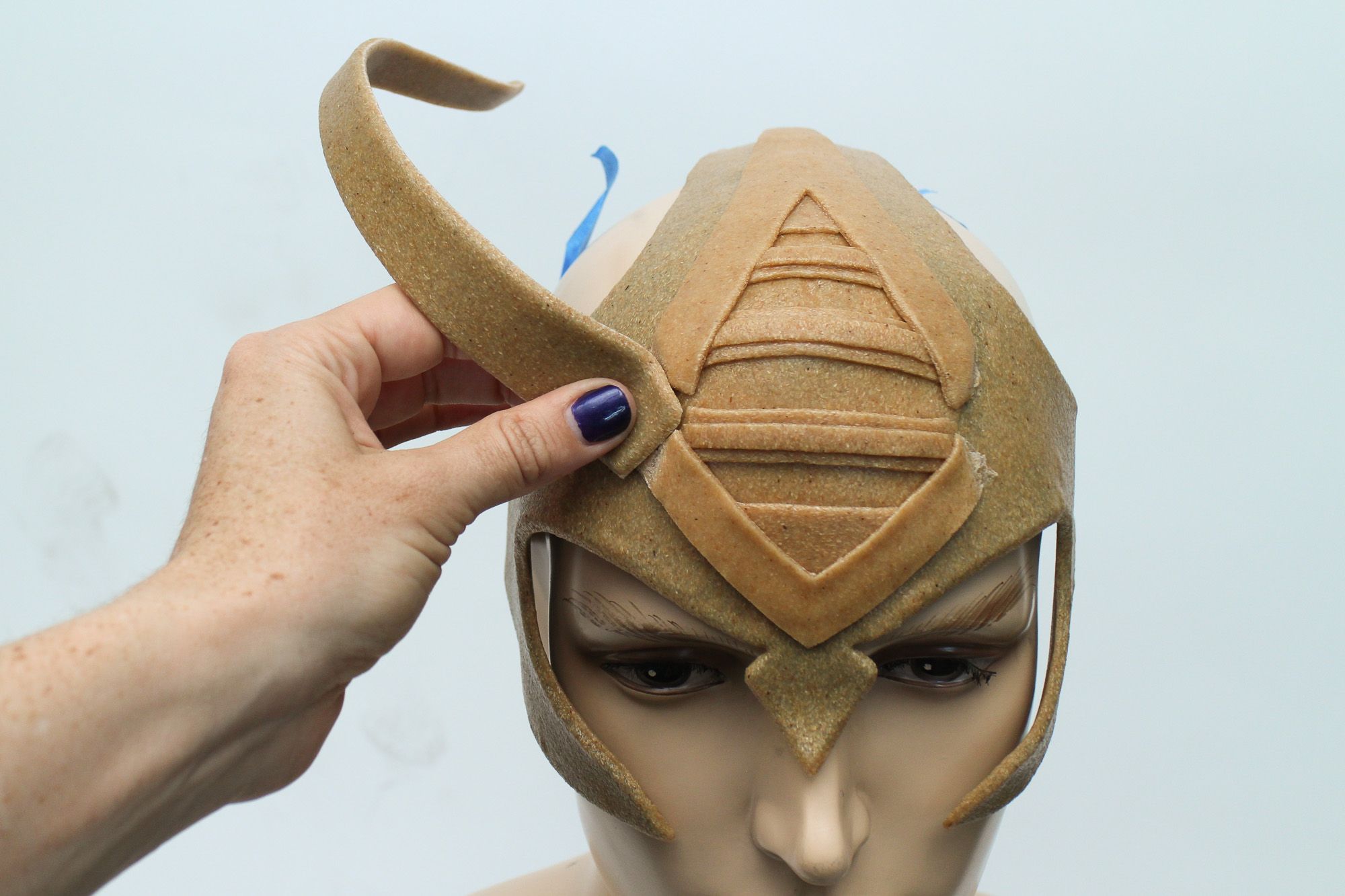

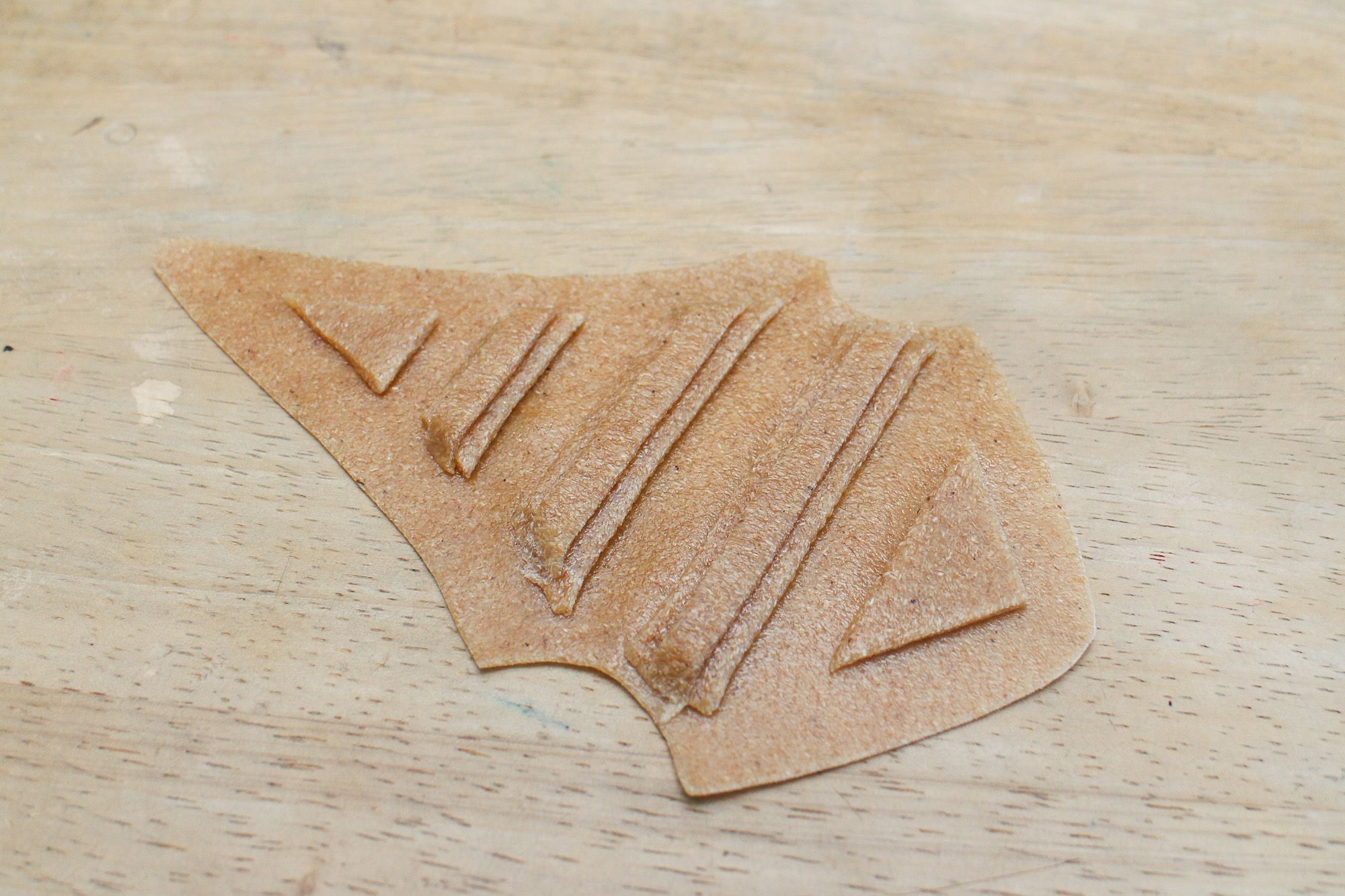

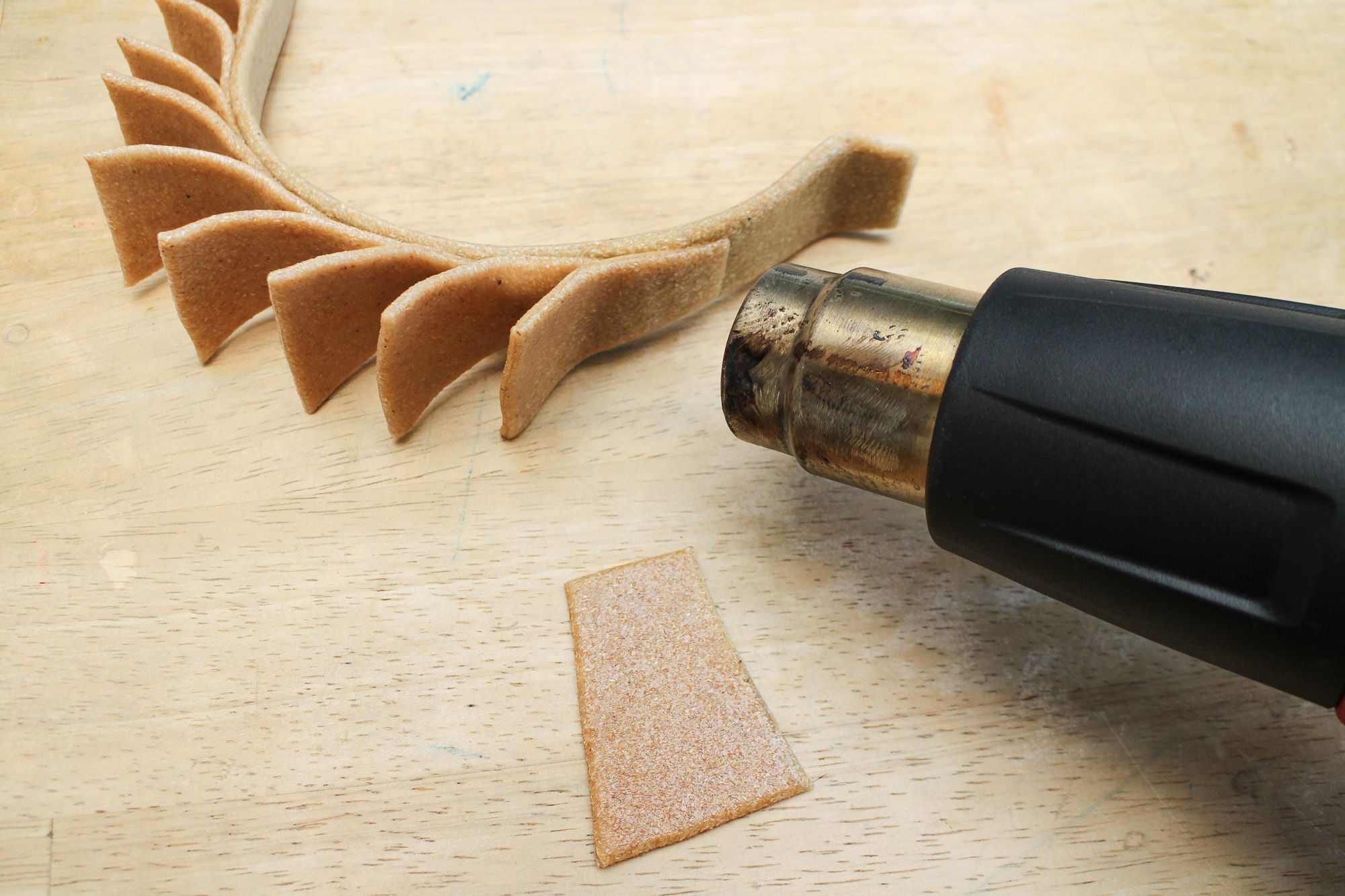

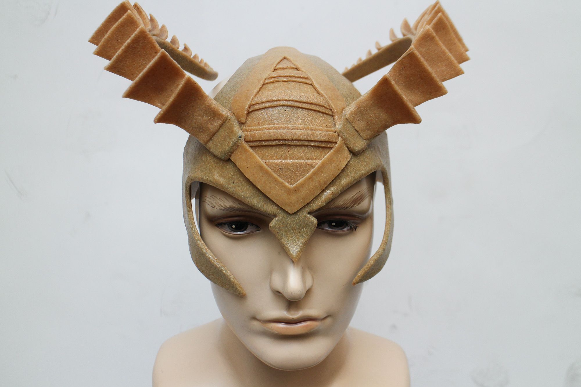

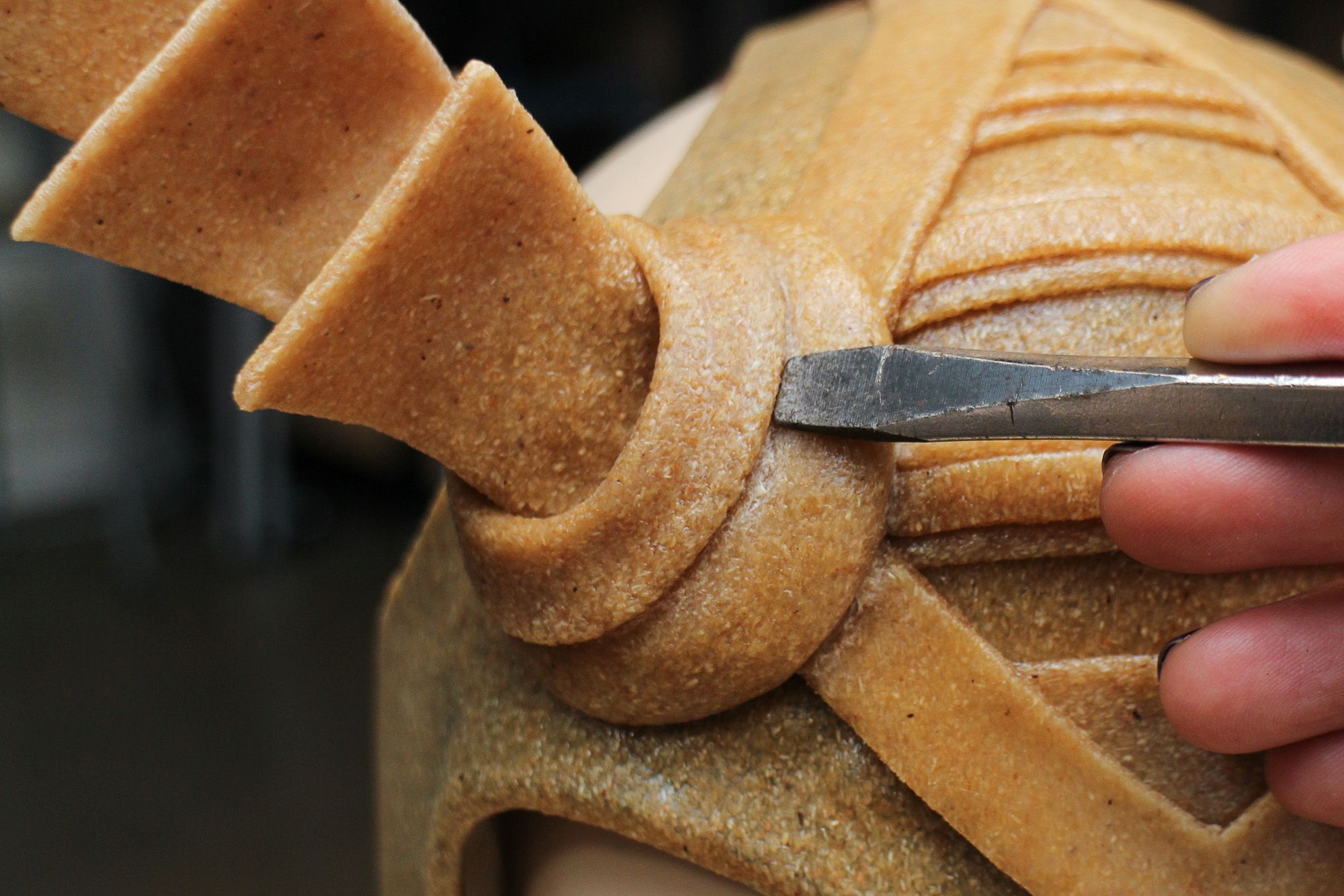

To add your detail pieces you need to heat both the base and the pieces you are adding. I think it often works best to create sections of details separately and then add them to your piece all at once. Once a piece of Worbla has adhered to itself it's really difficult to get it off without damage, so mistakes can be hard to undo.

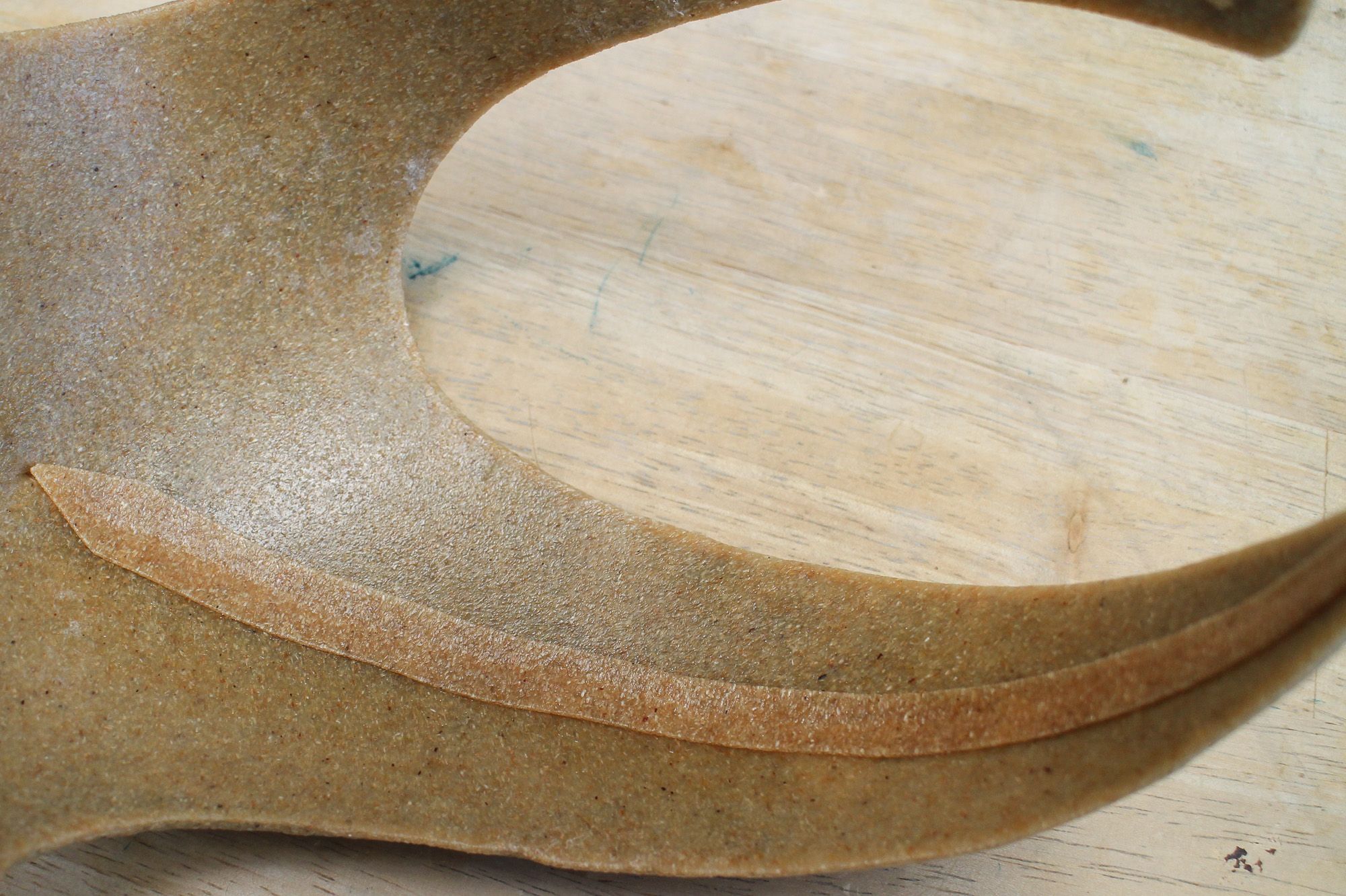

Something I really like about Worbla is that you can also use details to cover up mistakes or seams, like I did on the top dart of my helmet.

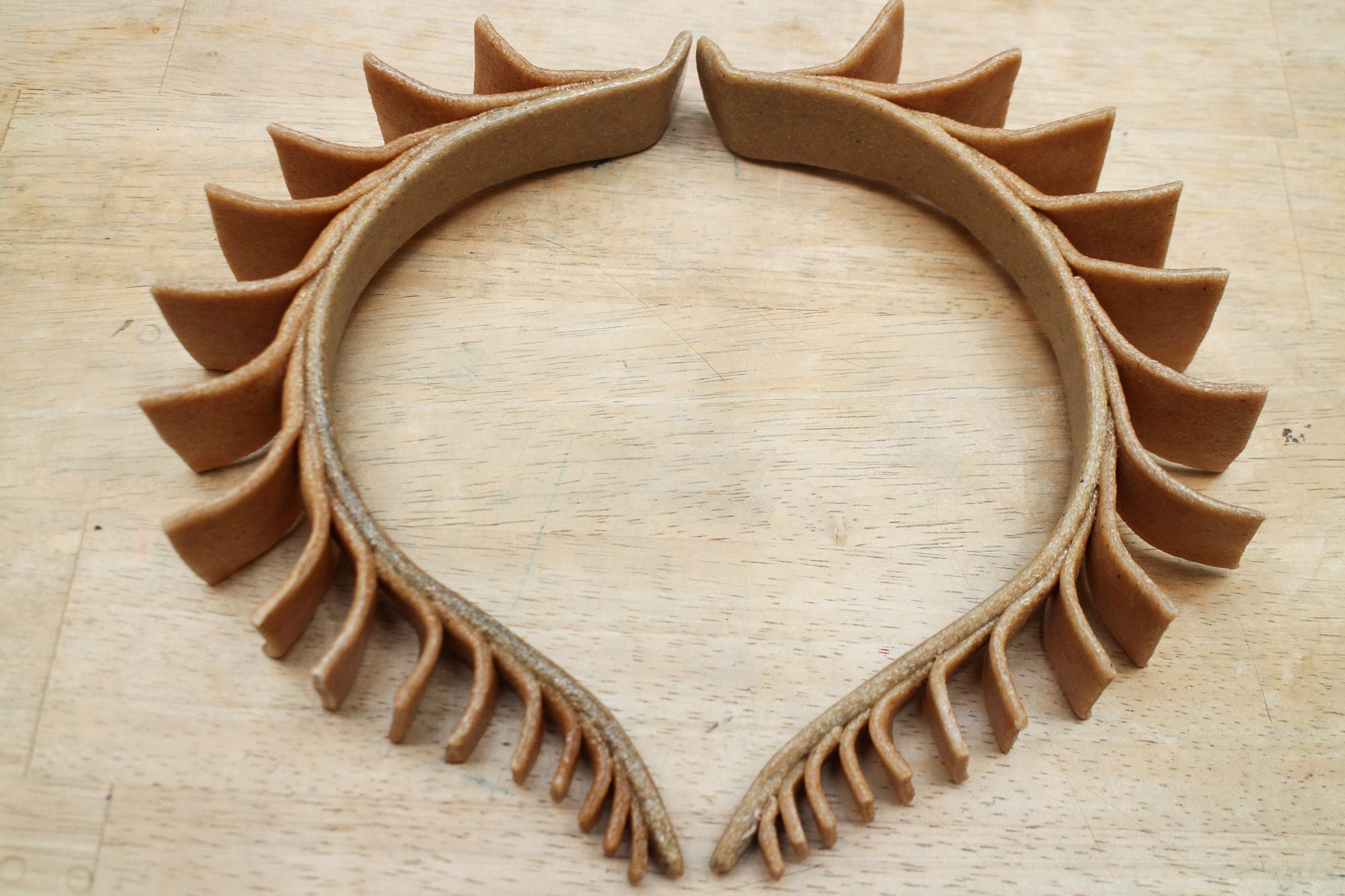

At this point you are really just sculpting, so you can use all kinds of different techniques depending on what kinds of details you want to create or what material you are trying to emulate. If you are trying to create something realistic it can be helpful to look at reference pictures as at this stage.

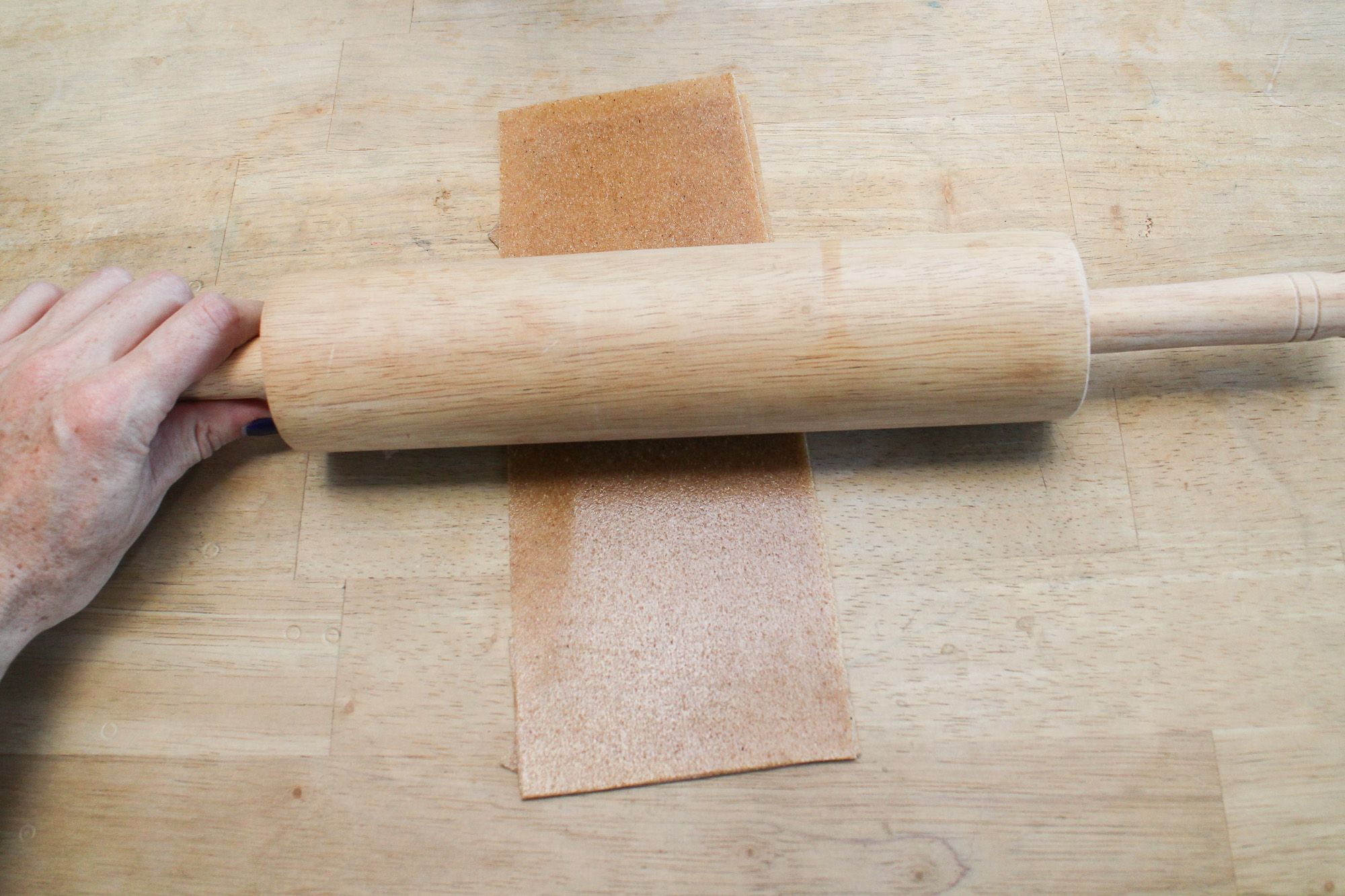

For example, if you want to create something that looks like it was made out of sheet metal, you should probably cut shapes out of flat sheets of Worbla. One sheet of Worbla is really quite thin, so I often sandwich from 2-4 layers together with to create a lot of my detail pieces. Heat each layer and roll them together with a rolling pin to get a nice flat piece.
If you want to create something that looks like it was carved or sculpted you can use your Worbla more like clay, mushing it together, rolling it, shaping it, or even pressing it onto something that has a texture!
You an also use tools on your details once they are in place to shape them further.
Most details won't require more foam sandwiching, but if you are adding another large structural layer, like I did on my bracers, it can be a good idea.

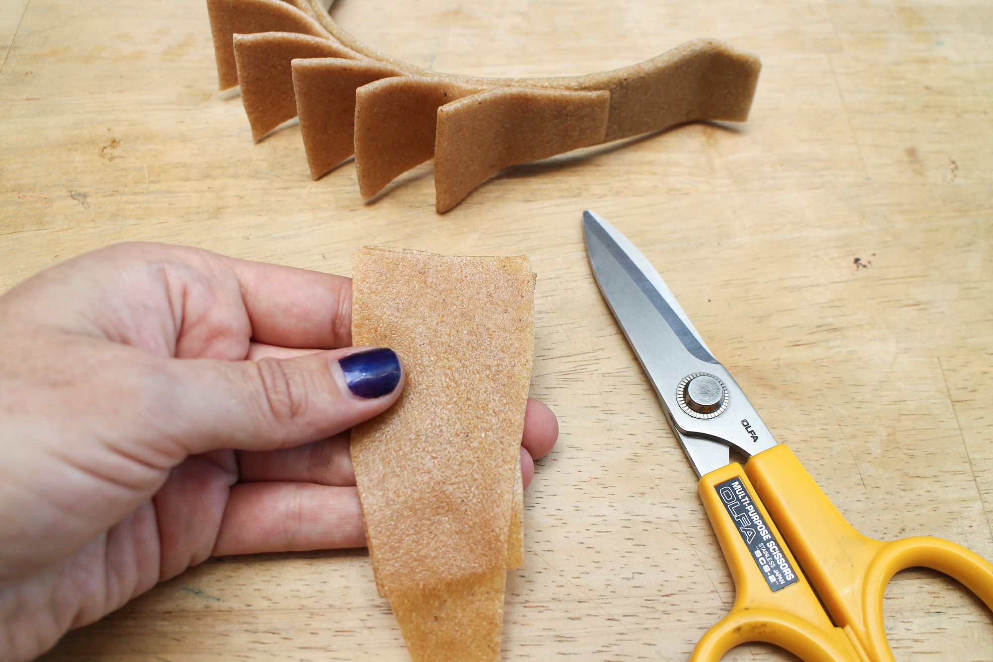

I also used a foam core in the antennae of my moth headpiece. First I created the base pieces and formed them into a curve I liked with a little tab at the bottom that would be the attachment point to the helmet.
The texture of the antennae was created by cutting pieces out of triple layers of Worbla and sticking them to the base one by one.
When I had both antennae made, I heated them and then stuck them to the helmet.
