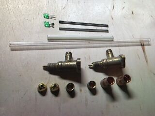

Step 1: Parts:
As I said prior the parts are fairly easy to aquire and they are as follows.
2 Small brass gears. (Scraped from old clocks washing or dryer machine timers) Cost free
2 LED's color of you're choice.(Pulled from old VCR's Radio's) Cost free
2 Stainless steel rods (taken from junk CD/DVD players.) Cost free
2 Brass gas valves from gas grill. (Scraped from junk grill) Cost free
4 Dollar store Laser pointer's (Just the cap's are needed.) Cost $4.00
2 1/2 to 3/8 copper pipe reducers (bought at any hardware store). Cost $2.00
2 Decorative lamp Sleeve (Hardware store.) Cost $1.00
1 Hard clear plastic tube. (Dollar store cup with washable straw.) Cost $1.00
1 Fire sleeve White. Cost free (found at local wholesale electrical contractor
supplier, Or pulled from electrical appliances that use heat.)
1 Single pole toggle switch. from Radio Shack Cost $3.19
2 lengths of thin insulated copper wire about 25 inch's Cost free (USB cable stripped down to the 4 conductors work great)

Step 3: Assemble the Light Tube Part 1
First I placed the base and 1/2 to 3/8 pipe reducer in the vise and gently pressed it onto the base x2.
Next is to size up the fire sleeve, marked with a fine point sharpie.
Using the pipe cutter very very gently score the plastic tube, If too much pressure is used it will crack and break, the best way to cut this i found is by scoring the tube then heat up the utility knife blade and cut it. Clean off any burs.
Now insert the fire sleeve into the tube mine was a real tight fit made it hard to get in all the way but i did it.
Now that the base and tube are ready we can move on to the stainless steel guide rods, these rods came out of burned up DVD and CD players the fit the holes in the base perfectly. Slide them in and gorilla glue them into place, then slide the other base on to support the guide rods until the one end has dried completely.
After drying is completed remove the unglued side of base. Screw on the decor lamp sleeve and laser pointer cap for the end cap x2.
