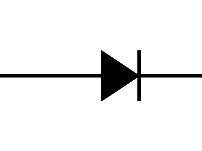

Picture 10 is the electronic symbol for the diode so that you will be able to recognize it on an electronic schematic.
