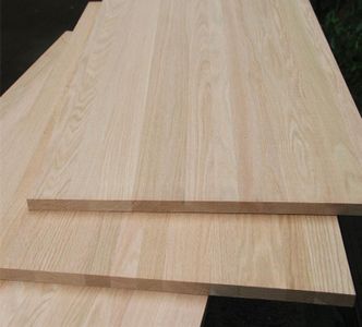

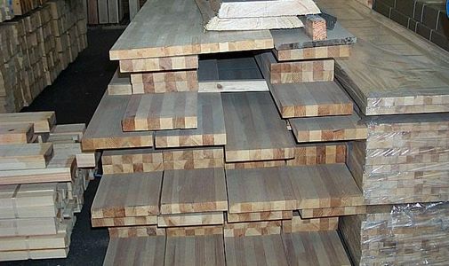

Step 1: Produce (or Purchase As I Did) Edge Glued Panels
I bought premade edge glued panels at a local quality lumber store. I did that to save one step and because it can be difficult to end up with panels that are nice and flat. The ones I chose are Spanish Cedar. I chose a softwood because for some of the operations, hardwood would be really hard on tools.
