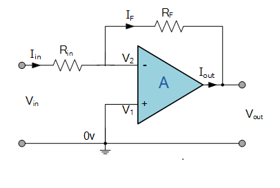

Before building your inverting circuit you must first decide on the value of the gain that you wish to amplify your input signal by. Since the equation for the gain of this circuit is very simple you can obtain your desired gain value by setting values for Rf and Rin. Once you have chosen values for these resistors you can multiply the gain value by the amplitude of your input signal and obtain the value of Vout from the amplified circuit.
Example: If Rf = 100,000 ohms and Rin = 10,000 ohms then the values of the gain would be: gain = -Rf/Rin = -(100,000)/10,000 = -10 With an input signal with an amplitude of 1V then the output voltage would be: Vout = Vin*gain = 1*(-10) = -10V
Notice that the output voltage is negative, this is because we are inverting the signal of the input by 180 degrees out of phase as stated before.

  2. Insert wire from the third pin (+) of the op amp to the ground terminal of the breadboard.
  3. Insert Rin (10,000 ohm resistor) from the second pin (-) of the op amp to an arbitrary point on the breadboard that is not connected to anything.
  4. Connect one end of Rf (100,000 ohm resistor) to the second pin (-) of the op amp with the other end connected to the sixth pin (output) of the op amp.
