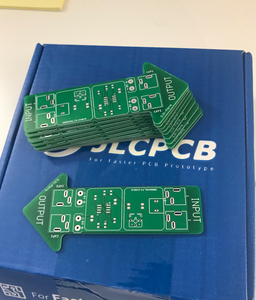

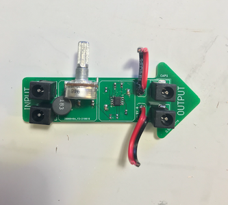

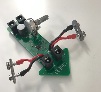

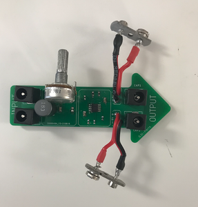

3) Lastly, experimental measurements will be gathered by designing and manufacturing a PCB board following Chua's design. The design process will be undertaken using Eagle software. The production of the circuit will rely on JLC PCB as a manufacturing house. Once assembled, a signal generator will be used to subject the circuit to a wide range of input signals, where the output response will be measured using an oscilloscope.

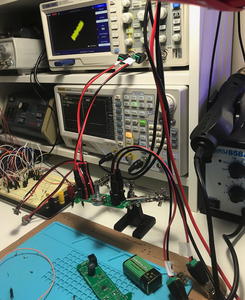

- Oscilloscope - The SDS 1052DL+ from Siglent is utilized for the experiment, but other methods of measurement can also be used.
- Signal Generator - The DG4102 from Rigol is used for the experiment, but any cheaper alternative will work.

- PCB Manufacturer - PCB boards are ordered through JLC PCB, but any other company can be used. Feel free to shop around.

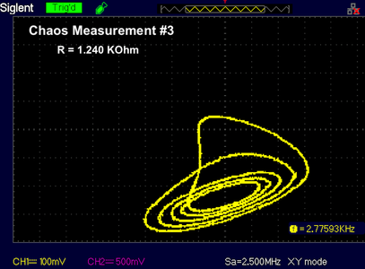

- Analog Oscilloscope can be useful in order to gain further insight into the chaotic behaviour of the circuit.

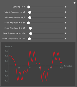

Step 1: Theory in Mathematica
Objectives:
1) What are the known forms of non-linear resonances?
2) What are the parameters used to describe and interpret resonance in the Chua's Circuit?
Establishing the Computational Environment
1) Gain access to Mathematica --> Mathematica 15 days trial
2) After entering your information, an email will be sent providing you with an activation key. If you have not already downloaded Mathematica software on your computer, a download link will also be provided in the email. Alternatively, you can utilize the cloud environment to compile the notebook.
3) Download the Mathematica notebook from the Github Project Repository (ResonanceTheory.nb). Note that the notebook serves as an experimental playground for theoretical ideas and therefore is in constant progress. As a result, the codes underlying each example might not always be optimal.
4) Proceed through the notebook exploring the quantitative interpretation of dynamical systems paired with various non-linear resonant responses. Feel free to experiment with various parameters to gain further insights.

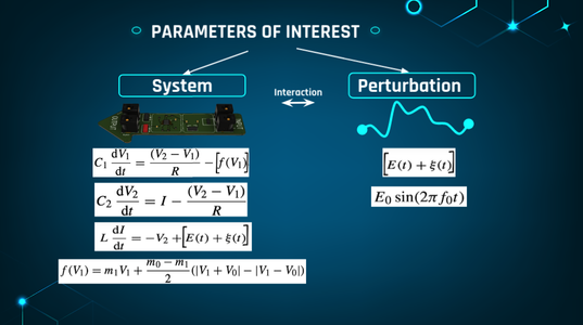

2) Parameters of Interest
The parameters of interest to interpret resonance in Chua's Circuit system can be divided into two categories. A set of parameters describing the circuit's behaviour (system) and parameters describing the input signal (force).
Systems Parameters:
The parameters describing the state of the circuit over time can be further categorized based on three criteria found to be necessary for chaos to occur in electronic circuits. * :

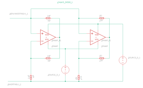

1)One or more non-linear elements --> Chua's Diode composed of:
- Operational Amplifiers
The values of parameters M0 and M1 found in the provided equations arise from different design configurations and become critical to describe the non-linear property of the circuit.
2)One or more locally active resistors (Negative resistance within Chua's Diode sub-circuit):
- Resistors R1, R2, R3, R4, R5, R6
3)Three or more energy storage elements:
Inductor L1
Capacitor C1
Capacitor C2
Taken together, the dynamical state of the circuit becomes describable with only three variables:
- Voltage Across Capacitor C1 = (V1) or (X)
- Voltage Across Capacitor C2 = (V1) or (Y)
- Current Across Inductor L1 = (I) or (Z)
The time evolution of the circuit is described by three ordinary differential equations found in the provided visuals. In addition, the non-linear property of the resistor is mathematically represented by the function f(V1), which can arise with various levels of complexity based on the chosen circuit configuration.
*** In dept theoretical discussion paired with experiments demonstrating the evolution from linear RLC circuit to non-linear Chua's Circuit capable of chaotic behaviour can be found HERE & HERE. Another useful resource providing theoretical insights regarding the implementation of the Chua's Circuit can be found in the following BOOK.

Producing the Simulation NETLIST / Circuit Diagram
Luckily, LTSpice comes with a friendly user interface that allows producing a schematic with conventional electronic components without having to represent the circuit through computer code:
1) Gather the necessary components within the circuit diagram work-space:
- Two 22Kohms resistors.
- Two 220ohms resistors.
- One 3.3Kohms resistor.
- One 2.2Kohms resistor.
- One 2.0K resistor. (Potentiometer)
- One 10nF capacitor.
- One 100nF capacitor.
- One 18mH inductor.
- Two voltage inputs.
- One Ground.
- OpAmps: Since the TL082 is not available within the default libraries available in LTSPICE, the LT1057 or the LT1113 can be used to simulate the circuit. Alternatively, the SPICE model of the TL082 can be downloaded and imported within the design environment. Further details about the procedures to follow in order import models can be found HERE & HERE. Also, an already made design of the Chua's Circuit using the TL082 can be downloaded from HERE (Very insightful resources).
2) Connect each component by following the provided Chua's design. Also, ensure to assign the proper values to each component.
3) Since the parameters of interest representing the state of the circuit are the voltage across capacitor C1, capacitor C2 and the current across the inductor L, voltage probes are added accordingly.

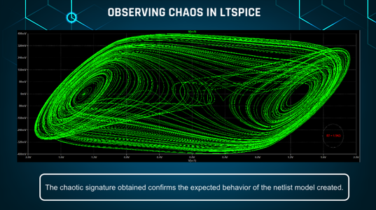

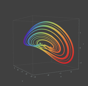

4) Let us now explore the effect of varying the value of resistor R7 located between capacitor C1 and capacitor C2. Once a specific resistance threshold value is reached, the circuit exhibit chaotic behaviour. To observe the double scroll chaotic signature, the voltage across capacitor C1 (V(vc1) probe) must be plotted on the horizontal axis and the voltage across capacitor C2 (V(vc2)) on the vertical axis.
The simulation parameters are set as follow:
- Type: Transient
- Stop Time: 0.10
- Time to start saving data: 0
- Maximum Timestep: 1E-5
The chaotic signatures obtained from the simulation confirm that the netlist produced adheres to Chua's Circuit properties. The resistance value from R7 inducing optimal Chaotic behaviour appeared to be centred around 1.5KOhms. However, the system's dynamic changes drastically at resistance values below 1.485 KOhms and above 1.965 KOhms. Although the objective of the present simulation is not to investigate chaos, feel free to explore how the resistance value of R7 affects the chaotic behaviour of the circuit.

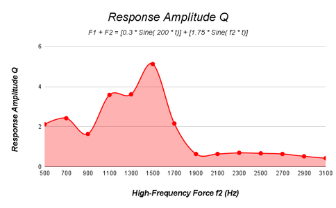

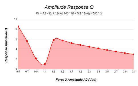

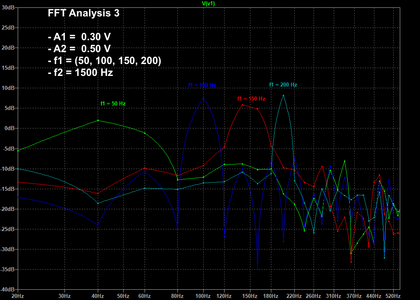

Vibrational Resonance (HIGH-FREQUENCY FORCE)
The action of vibrational resonance is an enhanced amplitude of the output signal found at a frequency matching the external frequency (f1) of the low-frequency driving force (F1) by the addition of a high-frequency (f2) periodic force (F2).
Simulation Parameters:
- Type: Transient
- Stop Time: 100ms
- Start Time: 50ms
- Time Step Max: 1*10^-5
System's Parameters:
The system's parameters selected for the simulation can be derived from the provided simulation schematic.
Input Parameters:
FORCE 1 (F1)
- Amplitude (A1) = (0.3 V, 0.8 V, 1.3 V, 1.8V)
- Frequency (f1) must be <(f2) = (50 Hz, 100 Hz, 150 Hz, 200 Hz)
FORCE 2 (F2)
- Amplitude (A2) = (0.5 V, 1.5 V, 2.5 V, 3.5 V)
- Frequency (f2) must be >(f1) = (500 Hz, 1500 Hz, 2500 Hz, 3500 Hz)
Expected Outcomes / Hypothesis:

- Under amplitude response analysis, the amplitude of the output signal will reach a maximum only when parameters (A1), (A2), (f1), (f2) reach specific threshold values.

Fast Fourier Transform (FFT) Analysis:
1) As parameter (f2) increases from 500 Hz to 3500 Hz incremented by 1000 Hz, the amplitude of the output signal (V1) at (f1 = 100Hz) reaches a maximum when (f2) is equal to 1500 Hz.
2) As parameter (A2) increases from 0.5 V to 3.5 V incremented by 1.0 V, the amplitude of the output signal (V1) at (f1 = 100 Hz) reaches a maximum when (A2) is equal to 0.5 V.
3)As parameter (f1) increases from 50 Hz to 200 Hz incremented by 50 Hz, the amplitude of the output signal (V1) at (f1) reaches a maximum when (f1) reaches 200 Hz.
4) As parameter (A1) increases from 0.3 V to 1.8 V incremented by 0.5V, the amplitude of the output signal (V1) at (f1 = 200 Hz) reaches a maximum when (A1) is equal to 1.8 V.
Amplitude Response (Q) Analysis:
- Gather FFT data where the amplitude is reported in dBV.
- Convert the amplitude from dBV to V. (V = 10exp(dBV / 20))
- Calculate the Amplitude Response (Q) where Q = (Output Amplitude (V) / Input Amplitude (A1))
1) The results obtained from the first analysis correlate with the data obtained during the simulation. Specifically, the Response Amplitude Q reaches a maximum threshold when the high-frequency force value (f2) is around 1500 Hz.
2) Similarly, the result obtained during the second amplitude response analysis shows the Amplitude Response Q increasing as the amplitude of the high-frequency force (A2) decreases.
*** The Excel sheet used to gather the simulation results from LTSpice and produce the Amplitude Response graph can be downloaded HERE. The same analysis procedures can be followed to gain further insights into the optimal values for the other parameters.

1) Designing the Chua's Circuit PCB using Eagle.
2) Providing the manufacturing files to JLC PCB for production and order the required components from Mouser.
3) Assembling the circuit.
Eagle General Tutorial Links:
For further insights into the features of Eagle, feel free to explore the tutorial links below.
Circuit Schematic in Eagle
1) Create a new folder under the projects section of Eagle's main page.
2) Create a schematic design file by right-clicking the project folder and selecting NEW --> SCHEMATIC.
3) The first task when creating a new schematic is to import a frame inside the design workspace. Select the ADD-PART button and search for the frame library. (FRAME_A_L with dimension 8 1/2 * 11 INCH, Landscape) was selected for the project.
4) The required electronic components must now be selected from available libraries and imported into the design workspace. Select the ADD-PART button and gather the components to reproduce Chua's Circuit design. A list of all the components used during the project can be accessed HERE.
*** Note that different components from other libraries could have also been used. Since we are not doing any simulation inside eagle, the critical criteria when selecting your components is to ensure the footprint and package type match the components ordered from electronic suppliers. Failing to do soo will lead to difficulties when soldering the chips onto the PCB board since the soldering pin layout will not match those components.
5) Assign names and values to all components.
6) Proceed to create the circuit schematic by connecting each component following Chua's Circuit design.
PCB Routing and Manufacturing
1) Once the components have been connected and the circuit diagram fully completed, click the GENERATE/SWITCH TO BOARD button to generate a PCB layout workspace.
2) To control board layout and dimension, Fusion 360 is used for the design process.
3) Once the PCB layout is completed in Fusion 360, it is imported into Eagle's PCB layout workspace by clicking the FUSION 360 vertical button on the right. Further insights into the procedure required to import the PCB from Fusion 360 can be found HERE.
4) Having all the components and the desired PCB layout within the Eagle environment, we must place each component onto the PCB board. To ease the routing process, ensure the location of each component follows the logic of the schematic.
5) Each air wire connecting the components must be routed onto the surface of the PCB. You can either manually route each connection or utilize the auto-router option to have EAGLE automatically create all your connections. Given the simplicity of the schematic, manual routing was used to ensure all pins were routed correctly. In addition, a polygon was created to provide collective ground to all components. Further information on routing methods as well as creating the polygon can be found HERE. Note that before proceeding to the next section, one can delete or add text on the PCB board for descriptive purposes.
6) Once all routing connections have been completed, we review all design parameters to ensure the PCB layout produces the intended output. Also, the manufacturing parameters must be adjusted to comply with the requirements of the manufacturing house. All details about the procedures of finalizing the design parameters and producing the required Gerber file to send for manufacturing can be found HERE.
7) Once the Gerber manufacturing ZIP file has been generated, a manufacturing house must be selected to order the board. More details about the manufacturing options to take into consideration can be found HERE. For the current project, the Gerber files were uploaded to the JLC PCB ordering page.
Assembling the Circuit
- Given the size of the components, a microscope is necessary to solder the components appropriately onto the PCB. Alternatively, you can select the SMT assembly option when ordering your PCB from JLC PCB and have them assemble all the components for you. Further details can be found HERE.
- The + and - pins of the operational amplifier IC are not easily noticeable. Therefore, ensure to solder the IC with the reference line-oriented horizontally on the opposite side of the potentiometer.
- When soldering the potentiometer, utilizing the left and middle pin will increase the resistance when the knob is rotated clockwise. Contrarily, using the right and middle pin will increase the resistance when the knob is counter-clockwise.
*** Since the present research project is in constant progress, different circuit configurations will be made available in the future on the Github Project Repository.

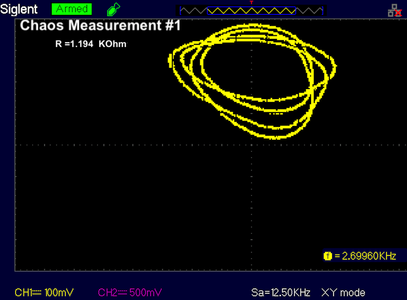

Chaos Measurement #1:
Resistance Value (R) = 1.194 KOhm
Horizontal Axis (V1) = 100 mV/div
Vertical Axis (V2) = 500 mV/div

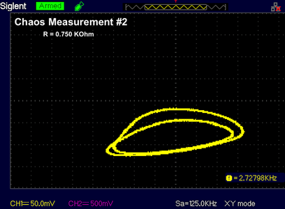

Chaos Measurement #2:
Resistance Value (R) = 0.750 KOhm
Horizontal Axis (V1) = 50 mV/div
Chaos Measurement #3:
Resistance Value (R) = 1.240 KOhm

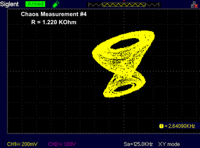

Chaos Measurement #4:
Resistance Value (R) = 1.220 KOhm
Horizontal Axis (V1) = 200 mV/div
Vertical Axis (V2) = 1.00 V/div
Observation & Discussion
The state-space representation of the circuit produced by the oscilloscope in X-Y mode allows analyzing the dynamical behaviour of the circuit by plotting the voltage across capacitor C1 on the X-axis and the voltage across capacitor C2 on the Y-axis. You can imagine a small point within the X-Y plot of the oscilloscope as the state of the circuit at an arbitrary time T. As time evolves, the collection of state measurements (points) gives rise to a geometrical representation where the state evolution of the system produce geometrical patterns. For example, from measurement #1 with a resistance value around 1.194 KOhm, we observe the state of the system orbiting around an equilibrium point through a total of four different orbits. The number of orbits increases as the resistance value across the potentiometers approaches the threshold required to induce chaos in the circuit, which is found to be around 1.220 KOhm. As observed in measurement #4, the system's state under chaotic behaviour can jump from positive orbits to negative orbits. Theoretically, a specific set of parameters values where the dynamical evolution of the state from one attractor to another becomes completely "random." Surprisingly, such chaotic property is useful for many applications such as cryptography. Further theoretical insights into the evolution of chaos in the Chua's Circuit can be found HERE & HERE.
The size difference between the two scroll attractors is due to input power asymmetry. Specifically, asymmetry arises when there is a small voltage difference between the batteries positive and negative input sources. For instance, the negative power provided by one battery might be 0.7 V less in magnitude than the positive input. Therefore, a power supply can be utilized to compensate for the power difference by applying 9V and -9.7V through the input of the operational amplifiers.
Additionally, the type of diode utilized in the circuit is critical for chaos to occur. A wide range of diodes led to the inability to observe any chaotic behaviour in the circuit. The 18mH 5% inductor from Fastron was found to allow the best results.
Vibrational Resonance Experiment:
1) Connect channel #1 of the signal generator into the input jack #1 of the circuit.
2) Connect channel #2 of the signal generator into the input jack #2 of the circuit.
3) Connect channel #1 of the oscilloscope into output #1 of the circuit, reporting the voltage across capacitor C1.
4) Connect channel #2 of the oscilloscope into output #2 of the circuit, reporting the voltage across capacitor C2.
5)Ensure to firmly mount the circuit to avoid any loose connections during the measurement process.
6) Connect the two 9V batteries to their respective battery jack.
7) Set the oscilloscope to time series more and briefly adjust the scale of each axis as well as the sampling rate until you can observe a clear sine wave for both channel #1 and channel #2.
8) For time series analysis, we want to measure one channel output at a time to maximize clarity. Therefore, turn off the channel #1 display on the oscilloscope.
9) Adjust the resistance value of the potentiometer to 1.350 KOhm.
*** To minimize the length of the project, only the effect of the amplitude (A2) of the high-frequency force (F2) will be explored. Also, only a time series analysis of the output signal will be presented. Adjusting the oscilloscope mode to FFT could allow exploring the frequency component of the output signal. Feel free to experiment with different input parameters and measurement methods.
Resonance Measurement [#1 - #8]
Resistance Value (R): R = 1.350 KOhm
Input Signal Parameters:
CH1 (Force #1) Amplitude = 0.3 V
CH1 (Force #1) Frequency = 50 Hz
CH2 (Force #2) Amplitude = [0.0 V - 3.5 V - 4.5 V - 5.5 V - 6.5 V - 7.5 V - 8.5 V ]
CH2 (Force #2) Frequency = 500 Hz
Observation & Discussion:
Once a threshold value of (A2) is reached, the system can jump from positive values to negative values. The time spent by the system in the positive and negative regions is referred to as the residence time (T+, T-). Taking all the residence times over a period of time allows us to calculate the mean residence time (Tmr+, Tmr-). In measurement number #3, the mean residence time between positive (T+) and negative (T-) differ drastically. The system is found to output negative values during a short period of time compared with the time spent in the positive region. As the input amplitude (A2) increases from 4.5 V in measurement #3 up to an amplitude (A2) of 8.5 V in measurement #8, the difference between the positive mean residence time (Tmr+) and the negative mean residence time (Tmr-) is found to decrease. For a specific threshold value of amplitude (A2_max), the mean residence time between positive and negative values becomes equal. Further analysis could demonstrate that the periodic switching from positive region to negative region at amplitude value equal to (A2_max) occurs with a period equal to half the period of the low-frequency input (f1). It is at such an input threshold that vibrational resonance occurs. Given the parameters selected for the experiment, A2_max is found to be around 8.5V. The relatively high voltage threshold compared with the results obtained during the simulation is likely due to the resistance value (R) set at 1.350 KOhm during the experiment. Furthermore, an amplitude response analysis could have been calculated to find the specific value of A2_max for a range of values close to 8.5V.
