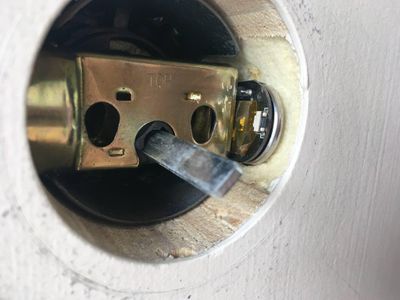

Step 2: Install Magnet
Install magnet at the tail end of deadbolt. I was going to epoxy it in place, but it works fine just held magnetically.
The magnet moves around a little when operating the lock, but it doesn't get out of position.

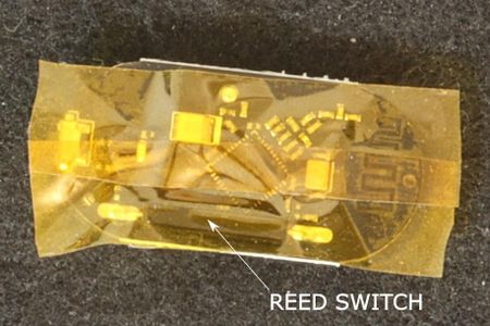

Step 3: Install Zigbee Sensor
Tape up sensor so it doesn't short to the deadbolt mechanism.
Insert board at end of deadbolt so the magnet is next to the reed switch.
This fit fine on two of my doors. One of my doors required me to relocate the battery with a coin cell holder.
This worked with my Schlage deadbolts. But there are a lot of different mechanisms, so you will have to open up your deadbolt to see if it will work for you.
Step 4: April 2022 Update
Originally I moved the battery to fit one of the locks, but it didn't work very well. I think it was not aligned properly with the magnet. To fix this, I replaced the battery and moved the reed switch instead (using blue wires in picture). This seems to work much better.
