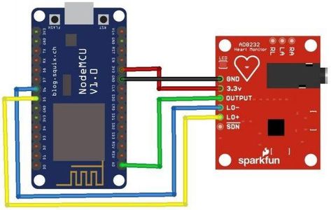

Step 3: Circuit Diagram of IoT Based ECG and Heart Monitoring
Here is a circuit digram for Interfacing AD8232 ECG Sensor with NodeMCU ESP8266. There are 6 pins in AD8232 Breakout Board. SDN is not connected.
Circuit Diagram Of IoT Based ECG and heart Monitoring
Connect the OUTPUT to analog A0 of Nodemcu. Connect the LO+ & LO- to D5 & D6 of NodeMCU respectively. Supply the AD8232 kit with 3.3V VCC & Connect its GND to GND.
