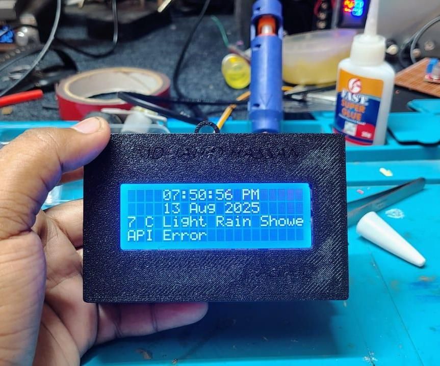

Create a Telegram Bot
  1. Open the Telegram app and search for the "BotFather" bot.     @BotFather
  2. Start a chat with BotFather and follow the instructions to create a new bot.
  3. Once the bot is created, BotFather will provide you with a Bot Token. Make sure to save this token as you'll need it later. Find your Chat ID:
  4. Search for the "IDBot" bot on Telegram.             @myidbot
  5. Start a chat with IDBot and follow the instructions to obtain your Chat ID.
  6. Make a note of your Chat ID as you'll need it in the code.
Step 5: Blynk Configuration.
Step 6: In Real Life
Out of consideration for privacy and security, I have refrained from disclosing email, Telegram SMS, and other information containing photos in this context.
