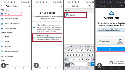

Step 13: Setup the Google Home App
First, download and install the Google Home App. then follow the steps to create Home in Google Home app
  1. Tap on the "+" icon (upper left corner).
  2. Tap on Create new home.
  3. Enter the Home nickname and address.
  4. Then click on Continue.
The Home is created. Now again tap on the "+" icon to add devices.
