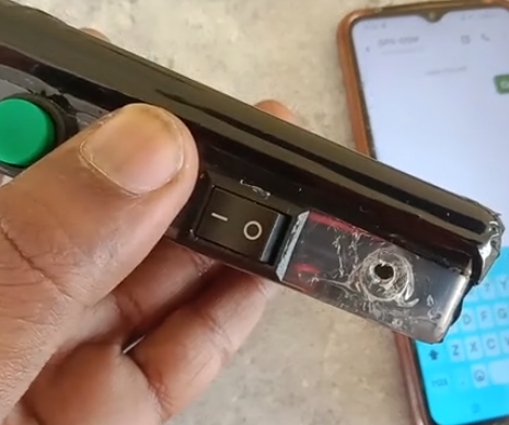

In this project, we will control a P10 LED display using an Arduino Nano and an ESP8266 module. The text displayed on the P10 module is sent via a Telegram bot, making it easy to update remotely. The ESP8266 receives messages from Telegram, forwards them to the Arduino Nano via serial communication, and the Nano then displays the text on the P10 module. The text will scroll automatically for better visibility.

Step 1: Circuit Diagram & Connections:
ESP8266 to Arduino Nano:
  1. ESP8266 TX → Arduino Nano RX (Pin 0)
  2. ESP8266 GND → Arduino Nano GND
  3. ESP8266 VCC → 3.3V Power Supply
  4. ESP8266 CH_PD → 3.3V (Enable Pin)
P10 Display to Arduino Nano:
  1. P10 Module CLK → Arduino Nano Pin X
  2. P10 Module DATA → Arduino Nano Pin Y
  3. P10 Module OE → Arduino Nano Pin Z
  4. P10 Module A/B → Arduino Nano Pin W
  5. P10 Module GND → Common GND
