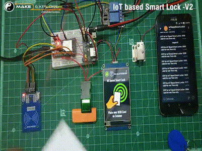

In this project we've built IoT based smart lock which have 4 layers of access. RFID + PIN + Fingerprint + OTP. We have slightly upgraded our previous version of the project. In this version we are going to add one more accessibility layer. That is biometric, means, we've added fingerprint based authentication.
  • Also we are going to use different MCU development Board. In version 1 we have used Particle Photon Board, but in this project we will use ESP32 development board.
  • So now, if user want to unlock this lock, then he or she should have Valid RFID, Fingerprint, PIN and OTP, means one time password.
  • Also we have programmed this lock system to keep record data of user entries with user name and timestamp. This data will recorded on our dedicated mySQL database which is hosted on our webserver, hence the system Administrator can login to that web portal and, keep track of how many time this lock got opened.
  • NextionTouchscreen HMI Display is used for interacting with this door lock.

Step 1: ESP32 and MFRC522 RFID Interfacing
Connect the components as shown in circuit diagram.
  • Then install the latest Arduino IDE (if previously not install on your system)
  • Install ESP32 Board core into an Arduino IDE - Video Tutorial
  • Install MFRC522 library from Arduino IDE library manager
  • use Dumpinfo sample code from library to check the working of interfacing
  • In code, make sure to change the SS and RST pins as
#define SS_PIN 21 // SDA/SS Pin of RFID Reader
#define RST_PIN 22  // RESET Pin of RFID Reader
Using this example (Dumpinfo), get the UID's of RFID cards/Tags. Note them down. We'll require those to add authorized users in final code.
Step 2: ESP32 and Fingerprint Sensor Interfacing
  • Install Adafruit-Fingerprint-Sensor-Library from Arduino IDE library manager
  • use enrollsample sketch from library to check the working of interfacing
  • Use this sketch to enroll correct authorized fingers data in Sensors memory.
  • It is recommended to enroll at least 4-5 templates (of one finger) for each user.
  • Also keep note of each users template numbers(Finger ID's). We'll require those to add authorized users in final code.
