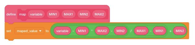

As we will change the time using Potentiometers.
We will be creating a Map Function Block for the same. This function will map the value given by potentiometer 1 to 0 to 23 for hours and the value of potentiometer 2 to 0 to 59 for minutes.
We will slide the slide switch upwards to change the time and slide the slide switch to the centre to save the changed time.

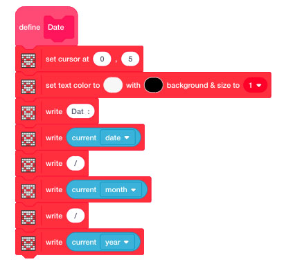

Step 3: Displaying All the Data on the TFT Screen
We will now display the real-time weather report of the given location on the TFT Display of the evive.
The content displayed will be:
- Name of the city
- Time
- Temperature
- Humidity
- Wind Speed
- Visibility
Notes:You can display other details as well on the Screen.
Write the given code for the same.
