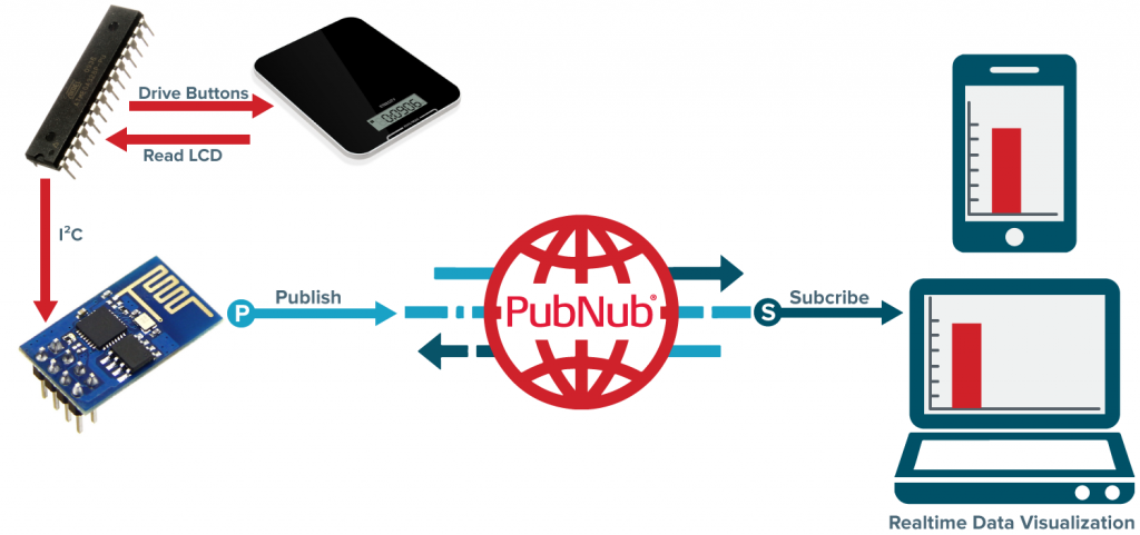

Step 2: Project Overview
Taking a step back, the whole project works like this. The digital scale collects measurements and displays information on its LCD screen. That data is read directly by an ATmega328p and then sent to the ESP8266 on the I2C bus. From there, it is published on the internet to any user subscribed to the channel via PubNub.
There are a lot of moving parts here, so let's figure out everything that needs to be created:
- Digital Scale should read weight of coffee pot
- Circuitry to get the weight read by digital scale
- Internet connectivity to publish weight data using PubNub
- Web interface to display that information to anyone

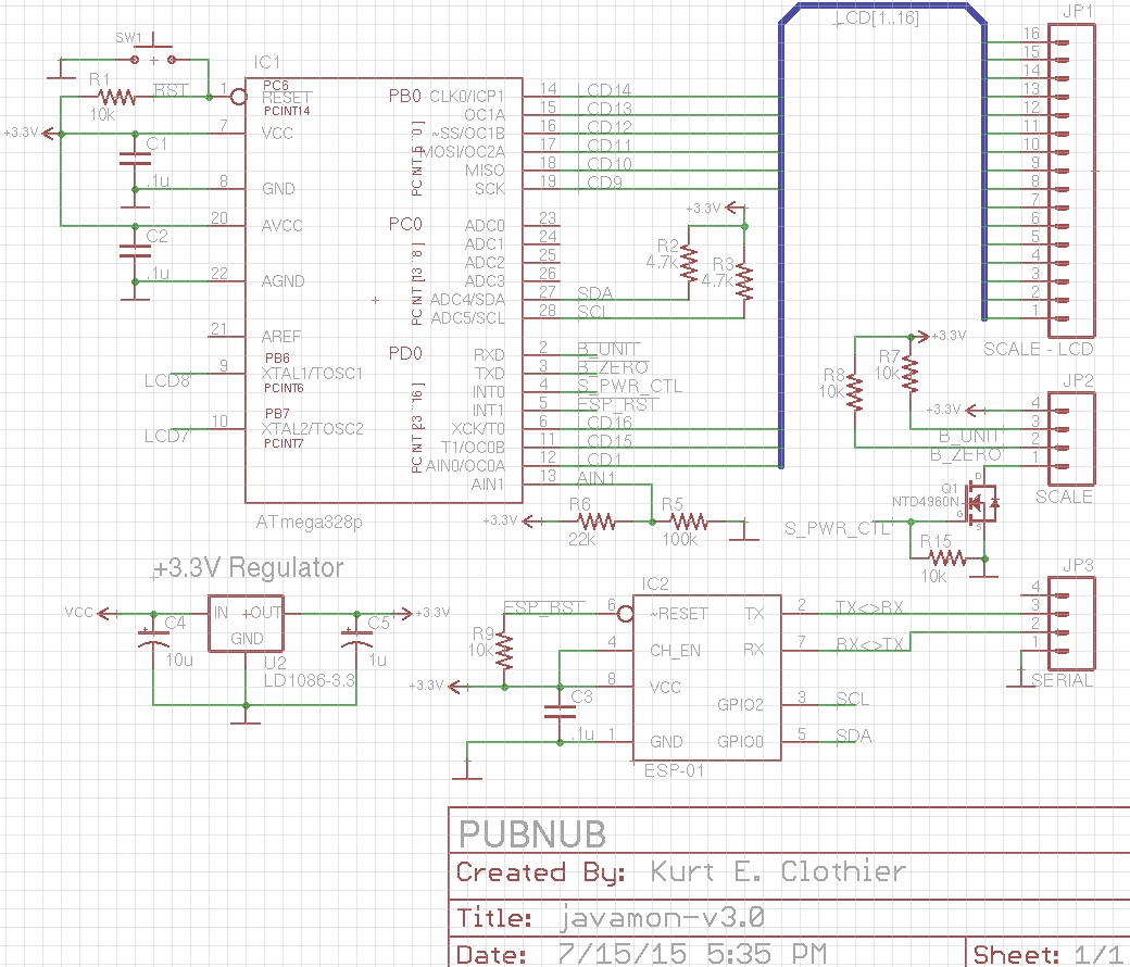

Step 4: Circuit Design
There are a few additions to the circuit used in the companion Instructable. Namely, the addition of the ESP8266, I2C bus, and some new abilities. The ATmega328p has complete control over the scale. It directly drives the active low mode buttons, reads the LCD screen, and can even disable power to the scale using a transistor. This chip also communicates with the ESP8266 via the I2C bus (also known as TWI).
In addition, the mega328 is responsible for resetting the ESP8266 if it requests such an event due to network issues or some other error state. The ESP8266 has the job of publishing our scale data to the internet using PubNub. Take note, this entire circuit is operating at 3.3V DC!
There isn't too much else going on in this circuit. I think it should be pretty straight forward to anyone who can read a schematic. Again, I can't stress enough that this circuit runs on 3.3V DC. The ATmega328p has a pretty wide input voltage range, but the ESP8266 and scale do not. The open pins on PORTC can be used for additional analog sensors. The most obvious choice would be a temperature sensor, but this would require a probe to go down into the coffee for the pot in our office, and that would most likely go unused.

The firmware for this chip can be found in the atmega328p directory of the source code repository. This code is written in C, should be compiled using AVR-GCC, and can be flashed to the chip using Atmel Studio or AVRDUDE and an external AVR programmer. This is NOT Arduino code. There are a few changes to the code used in the LCD Reader Instructable, so I will briefly touch on those points.
On boot, the following actions will take place:
- Initialize I/O pins and hardware peripherals
- Enable the ESP8266
- Enable the scale, ensure in weight mode with grams as the unit
- Enable I2C bus
- Enter Main Loop
The main loop does the following things about once per second:
- Read the LCD
- Decode the LCD data into a weight in grams
- Reset the ESP8266, if requested
- Keep the scale awake (every 45 seconds)
To keep the scale awake, the unit button is pressed a couple of times. Otherwise, the scale enters a clock display mode that cannot be easily exited. Although this chip is the main controller, it acts as a slave on the I2C bus. This was done primarily because the ESP8266 module in use does not have access to the actual I2C hardware pins, and a “bit-bang” master is much easier to implement than a slave.
When an I2C Read is initiated, the scale digits are transmitted on the bus. The first byte represents the upper two digits, while the second byte represents the lower two digits. For example, a weight of 1234 grams would be sent as [12] [34]. As the mega328 is never expecting an I2C write, such an event signals a reset request by the ESP8266. At this time, the mega328 will pull the reset line of the ESP8266 low for a few milliseconds and then release it. This is used as a rudimentary way to overcome error states in the ESP8266.

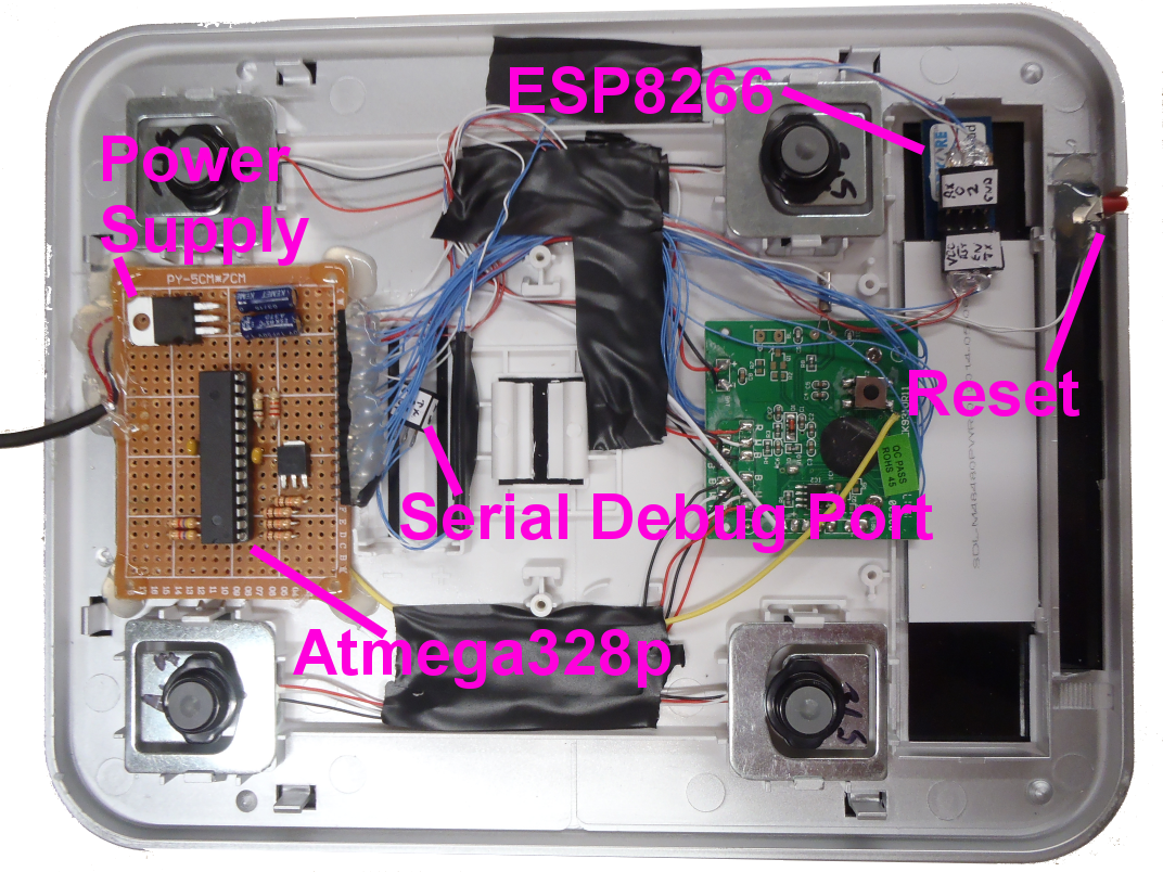

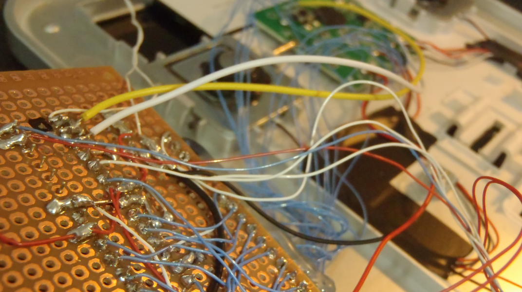

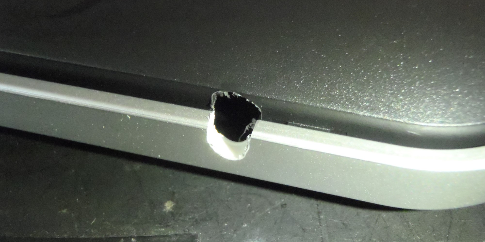

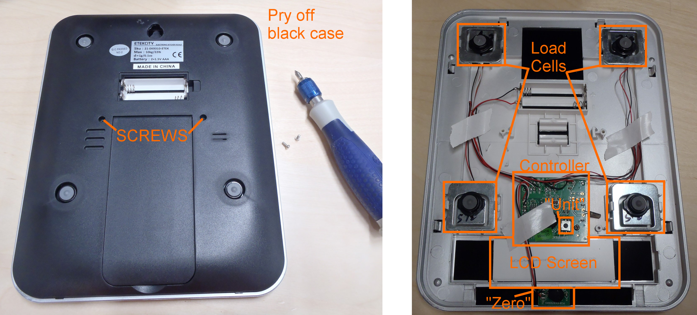

With the circuit designed and firmware loaded, it's time to build the final product! The scale is pretty thin, but with some clever placement we can fit all of the new components into the original casing so it looks nice. The first step is to cut a small hole in the front of the scale for a reset button. This allows a user to reset the scale if it is acting strange...
I elected to hand solder everything onto a small perf board, but a custom PCB with surface mount components would be a better option.
If you recall from the LCD Reader Instructable, there is a lot of empty space available inside of the scale, just not a lot of vertical room.
After dremeling out the battery compartment plastic, the soldered circuit fit perfectly near the back of the scale, with wires running forward to the LCD screen and the ESP8266. The WiFi module should be placed as far forward as possible - less RF signal interference from the coffee pot!
It is really important that the scale is supported only by the four load cells - this is how it works! If any weight is supported by the circuitry or any other parts we added, the scale will not be accurate. I actually had to cut a small hole in the bottom case to make clearance for the top of the ATmega328p - another reason surface mount parts on a PCB would be better.

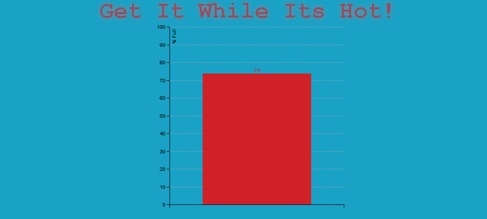

All of this streaming data is useless without a way to access it, so I built a really simple web page that displays the coffee pot level using EON, a PubNub JavaScript framework for IoT dashboards. The webpage utilizes HTML, CSS for styling, and JavaScript to handle the PubNub interactions. The full source code can be found in the gh-pages branch of the project repository.
The first step is to initialize PubNub and create an EON chart.
var pubnub = PUBNUB.init({ publish_key: 'YOUR_PUBLISH_KEY', subscribe_key: 'YOUR_SUBSCRIBE_KEY' }); var channel = "javamon"; eon.chart({ pubnub:pubnub, channel: channel, message: function(m){ // Do cool stuff here! });
The chart will then update with any new data published by the scale on the selected channel. The interface is also responsible for translating the raw weight into a percentage level from 0 to 100. At first, I was doing this in the scale itself, but a change in the coffee pot would require a firmware update with new conversion factors. Putting this calculation in the JavaScript means a couple of variable updates to the accessible web page code will take care of it.
In addition, the interface will alert users if either the pot is off of the scale or some unknown object is on the scale. This is done by comparing the scale weight to the known weight of the empty coffee pot.
There was a major flaw in my original design - it was possible for the webpage to take up to two minutes before displaying any data as it waited on a publish event to take place. This was solved with the addition of PubNub Storage and Playback. This feature allowed me to look at the history of messages published to my channel in order to populate the graph before any new publish events took place. I am only looking at messages published in the last five minutes, and if none are found, then scale is in an error state. JavaMon is live in the PubNub office right now - check out the web page!
