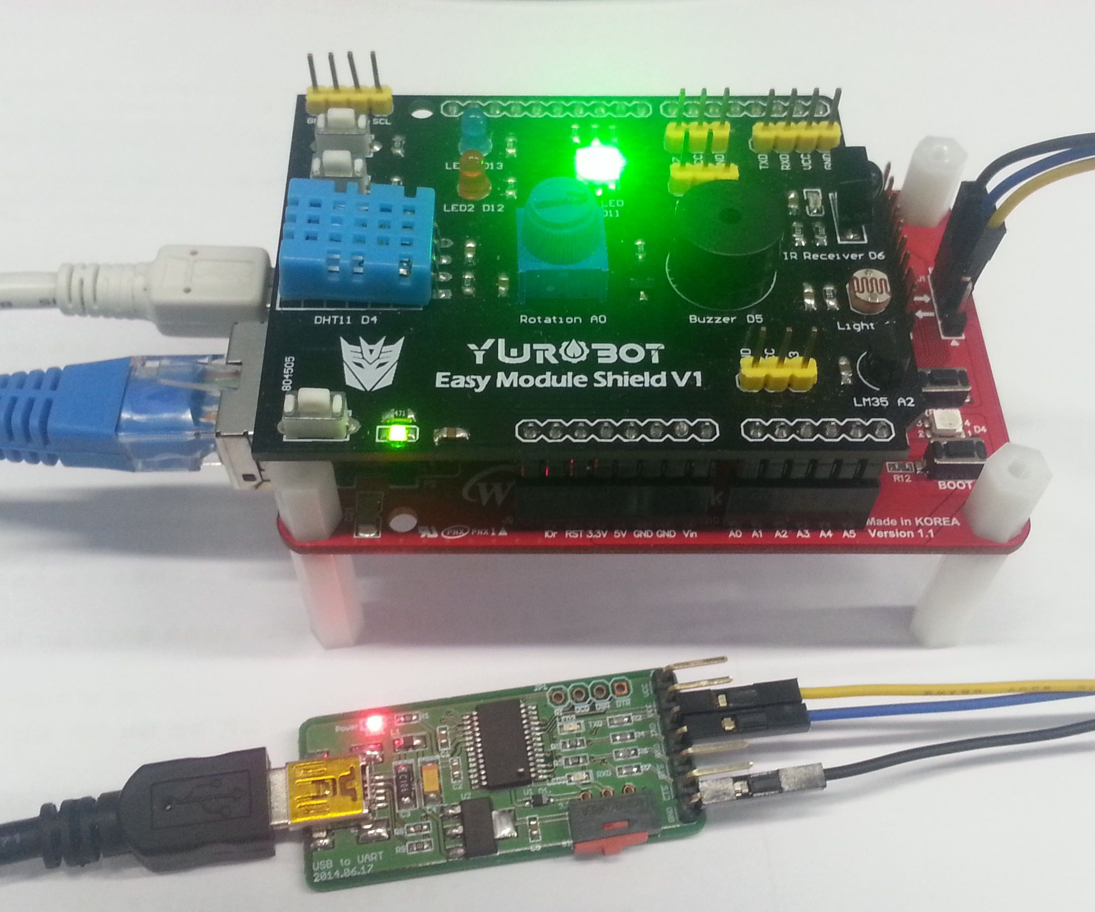

Step 2: Hardware Connection
Please connect an USB, LAN cable and UART2USB adapter
