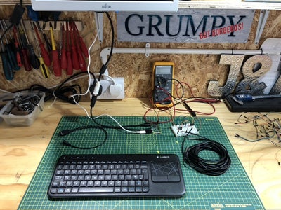

I already had a Raspberry Pi Zero W (with wireless) but I am sure this simple project will run fine on any of the RPIs. The box of odd electronic bits in my workshop had everything else (breadboard, wire, PSU etc) and so all I had to buy was two 2 x DS18B20 sensors from Amazon. These are the normal DS18B20 chips just conveniently mounted in a waterproof housing and 3m cable. There are 3 wires from the cable:
  • Red – power – connect to the 3.3v pin 1
  • Black – return – connect to the ground pin 6
  • Yellow – data – connect to the GPIO4 pin 7

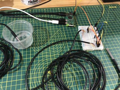

The sensors use the 1-Wire interface and were very easy to connect-up and obtain data from. There are several pages on the Web with details for connection of 1 device but very little on connecting 2 (or more).

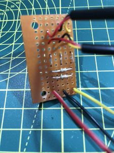

For testing on the bench, the circuit was assembled using a breadboard. The tutorials I found stated to use a 4K7 resistor to bias the data line, but I could not find one & so used 2* 10K in parallel & it worked just fine. There are plenty of resources on the Web for using a breadboard to assemble RPi circuits and so I will not repeat them here.
Diagram created using Circuit Diagram https://www.circuit-diagram.org/editor/

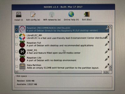

As I had used this RPi before, I decided to start with a clean installation of the OS, I reformatted the SD card and installed a clean version of NOOBS. I then installed the full desktop version of Raspian (the top option) as this would also install PIP & GIT that the lite version does not. Even though I didn’t need the Graphical User Interface (GUI) for the project, it is an easy way to setup all the options and with a 16gb SD card there was no shortage of space.

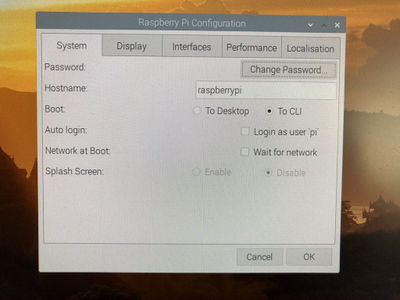

I set up WI-FI access then ran the full install & then the wizard with updates & upgrades etc. Using the GUI, I setup the RPI as needed just because using the GUI is simpler than the Command Line Interface (CLI). I went to the configuration window from the menu and then:

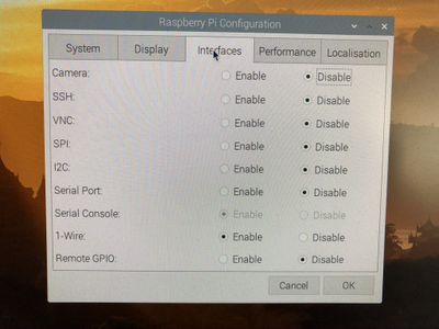

  • On the system tab, I changed the password, set to boot to CLI and unchecked Auto Login
  • On the interfaces tab, I enabled 1-wire
  • Clicked ok & re-booted
If you need to get back to the GUI at any time just type startx at the CLI

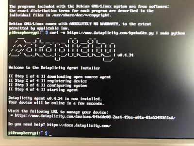

Step 3: Setup Dataplicity to Allow Remote Access
I found a really helpful blog entry on the Dataplicity site at https://blog.dataplicity.com/how-to-build-a-raspb... and used a few parts of this. Section 3 of the blog describes setting up Dataplicity for remote access to the RPi. I have never used Dataplicity before, but have to say, I thoroughly recommend it as a very simple remote access tool. Although the screenshots (in the blog above) are a little out of date, the principle is fine.
On your PC, go to Dataplicity.com and create an account (you could use the browser in the GUI, but rather slow on the RPi Zero). Then click the “add new device” button and a line of code is displayed in the pop-up window. Then go to the CLI on the RPi and type in the line of text. If all is okay, the Dataplicity logo will display and the install program will run.
Back on your PC, the new device should now appear on the Dataplicity website. Click the device and you should see a terminal screen for your RPi.
There are a few things to note here:
  • To log in, type "su pi" (for superuser access) and you will be prompted for the password (as set earlier)
  • You need to enable Wormhole (to be used later)
  • You will need the Wormhole address for displaying the data later (right-click to copy when needed)
You can use this remote access for all the following steps and is much easier for copying data, programs etc than directly on the RPi.

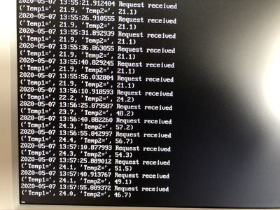

To run the test program:
sudo python3 thermo-test.py
All being well, this should execute the file using python 3 and print to the screen the 2 temperatures every 10 secs. You can test all is ok by placing 1 sensor into iced water or gently warming with a hairdryer. If all seems okay, then we can move on!

The data should now be displayed on the 2 gauges and if you still have the PRi connected to a monitor, you should see the requests from Freeboard.io as they arrive.

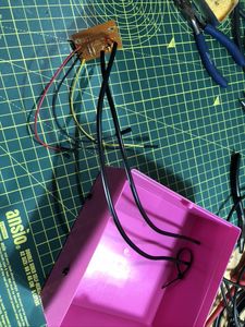

Step 11: Build the Project Into a Box

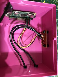

Up until this point, the RPi and the other components had all been assembled on the bench using a breadboard. A small piece of stripboard was then used to replace the breadboard and the leads all soldered into place.

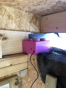

A bright pink small Lego storage box was found that had plenty of space and where the RPI would not get too hot. holes were drilled into the sides of the box & 3mm nylon mounting pillars were used to hold the RPi and stripboard into place.
There are only 3 connections required from the GPIO, 3.3v, GND & data.
  • 3.3vdc pin 1
  • GND pin 6
  • Data (GPIO4) pin 7
Holes were also added in the box for USB power and cables to the temperature sensors. Once everything was mounted into place, a small amount to silicone sealant was added to ensure spiders didn't think it was a nice warm place to spend the winter!
Step 12: Finished
The box was placed into the greenhouse and powered from a USB charger. The two sensors were placed one near the top of the greenhouse and the other onto a plant pot to check how cold the seedlings were getting at night.
