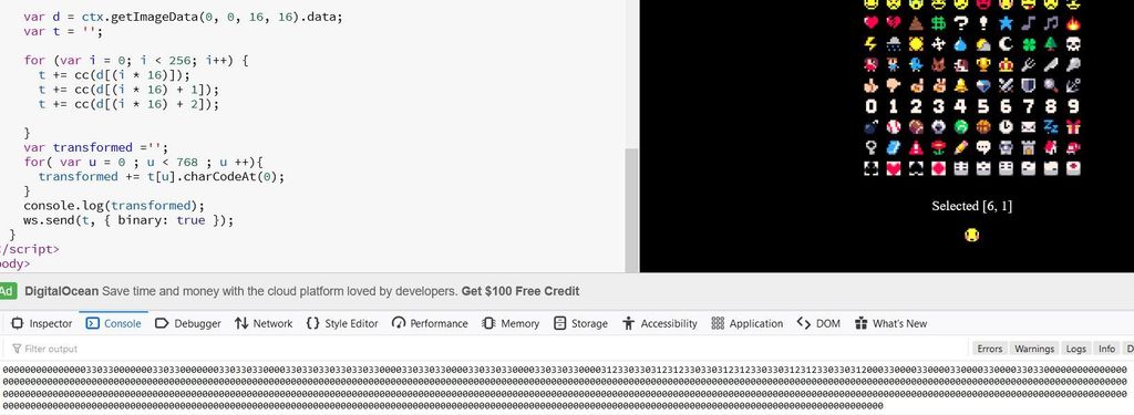

Then I resized the image and use base64decode.org convert to an base64 encoded string to embed it into the HTML.
You may find the resized image at: src/emojis.png
Step 6: Simple HTML UI
I have scripted a very simple HTML for selecting the emoji and then transfer the pixels to ESP8266 by Web Socket protocol in binary format.
Then I use html-minifier convert to a long single line string to embed it into Arduino code.
You may find the HTML file at: src/index.html
