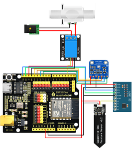

Step 1: Schematic and Flow Chart
I have also included a flow chart to help explain the logistics behind this syntax. Below are the connections for the circuit.
Bme280:
VIN - 5V
GND - GND
SCK - GPIO18
SDO/MOSI - GPIO19
SDI/MISO - GPIO23
CS - GPIO5
Moisture Sensor:
AOUT - A0(ADS115)
Relay:
S - GPIO26

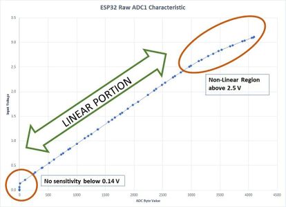

Step 2: ADS1115
You might be wondering why I've included "ADS1115" into this device. This IC plays an important role into this system, especially for ESP32 boards. Because the capacitive soil sensor relies on analog communication to ESP32 and the built-in ADC converter has a low resolution, where adding an external ADC converter would be vital. This device requires high resolution analog signals, as the soil moisture is being predicted from these analog readings. The above image demonstrates this principle. (Image Credit to W4krl.com)
Unlike ESP32's notorious 12bit ADC, the ADS1115, also known as 16Bit ADC, can convert analog to digital using the linear ratio (voltage vs ADC). The ADS already has a built-in 10K resistor pull-down to ground. So the address for ADS I2C is (0x48) by default. We do not need any wiring towards the ADDR pin.

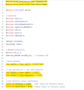

Step 4: Upload the Codes to ESP32
Change the highlighted credentials with your own information.
The code can be found here.
Note:
For the "Air Value" and "Water Value", please calibrate these values, as they differ from every moisture sensor.
Calibrate your Capacitve Soil Sensor with the following link:
