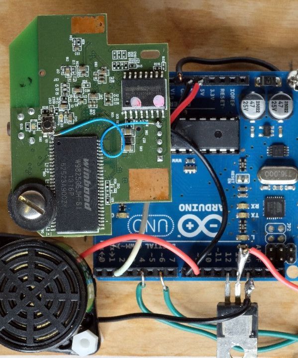

A year or so ago, I hacked a Belkin WeMo switch and coupled the WIFI board to an Arduino Uno along with a little code and sensors to create a way to control my garage door. The system worked well as I could not only control the door, but I could see the door's state in the WeMo App on my iPhone. The only problems were that the parts were fairly expensive ($50 for the WeMo and $20 for the Arduino + sensors) and the sensors (magnetic reed relay or hall effect) were difficult to install reliably in the garage.
So I set out to simplify the design. I wanted to reduce the price and also make the installation something a typical homeowner might be able to do.
The new design uses an internet development chip/system called the Particle Photon. The system is essentially an arduino type processor coupled to a WIFI chip on a single board the size of a couple of postage stamps. The Photon is just $20 compared to $70 for the first design.
(the image shows both the v1 and v2 systems on the same breadboard - v1 is on the right, v2 on the left)
But the real chore with the first system was installation. Mounting sensors for "door open" and "door closed" was a pain. Drilling, screw, mounting, running wires across the garage, etc. And the reliability of the reed sensors was not great as their tolerance for working properly was just a few millimeters.
So I looked into proximity sensors. I tried some ultrasonic ones but they were fairly expensive. They worked just fine but the price point was a bit high. I settled on an IR sensor made by Sharp. It runs about $14 from Sparkfun for a single unit which is not bad. So in total parts we are down to $34 and a much simpler design as the IR sensor can be co-located with the Photon CPU/WIFI chip cutting down on the garage wiring. And the IR sensor does not need anywhere near the same exacting alignment as the reed or hall effect sensors do.

The main system is comprised of the parts in blue in the diagram. The Photon and the IR Proximity Sensor. The proximity sensor gets power (5V and Ground) and its analog signal out goes to pin A0 on the Photon. The D0 output of the Photon is used to simulate a button press for your garage door motor. It connects to the base of the NPN transistor through a ~200 ohm resistor. The emitter is tied to ground along with one contact of the garage door actuator contacts. The collector is connected to the other garage door actuator contact and left to float until D0 goes high and drives the transistor on for 800ms pulling the collector to ground which simulates a button press to the garage door.
If you choose to implement a buzzer (a good idea for garage doors that move on their own!) then the buzzer is connected to ground (negative lead) and the positive lead is connected to D1 on the Photon.
Note: you could also add a bright LED that could flash on/off with the buzzer for situations where sound is not enough to warn people that the door is about to move. This may require another NPN transistor to drive a high power LED much like the U1 transistor drives the garage door contacts (similar circuit).
PS: The diagram seems to show lines going off the left edge. Don't worry about that. I had another system hooked up to this. And you can leave off the Diodes (D1 and D4) as they are not needed since we are building just one system here.
