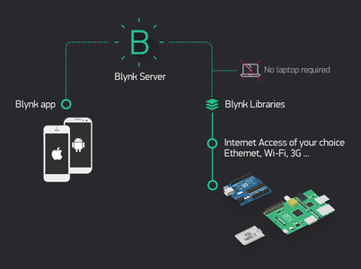

Node MCU- This is open-source firmware and development kit that helps you to prototype your IoT product. Node MCU always refers to the firmware rather than the associated development kits. Both the firmware and prototyping board designs are open source. Low cost.
Blynk App- One app to prototype, deploy, and remotely manage connected electronic devices at any scale. Available in both iOS and Android to control Arduino, ESP8266, ESP32, Node MCU, and other microcomputers with smartphones over the Internet.

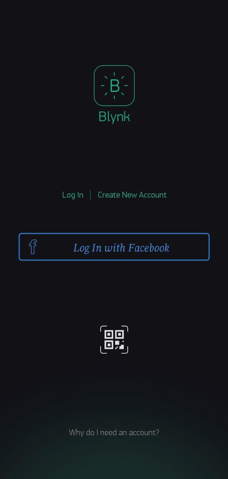

If you are a Beginner then, follow these steps:
1. Open Blynk app à Click Create New Account
2. Enter Mail Id and Set Password for Sign Up
3. Click New Project
4. Enter the project name and choose the device as ESP8266 then, click Create
5. Auth token can be received through your registered Mail Id Copy that or go to from Project Settings >> Auth Tokens >> Copy all

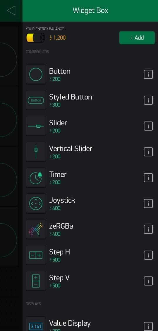

Design UI for Control in Blynk App
1. Open the “Widget Box” (‘+’)
2. Add Four Buttons
3. For all four Buttons, Name it and Select “Switch” Mode
4. Define the Output PIN as “Virtual V1”, “Virtual V2”, “Virtual V3”, “Virtual V4”, for “Switch 1”, “Switch 2”, “Switch 3”, “Switch 4”, respectively. If you want to change the output pin, then you want to change the Arduino code also

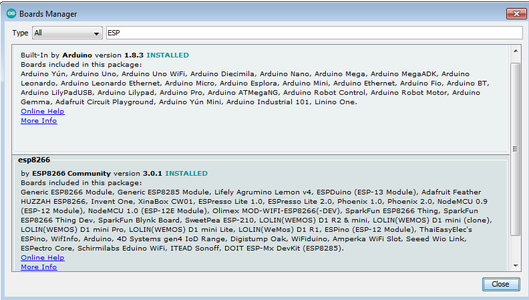

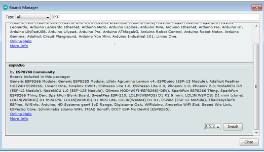

2. Open the “Tools” >> “Board” >> “Boards Manager”.
3. Search for “esp8266” and Install the latest version.
4. After installation makes sure that “INSTALLED” appears.
5. Select your board under “Tools" >> “Board” >> “ESP8266 Boards (2.7.4)” >> “NodeMCU 0.9 (ESP-12 Module)”
