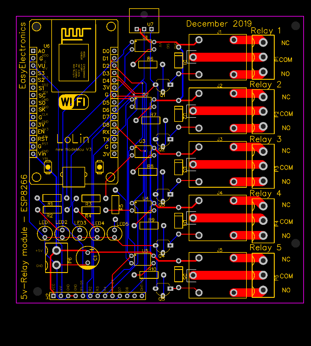

I have used EasyEda to design the 2-layer PCB.
It’s easy and fun to use and has the footprint libraries of most of the components. If anyone wants i can always post the gerber files for you.
Step 2: PCB Layout and Designing
Its a two layer PCB.
Signal traces are 0.3mm thick and Relay traces are 3 mm thick.
if you want you can increase the power trace size.

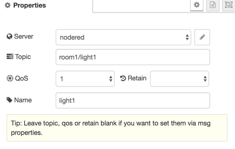

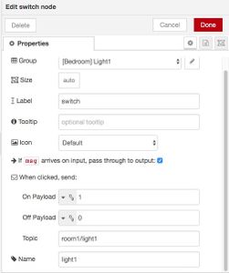

Step 5: Running NodeRED and Code
You need to install NodeRED and MQTT on a server to be run 24X7. I have installed both of them on my RaspberryPi.
The nodeRED workflow code in XML and Graphical workflow is attached for your reference.
prerequisites for NodeRED to work
1) dashboard UI
2) Home kit if using iphone

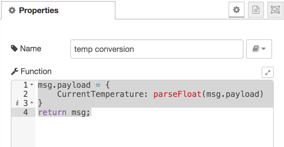

The humidity and temperature readings from the ESP8266 has to be converted to nodered syntax and I have included the screenshots for them.

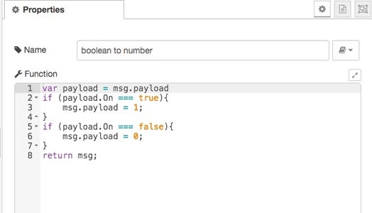

The homekit gives results in boolean and conversion to number is required and have included the code to get this done.
similarly to get proper results for temperature and humidity for homekit, the readings from DHT11 sensor is required to be processed before entering in the homekit, the code is included.

The PCB design is totally through hole and thus its easier to assemble at home using minimum tools.
Remember to use only red LEDs for indication as the Vf of other colours is different and thus the optocoupler will not work.
Take care regarding the ratings of the relays and electrical load you are putting on them, mine are rated for upto 2.5KW AC (250V @ 10A) which i highly doubt.
The input voltage should be 5V DC with minimum of 2 Amps capacity if you want to engage all 5 relays simultaneously.
