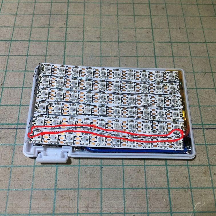

Step 8: Assembly LED Strip
Cut 6 LED strips with 10 SK6812 units each.
Stick all LED strips to the PET plastic plate to make it become a LED matrix.
Step 9: Soldering
LED Strip Matrix
- connect LED signal circuit in zigzag order from top left to bottom right
- connect LED strip Vcc altogether -> 3.3 V regulate board Vout
- connect LED strip GND altogether -> 3.3 V regulate board GND
ESP-12E Board
- RESET PIN (PIN 1), EN PIN (PIN 3), Vcc PIN (PIN 8) -> 3.3 V regulate board Vout
- GND PIN (PIN 15), GPIO15 (PIN 16) -> 3.3 V regulate board GND
- GPIO02 PIN -> LED strip DIN
- I have abused the micro USB connector D+ and D- PIN to Tx and Rx in case I need to debug
Lipo Charge Board
- Battery +ve -> Lipo battery +ve -> power switch -> 3.3 V regulate board Vin
- Battery -ve -> Lipo battery -ve -> 3.3 V regulate board GND
- Vin -> micro USB board 5V
- GND -> micro USB board GND
